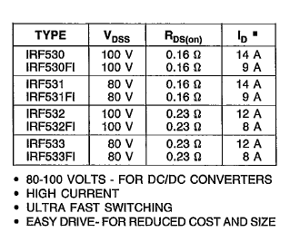

I'm thinking of building that amplifier (Application Note AN-948) but I can't find irf9532 and irf532 transistors here in Greece. Can I use irf9530 and irf530 instead? Should I change some components?
Re: About that AN-948
Yes, you should be able to use IRF530 IRF9530
Difference is VERY small. Basically same transistor.
If you download the very detailed app note:
http://www.irf.com/technical-info/appnotes/an-948.pdf
you will see they even talk about 530/9530 in the text
(I think you should even be able to use IRF540/9540)
