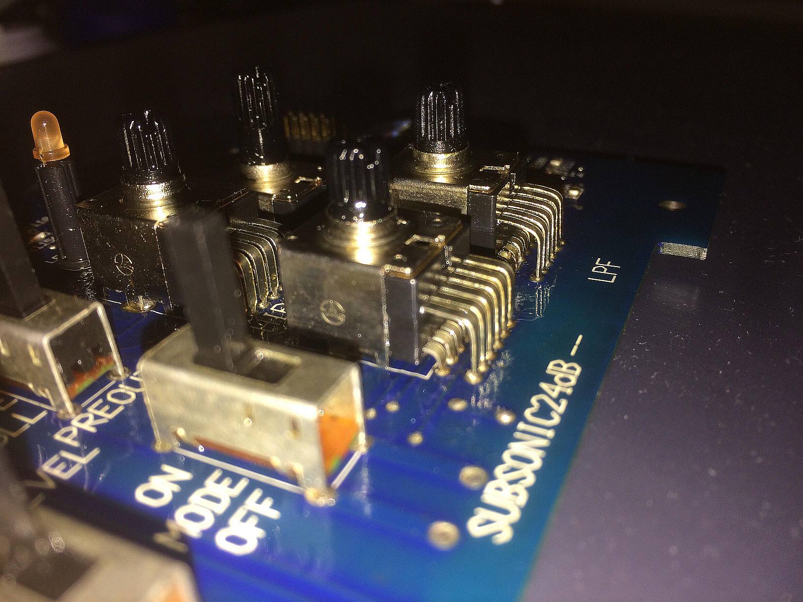

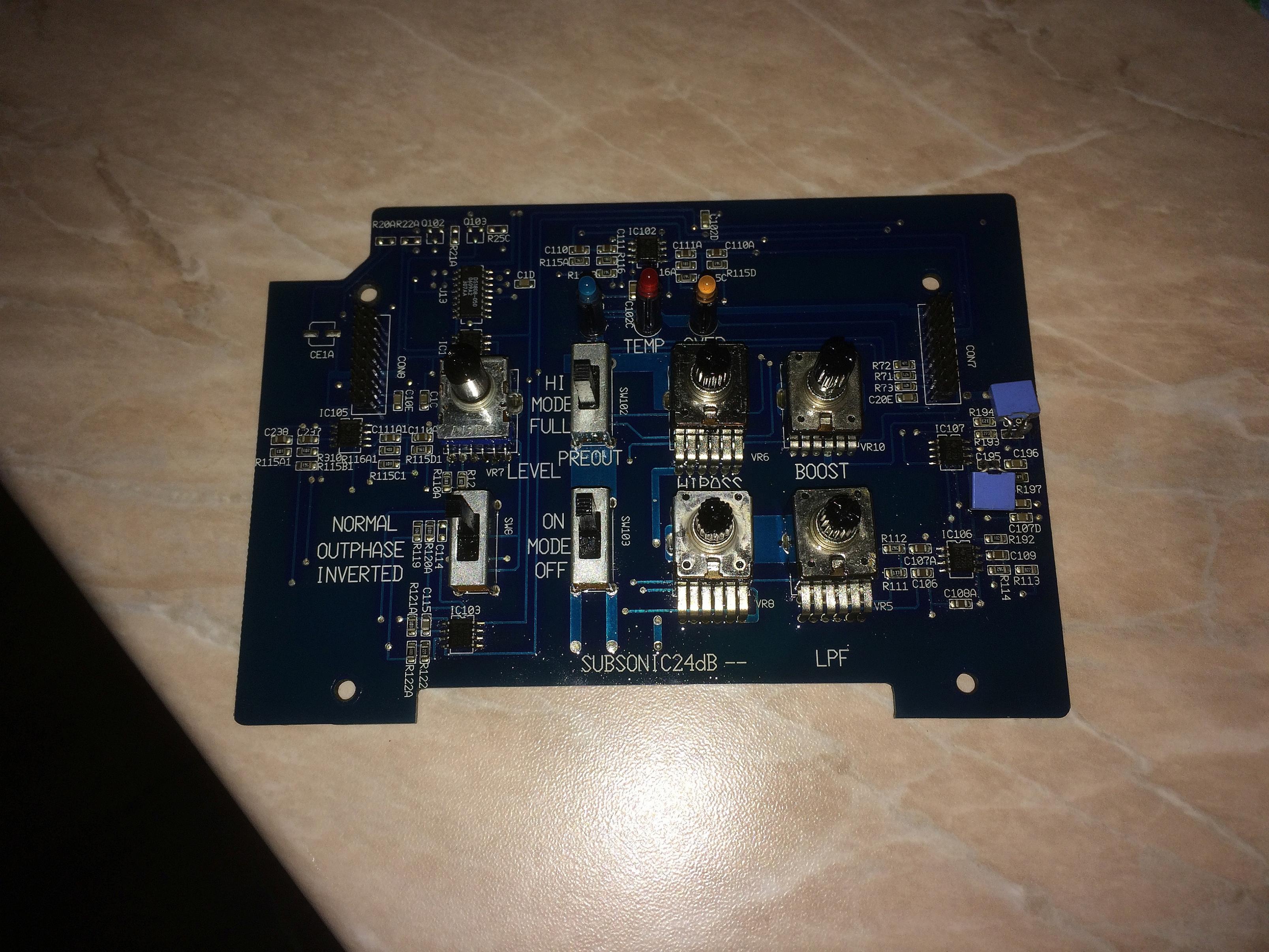

Pre amp board, subsonic potentiometer is beyond repair. It has been cleaned up with contact cleaner and reflowed with new solder properly but with no success. If I press the plastic pole inwards really, really hard signal shows up. If there is no pressure applied, signal goes away. Amps work just fine with subsonic switch off, but i want to fix it.
I still can't find 2x6 pin configuration potentiometer as this one. It's VR8 a 100k value. All of the potentiometer are being marked as ALPS.

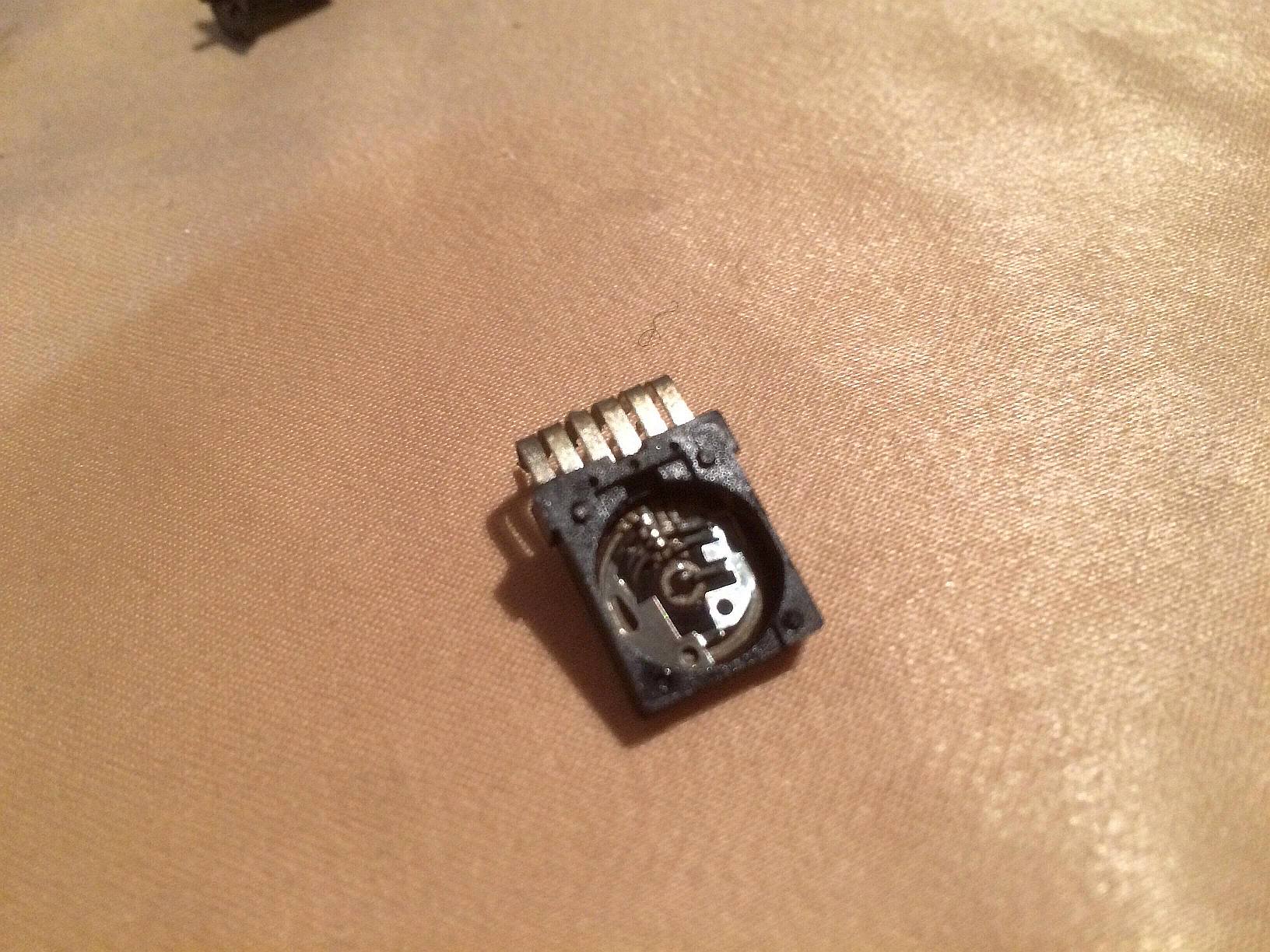

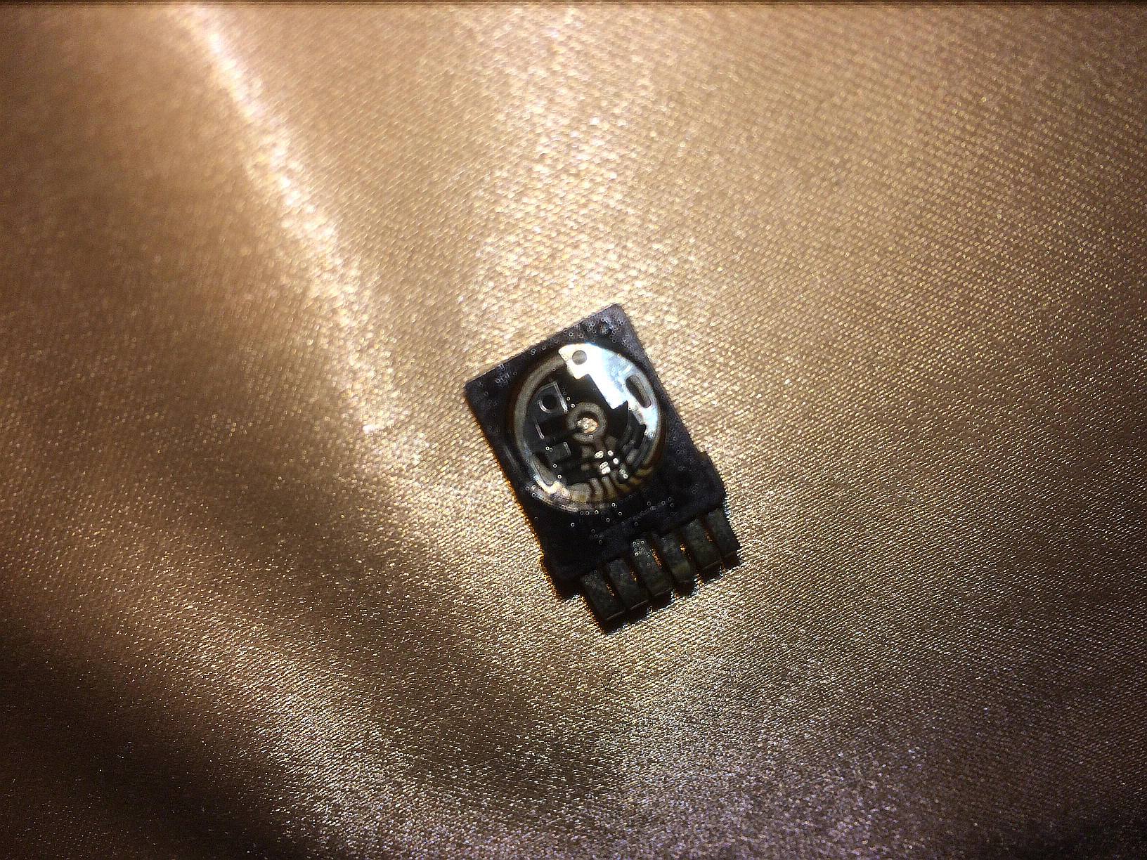

Okay, I've disassembled it but i feel like there is a missing part or something is broken. Shouldn't this metal plates be one whole piece ? How do they connect to each another ?
This is my first potentiometer of that type i've taken apart, so 😕

The plastic "caps" holding the metal pieces on the pot were gone, they have been broken at some point...that make sense why they just fell of after I disassembled the potentiometer.
I don't have any like this from all of the salvage boards I've laying around. Any idea where I can buy new one ?
