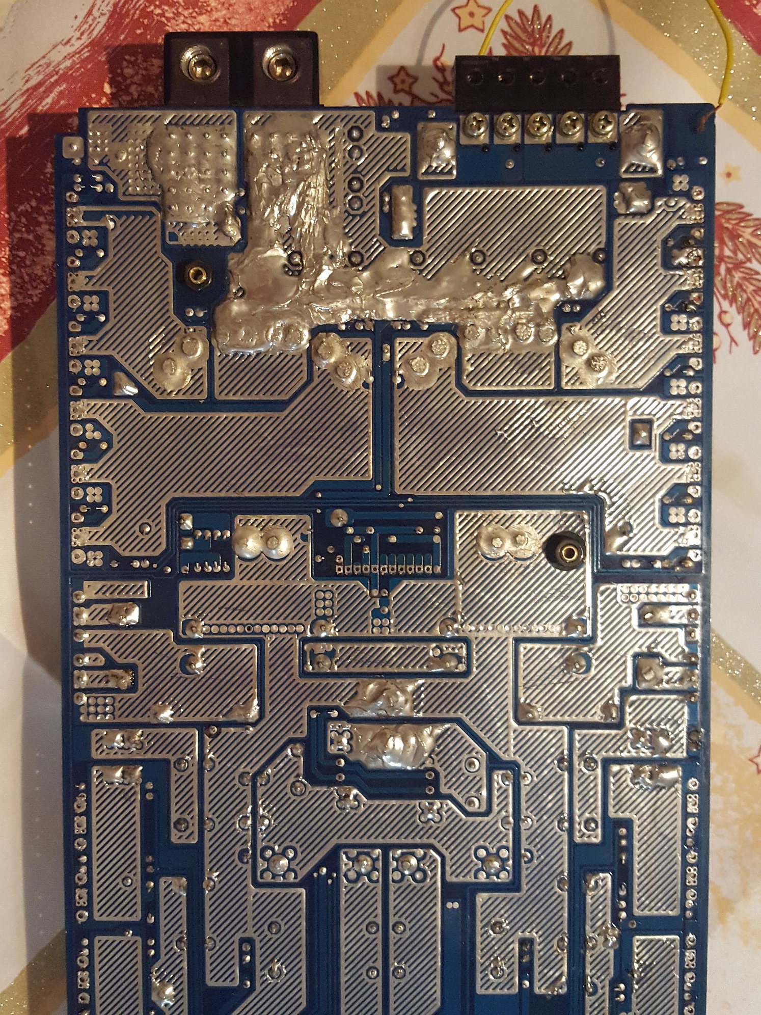

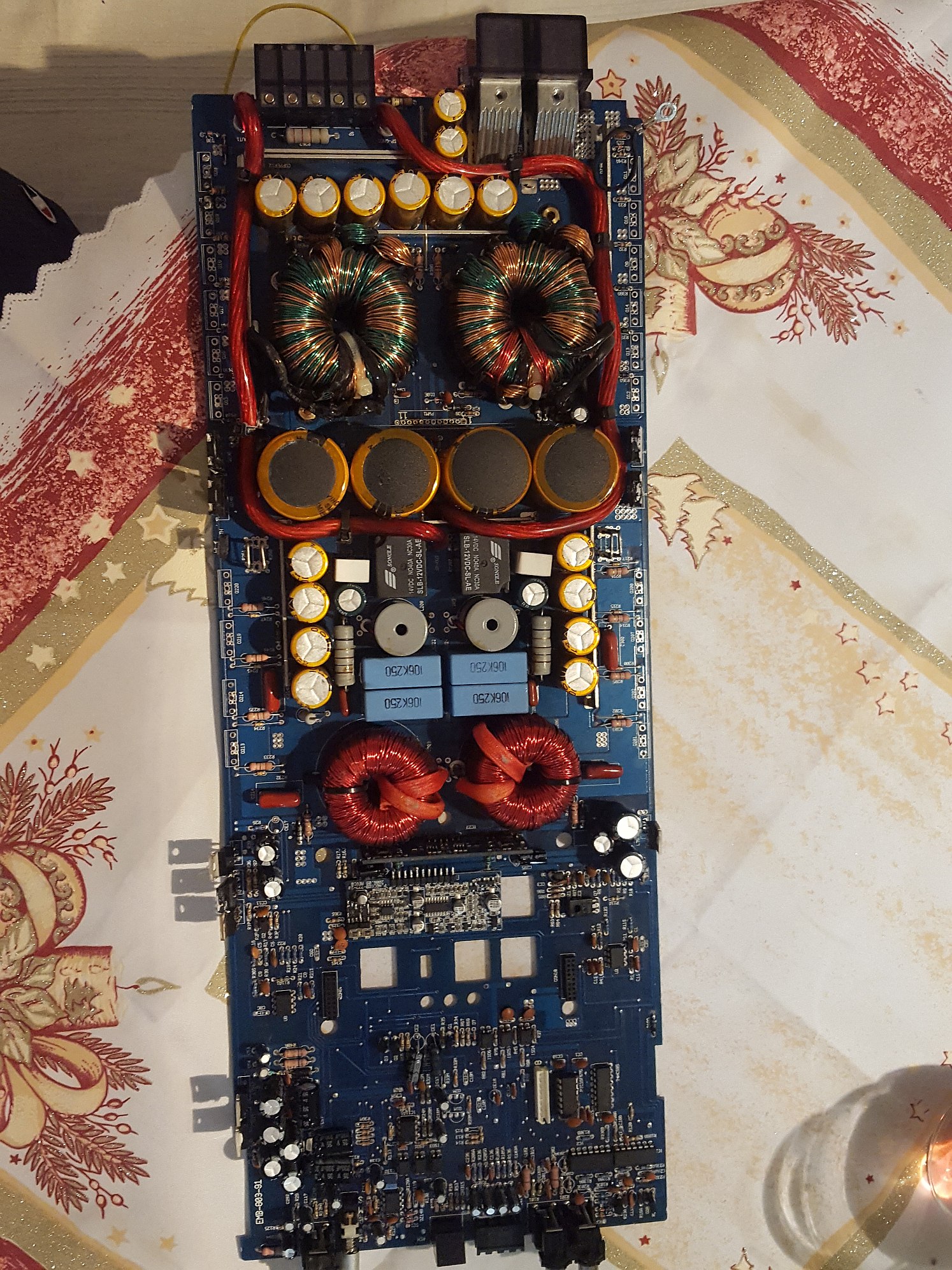

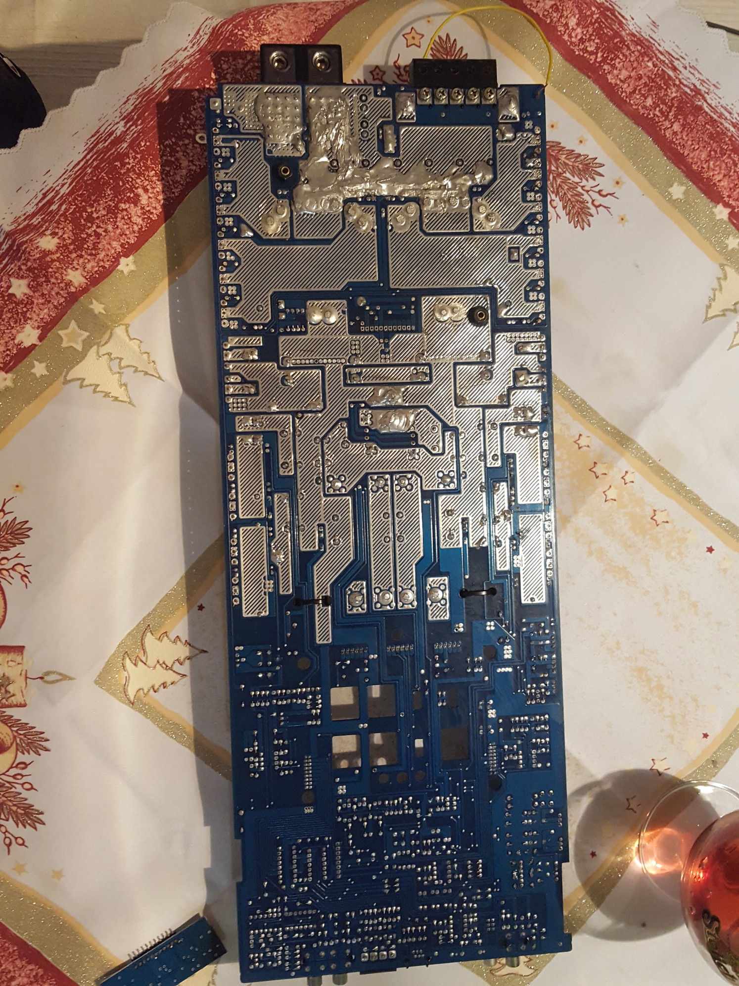

Amp is working now but there are more issues to solve.
Pre amp board, subsonic potentiometer is beyond repair. It has been cleaned up with contact cleaner and reflowed with new solder properly but with no success. If I press the plastic pole inwards really, really hard signal shows up. If there is no pressure applied, signal goes away. Amps work just fine with subsonic switch off, but i want to fix it.
I still can't find 2x6 pin configuration potentiometer as this one. It's VR8 a 100k value. All of the potentiometer are being marked as ALPS.
