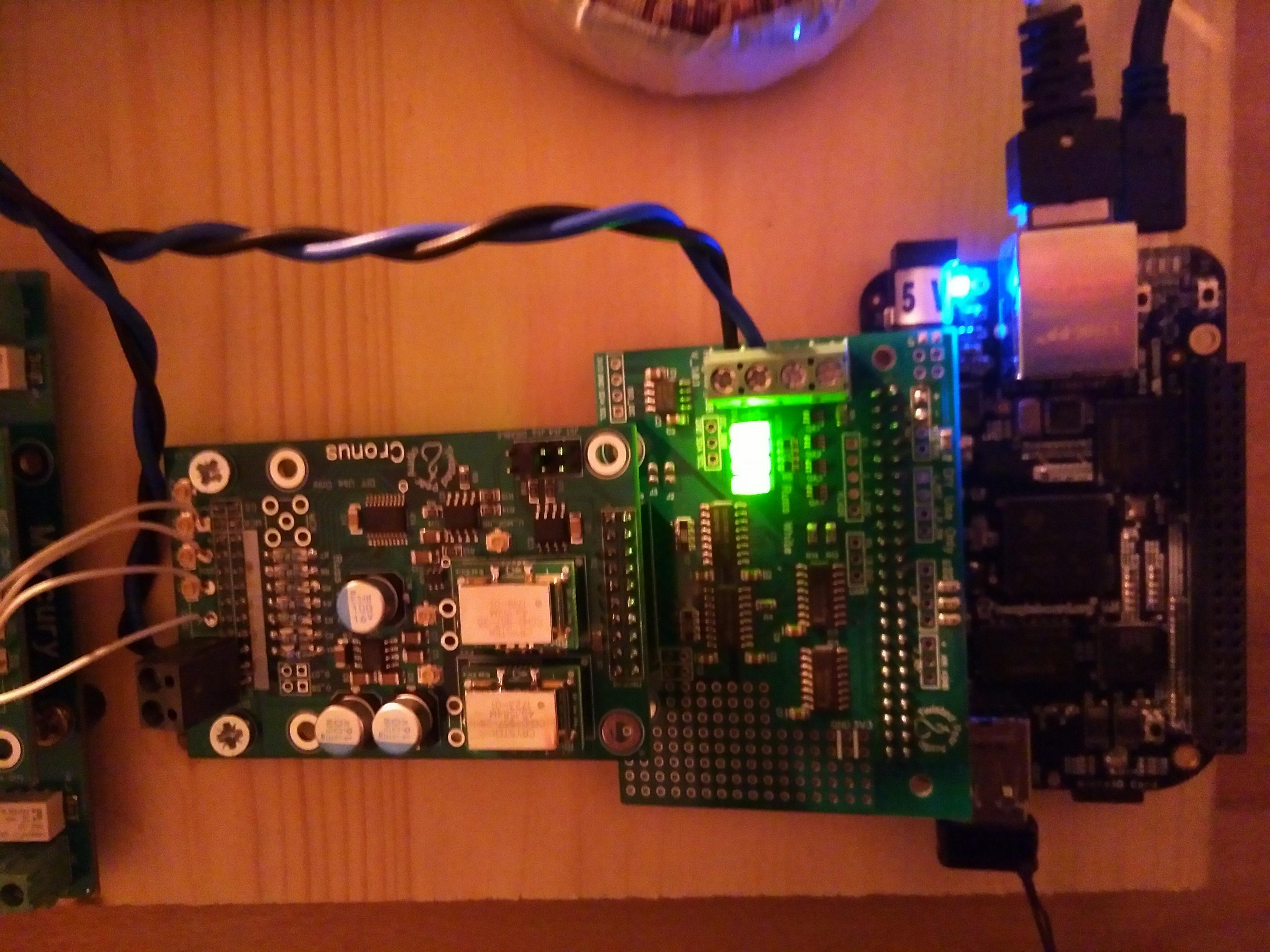

Q1 - There is no easy way to do this - but you could power it up (seperate from BB) and apply a high signal at the LED driver inputs. You have access to the schematic. Make sure you LEDs are oriented correctly.
Q2 - See Q1- I would simply try checking for unexpected shorts to GND on the header(with the Hermes completely disconnected from power and the BBB) - and if you don't find any - then try playing some music.
Q3 - Only you can know this - I suspect maybe battery wiring? 🙂
Q4 - I power my BBB from a dedicated switching supply as you would normally do for a plain BBB. This supply just needs to be able to supply all the current you need (I use a 2.5A supply) - it does not need to be low noise - totally not important here.
In your picture you are missing a GND connection at the cronus outputs to the DAC. The LCDPS GNDs are not joined.
stefanhgm:
- check the voltage to BBB, it shall be 5V +/-0.25V
- battery pins between Hermes-BBB and BBB (2x2 connector next to the J1) is not soldered .. however this should not cause the damage
- you have connected both Cronus and BBB to the same power supply - although this should work, I'd not use that ... use same supply for DAC & Cronus and separate for BBB
- does the old BBB work if not connected to Hermes-BBB? it is strange that any LED is not lit or at least blink when connected to power ... try powering it from USB (but remove the SD card - it consumes too much power)
Indeed - as miero said - it is much better to power the BBB 5V supply separately from the clean side of the hermes (Cronus side). The key thing on the BBB supply is to use one with plenty of current capacity. The whole idea of the hermes is to keep the Cronus/DAC isolated from the BBB - that's why you want to use a different (preferably efficient - switchers are good here) and higher current (I recommend 2A type or better) power supply for the BBB.
Thanks for all your replies!
I removed the battery, connected the Cronus to the clean side of the LCDPS and added the missing ground connection from the Cronus to the Bufallo. I power the BBB with a dedicated power supply.
Now the Bufallo and Hermes work! All four LEDs light up properly. Either it was the battery that destroyed the BBB or I destroyed it by accident.
You mean I should connect the two GNDs of the LCDPS, right?
When I play music with Botic selected in Volumio I don't get an ouptut signal. Any idea what could be the problem now? 🙂
I just meant that if you use two supplies for Cronus and DAC - they need to share a common GND. 🙂
I see. Thanks for the clarification!
