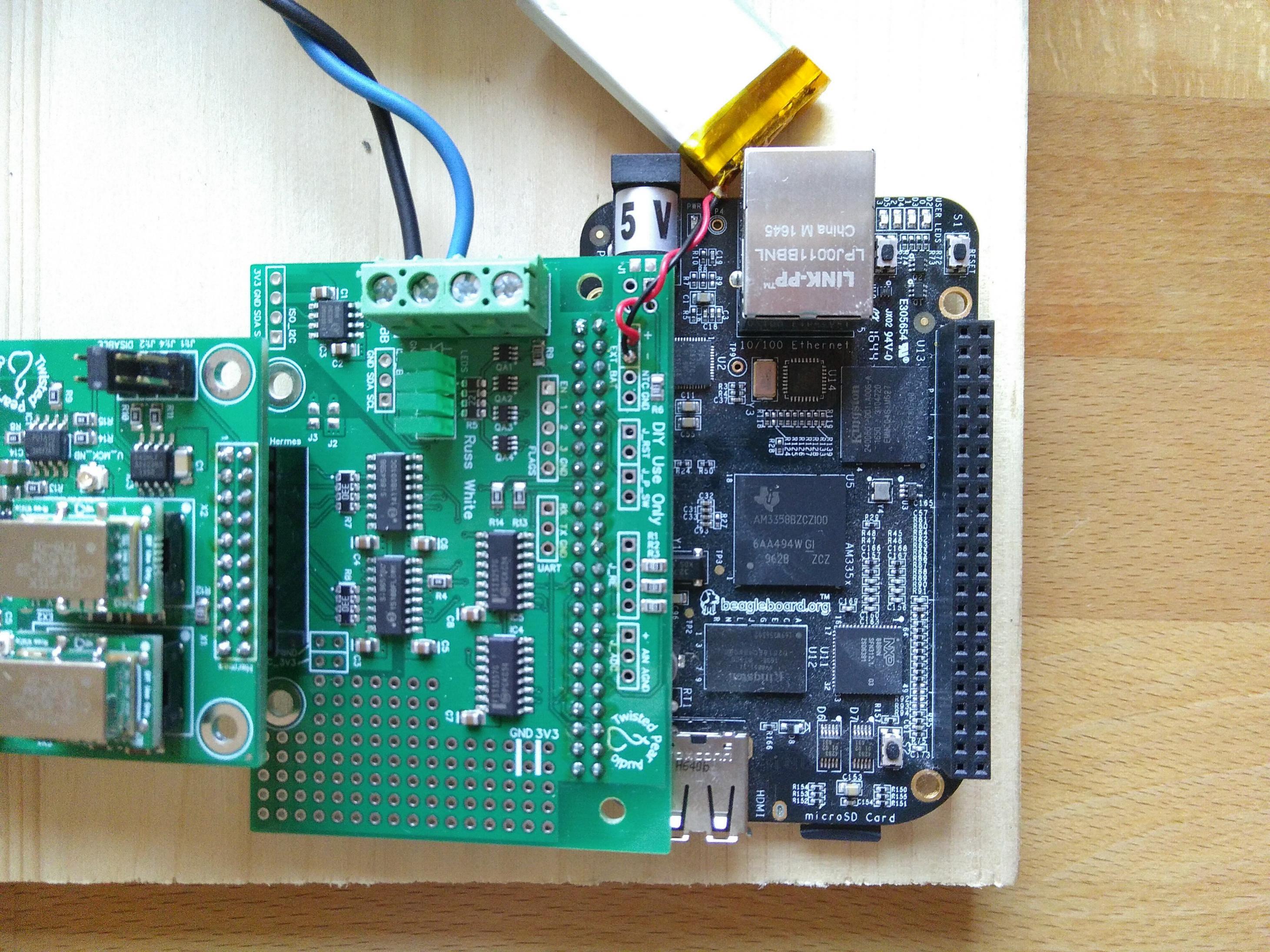

Maybe someone on this thread can help me out?! I’ve got moderate hacking/soldering skills and a medium level of knowledge about electronic components. I’ve got a DMM but no scope.
I started with the BBB image posted in the DSC GB thread, basically completely stripped save for NAA and a shell. I can get the BBB to play if I set the clock to internal and do not connect the Hermes board (without Cronus). Even with the clocks set to internal as soon as I connect the Hermes ALSA on the BBB will time out. Right now I’m using the botic image from ieero.com with the same results so I’m thinking hardware problems for sure.
I’ve read through hundreds of posts 🙂 and I’m thinking maybe the BBB is not getting a clock from the Cronus - but that doesn’t make sense when I set the optargs to the internal 48k clock of the BBB why the Hermes will stop playback?
I’ve attached a few images of my board config - no DAC connected currently as I haven’t gotten past the inability to start playback. I ended up reversing the header on the Cronus / Hermes connection after laying it all out (without a hot air station that was fun...).
I reflowed all header solder joints as well as the 4-pin sockets for the RHEA modules. There was a wonky SMD component on the Cronus - I was able to shift it over just a little bit so it wasn’t on top of the cap right next to it. I’m supplying 5.2V to each module and it doesn’t seem to make a difference whether I give power to the BBB/Hermes side from the Hermes or the BBB barrel connector.
Any thoughts are appreciated!
Have you enabled external clocks?
Clocks configuration
Installed clocks are configurable via:
- kernel option snd_soc_botic.ext_masterclk
Examples:
0 ... no external clocks, just onboard for 48k freq
1 ... external clock for 44k1 + onboard for 48k
2 ... external clock for 48k only
3 ... external clocks for 44k1 and 48k (default)
+4 ... invert polarity of clock selection switch GPIO0_15
9 ... external clock for 44k1 only
Yes - if I set the master clocks to ‘0’ and boot without the Hermes connected I can play a file. As soon as I connect the Hermes (without Cronus) and have the master clock still at ‘0’ ALSA times out.
If I set master clocks to ‘3’ I get ALSA timeouts in any configuration.

4 pin socket next to J1 on Hermes? ...unless you want a different source than the bbb for non-isolated side...
Use 2:1 divider on Cronus...
Also - and important!... when running without a battery to the BBB/Hermes you must never interrupt power. Always shut down the BBB either via command line or small on-board button before removing power source.
Yeah - I’ve been doing the bulk of the testing using the 2:1 divider and the default clock rate kernel options for botic, I thought I’d give 1:1 a shot, to no avail.
The 4-pin header near J1 on Hermes - I thought those pins were for jumpering when a battery is connected? I’ve got no battery attached currently.
@darkstargtk... BTW, the battery should be typical LiPO voltage - ~3.7v. At first I thought it needed to output 5 v so included a USB voltage regulator - no go. For a permanent installation, I think a battery is more than worth the effort. I suggest placing it where any unintended heat buildup will not cause damage to another component in the chassis. Also, I may be mis-remembering re: 5v from BBB to Hermes (it's been ages since I set mine up). 🙄 Check the Hermes sources for voltage with a voltmeter. Some are 3.3, some 5v...
Francolargo- thanks for the tips regarding the battery - I’ve had one on order from overseas - it should be here in the next month or two! Haha.
Yes - the Hermes and BBB share 5v on the ‘dirty’ side. I’ve got 5 and 3.3 on the Hermes when it is powered from the block or via the BBB. With the Cronus connected I also have 3.3 on the clean side.
I’m pretty sure a clock is not making it to the BBB but I don’t know how to check! I’m also stumped why ALSA times out with Hermes connected and BBB told to use internal 48k clock...

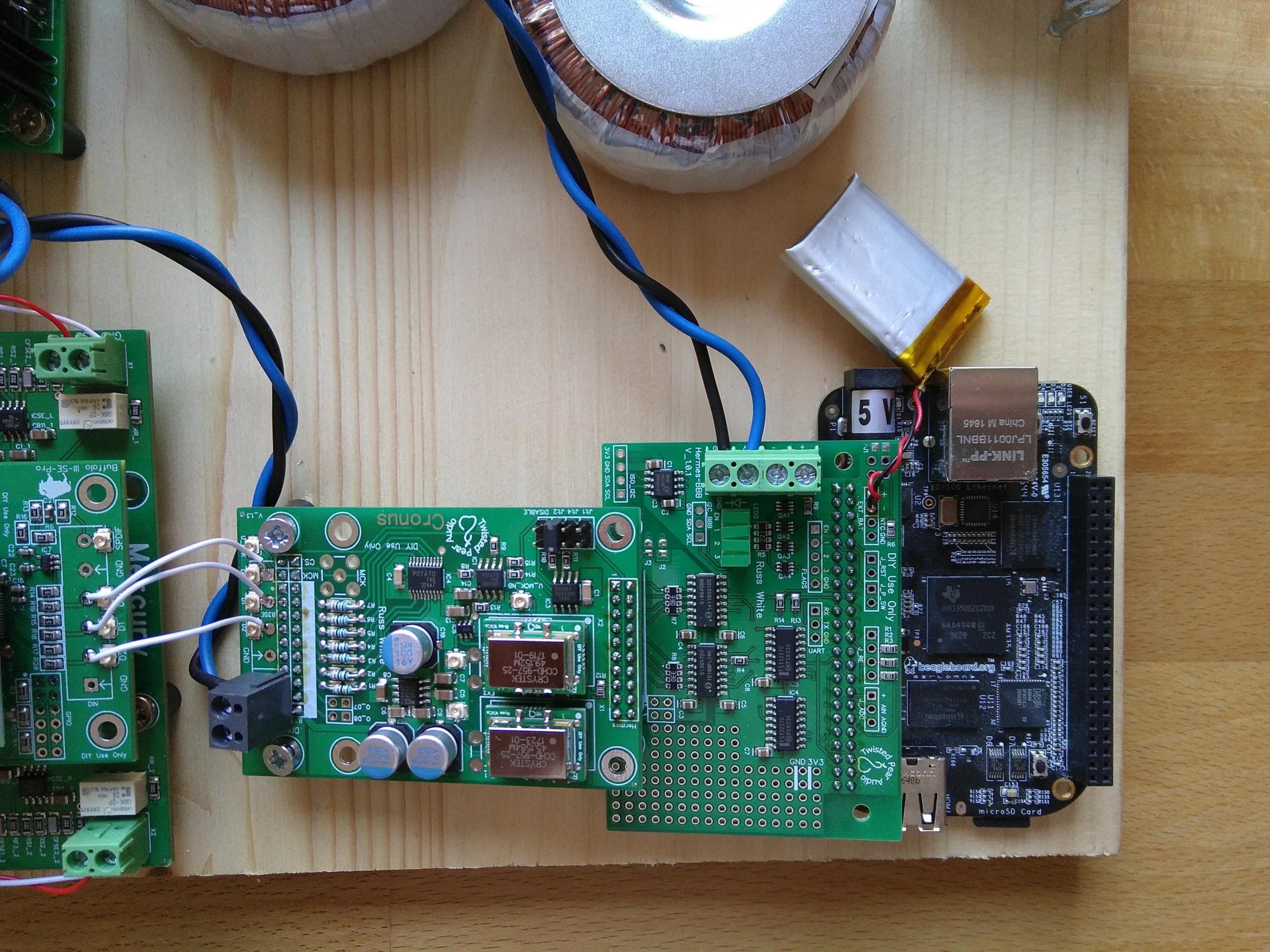

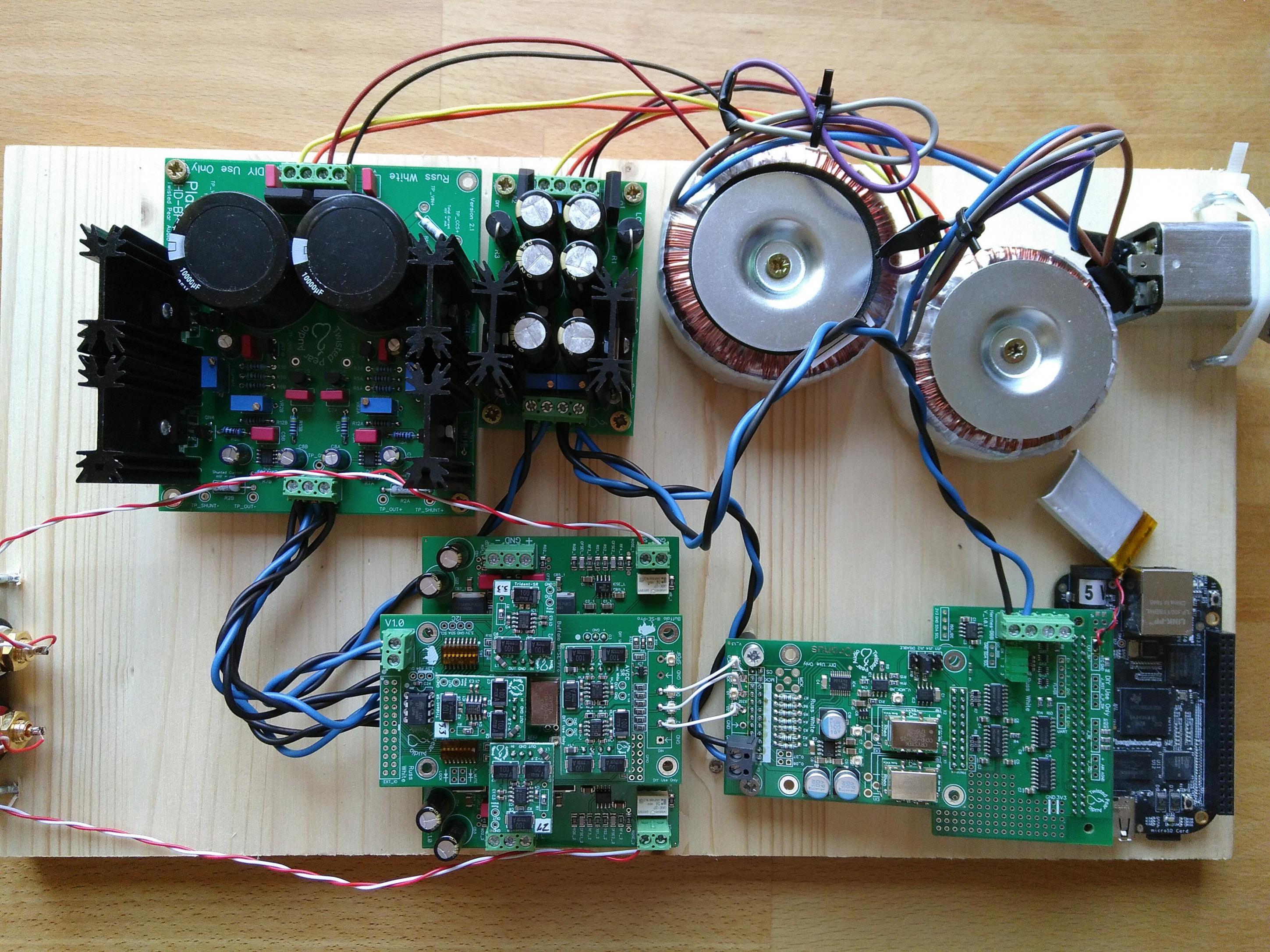

Hey everyone, I finished the prototype of my Buffalo-IIIsePro38 build. The whole setup is shown below.
However, I got a problem when turning it on for the first time (already described in the Buffalo thread). The four LEDs on the Hermes-BBB board only flashed for a brief moment and then went out. After that the BBB board was dead (there are no burning marks on the board). Now I ordered a new BBB but do not want to blow it up again. Maybe you could verify my setup or give me some advice how to proceed?
I attached some pictures of the setup with close-ups of the Hermes-BBB. I configured the Placid HD BP according to the manual and also verified the correct voltage of 5V for the LCDPS.
Q1: The Hermes LEDs also do not light up anymore. Does anyone know whether it requires a working BBB in order that the LEDs work? This would mean the Hermes is also destroyed.
Q2: Any suggestion how I could verify whether the Hermes-BBB is still working?
Q3: Any suggestions what might have gone wrong with my setup and what I should change for next try?
Q4: What is the best way to power the BBB board? Also from the LCDPS or with its dedicated mini-USB charger? I used the latter.
Thanks!
