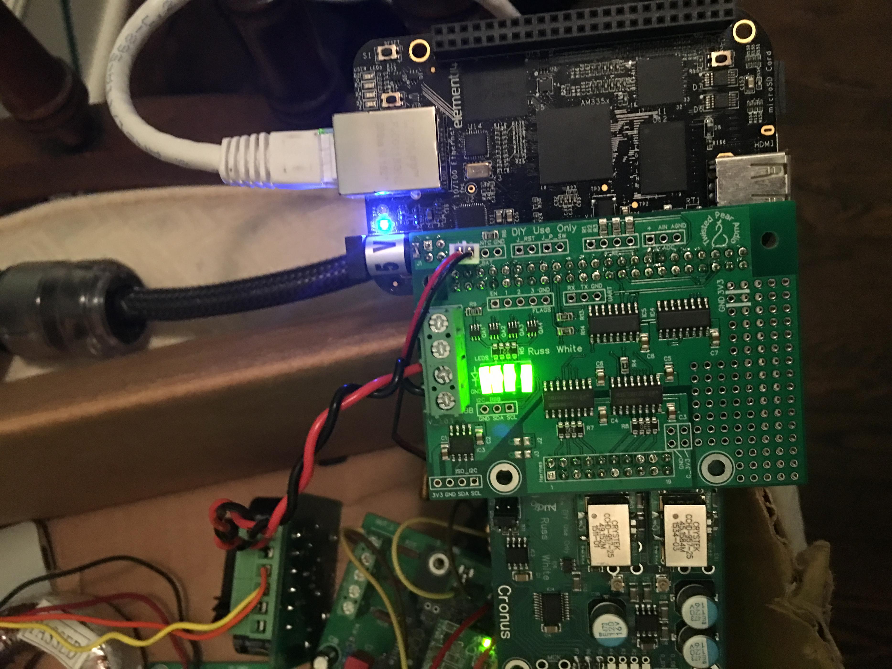

Even with the same Hermes/Cronus boards, those LEDs can not be lit up when connected to a particular BBB (actually BBG) as shown below.
The BBG failed in turning LEDs on in the picture has a problem of causing failure to boot from external SD cards, probably due to inappropriate setting of GPIOs, though I have no idea how to correct it. Despite of this deficit, it can be normally up and running when booted into eMMC.
Just FYI. Regards,

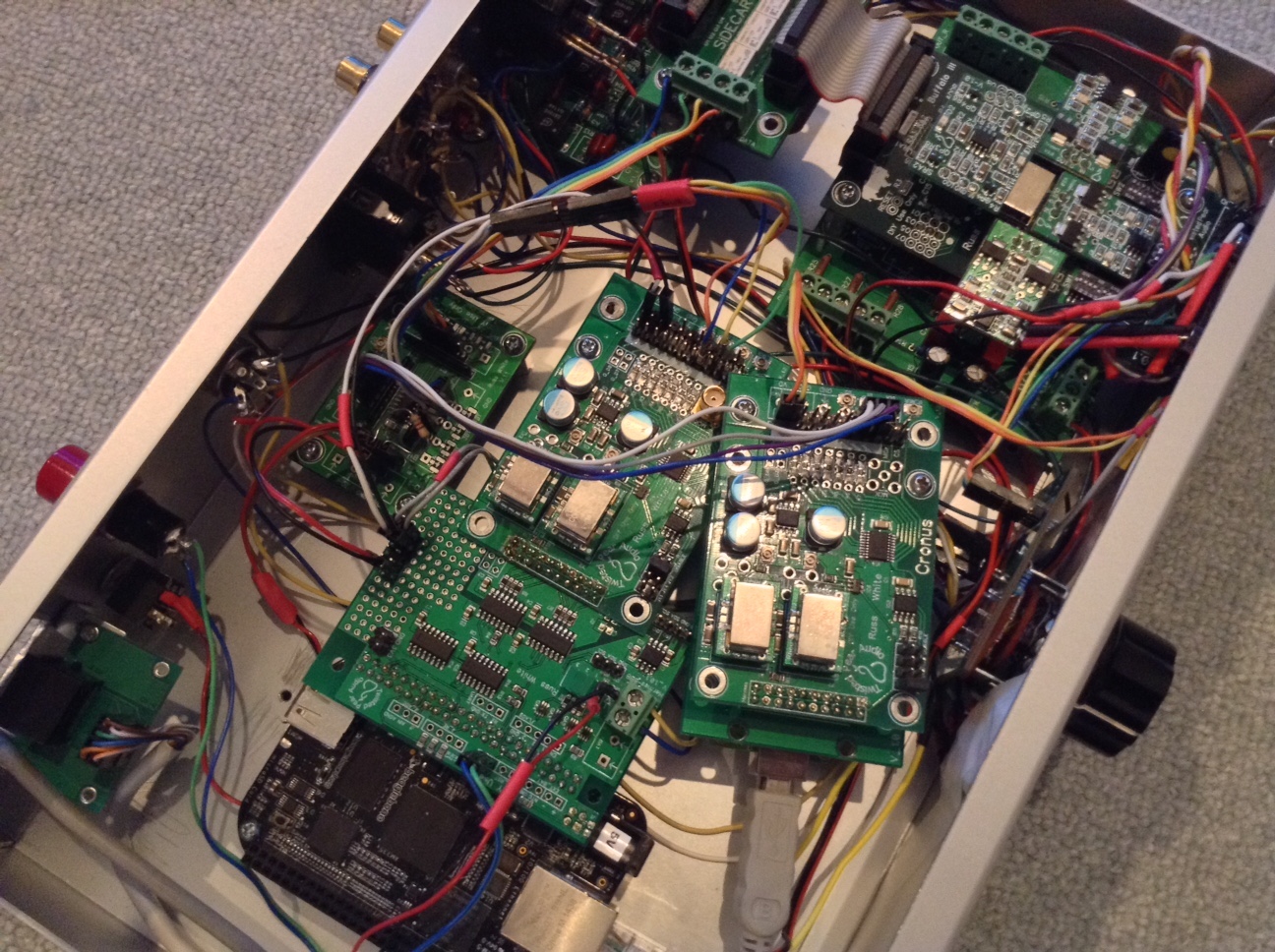

You need two sets of Hermes/Cronus boards, one for BBB and the other for Amanero, respectively, and Otto II from TPA does work for switching between them. Below is an example of this situation in my B3 box, though the placement of boards is cluttered because of later addition of Hermes-Amanero board. 😛

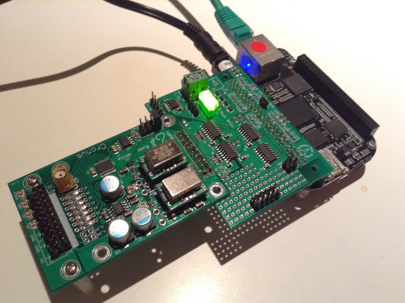

It's alive! Many thanks to Brian for a new Hermes board. Soldered it up and everything lit up. To answer my own question from earlier, lights 1-3 turned on immediately on power up, and the EN light came on a second or two later, once the row of blue leds on the BBB started flashing.
