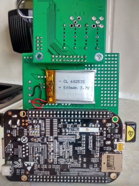

Hi
I am just in the process of checking everything works ok on my build, all seems good, remote files mount and can play from cmd or ympd and connect via wifi or wired, I have not been able to listen yet as I'm still waiting for teleporter.
I have fitted a battery as shown but on removing the power from BBB the system appears to just crash, all leds on BBB and Hermes just go off instantly, can someone describe what should happen when power is lost, is there a setting in Botic5 that needs to be changed to initiate controlled shutdown?

Sorry Russ, I should have mentioned that, I had shorted it and the battery charges fine, what should a controlled shutdown "look" like? same as pushing the power button on the BBB?

Did you mount the 4 pin headers for the battery connections to the BBB? It's hard to tell from the photo.

No, just connected the battery as shown in your photo on the other thread some time ago, should I have?

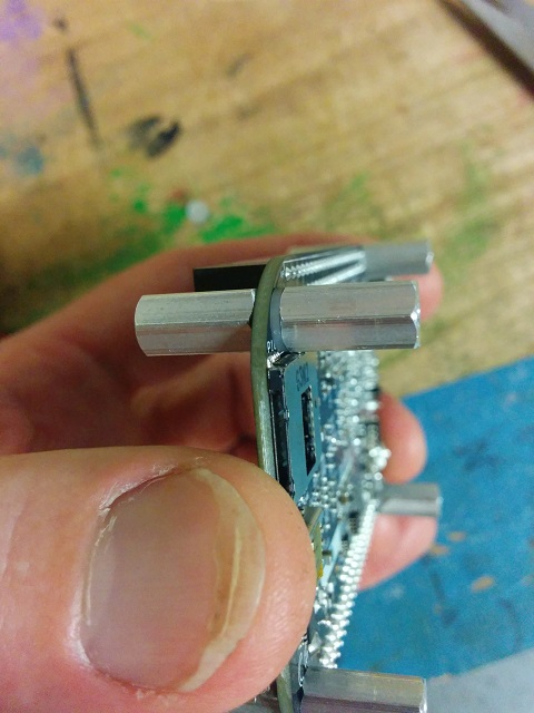

Researching the microSD card issue, I checked the solder pads under a binocular scope. I was surprised to find physical contact had been made between one uSD card reader pad and the stock TPA aluminum standoff that was usually in place on the BBB. That would ground the pad. At worst, two reader pins could even be bridged, though I'm sure that didn't occur. So be aware of the standoff type/placement on BBB!

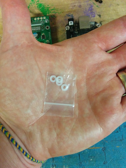

I am now shipping a set of nylon washers with the kits.
If you already have a kit and want/need some washers, drop me a line. I will email all current users about this as well.
