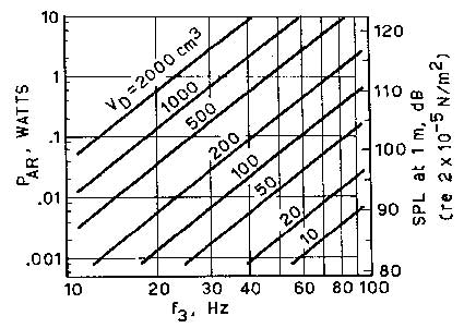

Volume displacement determines the SPL. The only difference with higher efficiency is you'll need less power to do it.chops said:Also, the more efficient the driver is, the less you have to worry about Xmax as it will take little power to get loud.

Brett said:Volume displacement determines the SPL. The only difference with higher efficiency is you'll need less power to do it.
Exactly, less power means less movement from the driver, which means more volume before reaching Xmax.
No.chops said:Exactly, less power means less movement from the driver, which means more volume before reaching Xmax.
If you have a 15" speaker excursing 1mm, it will be giving the same SPL whether the driver is 100dB or 80dB sensitive. The latter will simply be using 100x the power to do it.
Brett said:No.
That doesn't make any sense. How can that be?
I have had 4 different 15" driver in the front of my room. I have seen all 4 reproduce 50Hz at the same volume. Some use more power than the others, but they also travel more/less than the next at that same volume/frequency.

SPL is about pressure and the quantity of air moved. Move the same volume of air at the same frequency and it will be the same SPL. How you move it doesn't really matter.chops said:That doesn't make any sense. How can that be?
