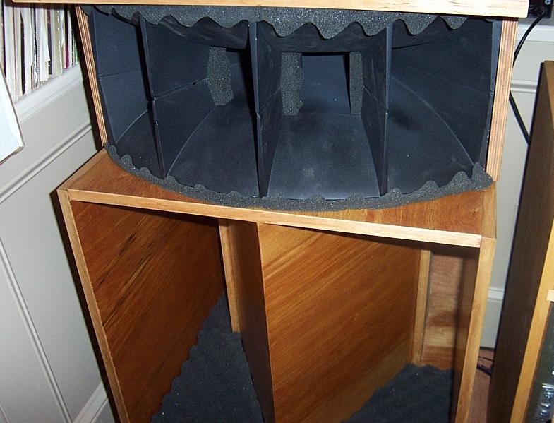

Chops, I can't agree with Pano more. Killing the edge reflection on the Altec horn is the best improvement I've made so far. I'm still experimenting but this is where I'm at right now. It's just regular egg crate foam....

Do you think you're getting most of that "edge reflection" from the top of your folded horn (La Scala ??) below the horn and piece of wood above the horn?
The reason I ask is because I never had this issue while running the Klipsch Cornwall bas bin, even when I measured with TrueRTA.

I do suggest you try the old towel trick. It's fast, easy and cheap to do. Or use foam, if you want. I was surprised at the difference it made, both to the ear and to the measurements. The horn edge and how it couples to the open air is important.
I don't think so. I was running the horn without the top hat and tried poking it forward past the frame - didn't seem to make a difference. The altec horn/902 sounded good, but not as good as I had hoped. A bit shouty in 'my' opinion. I started out by draping laundry around the horn - some of it dirty. What a difference!
My wife didn't like the dirty socks draped all over the place, so I had to do something!
