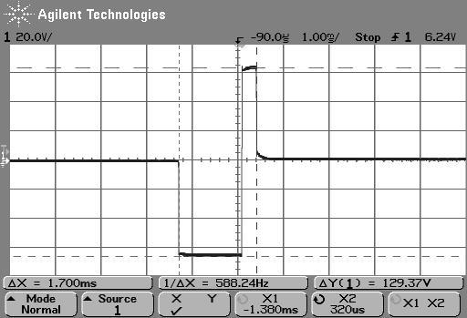

This is the output waveform (time triggered) of an AMC 5 channel amplifier model (I think it is a copy of a NAD?)
One channel exhibits this large spike (as per attatch) thru the speaker about once every half hour or so. Totally makes you jump out of your skin!!!
Does anyone have any ideas on what would cause this fault?
It occurs regardless of a speaker load connected or not.
I know it is not the power supply as the other 4 channels don't have this fault at all.

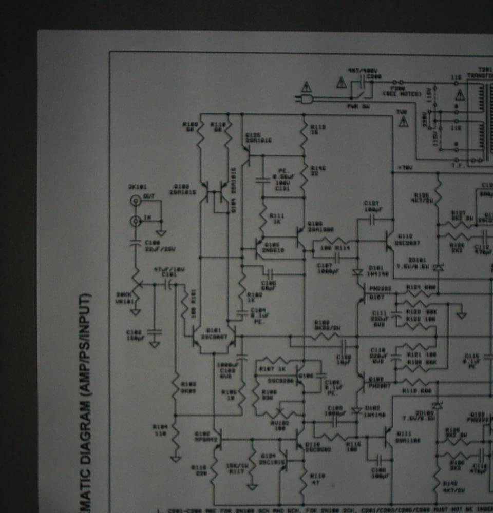

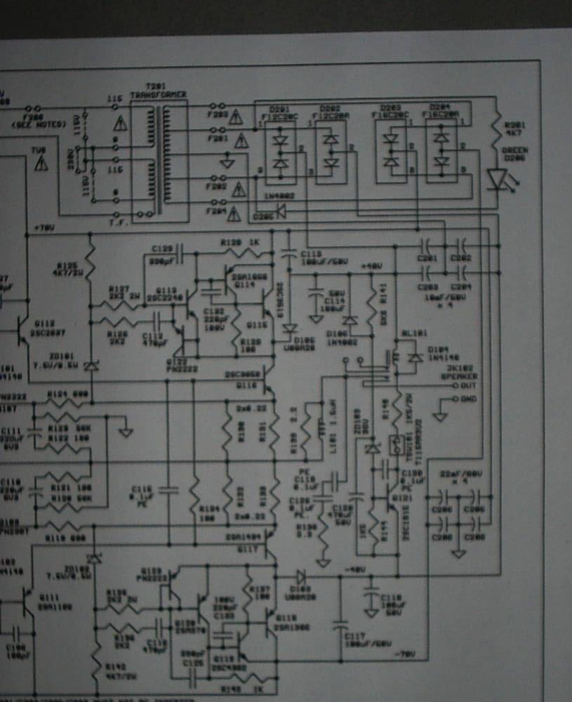

I have the schem in paper form and will try to beg, steal or borrow a scanner to get it online before the thread runs out...

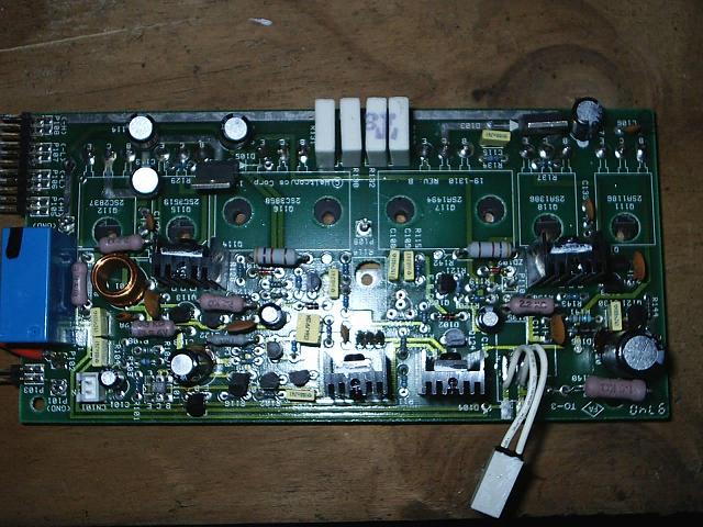

pcb pick.

And some tests that have been done.
Tests so far were:
test 1 loaded 8 ohms with 1K sinewave test (0.5 hours)
test 2 loaded with a speaker load (a very old cheap speaker)and music playing (12 hours)
test 3 with the OPS loaded / and unloaded,amplifier idling and no driving signal applied to the input.The trigger sensing shows waveform (as per first pic). The Spikes show up regardless of loading the OPS.
I will redo test1 and see if the spike shows up when it is drawing some load current.
The pops occur about every half hour or thereabouts so maybe it is a capacitive timing thing. This is a good one!

Update so far- I have removed every electrolytic from the pcb and are awaiting on a new 100R bias pot.(This pot had had a small crack on it's plastic slotted part)
One stand out thing is that the brown glue they use to mount the electrolytics seems to "eat away" other components around where it has been placed. One small diode had a very corroded lead.
I will re assemble the unit with new electro caps this week and soak test again.
Will keep you all posted. Cheers Andjur78.

I've seen the brown adhesive become conductive. Touching the scope lead to it while the amplifier is in operation will tell you if it's happening in your case.
The corrosion sounds more like leaking electrolyte. If that's the case, you need to thoroughly clean the board with a solvent (acetone) before replacing the caps. Since it's a double-sided board, you need to make sure that any feed-throughs under the cap are still intact.
Many defective semiconductors are sensitive to temperature change. The cooling spray is a good idea. Placing your soldering iron very close to (or touching) small driver transistors will heat them up. Most of the semiconductor manufacturers use a plastic with a melting point above what your soldering iron can produce but a few (philips) sometimes use a plastic with a low melting point so be careful if you actually touch the plastic case of the drivers with your iron.

How about disconnecting the PSU, and monitoring it for glitches.
At the same time you could power-up the amp via an external PSU and monitor that too. Next stage, I suppose, would be to disconnect each stage in turn (I'd start with the driver stage), and see where the pulses are introduced.
