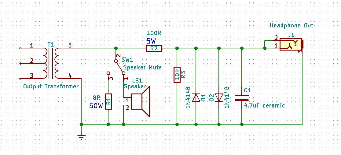

I don't think 100 ohms in series is a good way to attenuate the headphone signal - this might make the bass boomy, and the SPL from the headphones will vary widely with headphone impedance. I think it's probably safer to use two resistors to divide down the voltage before it gets to the headphones.
IMO, there are at least two other issues to consider. Firstly, and very important, headphones can very easily generate ear-damaging SPL levels. A single loud "pop" from the guitar amp might leave you with permanent hearing damage. So I think it's important to limit the maximum SPL from the headphones in some way.
Two, guitar speakers roll of all treble above 3 - 4 kHz. Headphones don't. So the overdriven tone through headphones is likely to be incredibly harsh and ice-picky, maybe even ear-damaging.
Keeping simplicity in mind, the attached image shows my suggested circuit.
The "Speaker Mute" switch lets you either keep the speaker in circuit, or replace it with an 8 ohm dummy load. The dummy load resistor should be rated at 50 watts and mounted with heat-sink grease to a metal plate to act as a heatsink; it has to safely absorb the full power output of your amp, and if it ever burns out, so will your amp!
If someday you want to monitor your amp with headphones while at the same time mic'ing the speaker, this arrangement will let you do that. Alternatively, this will let you use your headphone jack as a (crude) line out for the amp, which might be useful for recording or passing on to a P.A.
The two back-to-back 1N4148 diodes across the headphone jack are there to try to prevent permanent hearing damage caused by pops or ticks. They limit the maximum signal across the headphones to about 0.5 volts peak. With typical 32 ohm headphones with a sensitivity of 100 dB SPL @ 1 mW, this will still be ear-damagingly loud (around 110 dB SPL), but hopefully, not "blow out your eardrums" loud.
Diodes are very cheap, and your hearing very precious, so I think adding these two diodes is well worth the small extra complication. If the signal ever gets big enough for the diodes to start clipping, then the SPL at your ear is damagingly loud, and it's time to turn down the volume. At reasonable SPL, the diodes should never conduct, and so never be audible.
Finally, the 4.7 uF ceramic cap will filter out harsh treble above about 3.5 kHz. It will not filter as heavily as a proper guitar speaker, but at least it will take a little step in the right direction.
You can use an expensive film cap here if you like, but there will be zero benefits, so I'd suggest the same sort of little multi-layer ceramic cap I mentioned on your other thread. It only needs to be rated for 5 volts or more, as there is very little voltage across the actual headphone jack terminals.
I should make clear that I haven't built or tested this, so I'm taking a shot in the dark. I think it will work for you, but I can't guarantee it. Also, depending on your headphones and desired SPL and treble response, the 10 ohm resistor and / or 4.7 uF cap values might need to be tweaked to your taste.
Edit: Your amp is safe in both positions of the "Speaker Mute" switch, so it won't blow up if you accidentally forget to flip it when you plug in headphones. (However, if that switch fails to make contact, your amp is in danger. And make sure the switch isn't the "centre off" or "on-off-on" type, i.e. make sure to use an "on-on" SPST switch.)
-Gnobuddy

Unfortunately, this won't work, for a not-so-obvious reason. The two resistors will do exactly what they're supposed to do (divide down the voltage in the ratio 3.3/(3.3+68)) UNTIL you plug in the headphones. At that point, the 32 ohm (typical value) headphones will appear in parallel with the 3.3k resistor. So now the voltage divider is effectively 68k and 32 ohms...and you get only a few millivolts across the headphones, which will be far too quiet.
Looking at it a bit more technically, the problem is that a voltage divider has a non-zero output impedance. If fed from a voltage source, the output impedance is mathematically equivalent to the two resistors in parallel. In this case, 68k and 3.3k in parallel produces a 3.147k (that's 3147 ohms) output impedance - which is far too high to feed 32 ohm headphones.
The fix is to lower the resistance values, a lot. That's why I suggested 100 ohms and 10 ohms.

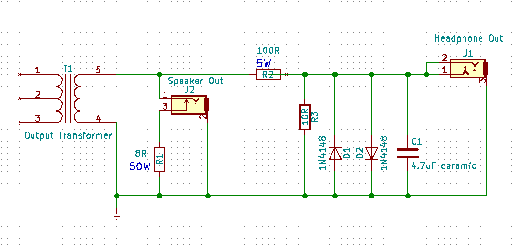

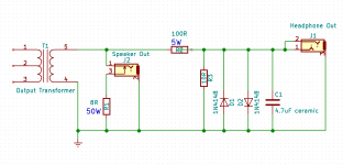

Here's version 2 of the headphone out, this time using a switching jack for the loudspeaker. (So no separate switch.)

Here's version 2 of the headphone out...
Sorry, but I made a mistake in that schematic. R2 was supposed to be 330 ohms, not 100 ohms. I typed in 100 ohms as a placeholder value while drawing the schematic, and then forgot to calculate the proper value and update the schematic. :eek:
With the increased value (330 ohms) and only 6 watts from the power amp (about 7 volts RMS max), R2 can be a half-watt resistor (doesn't need to be rated at 5 watts.)

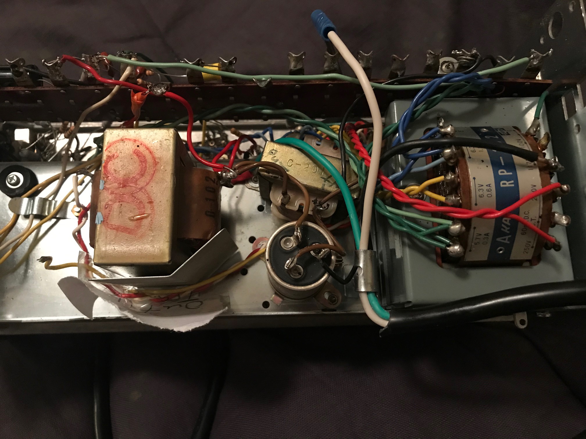

Speaking of old things, and more related to the thread topic lol... (I really don't mind these tangents at all during down periods in my project post/questions, they keep things interesting :) )
I wired in my mini pots for the tremolo system and bypassed the microphone output for the time being to take the amp on its first test run last night and...

I'd already tested the unit before conversion to assure both transformers checked out, and had a nice strong output. But when I wen't to test last night the power transformer started up right away and warmed all the tubes correctly, but I couldn't get any output to the speaker at all. Not a single hum, noise, or crackle. So either my output transformer has suddenly died completely or I've gone wrong somewhere in the circuit wiring that I'm not aware of...:( I didn't have the time or energy to fully trouble shoot it last night so I'll have to do some work this weekend and hopefully come up with an easy solution, like a missed connection or poor solder somewhere. I'll post more when I know more. Wish me luck haha:xfingers:
We've got trouble lol :headbash:

Quick update since it's been quite a bit since my last one.
I figured out there was an issue in the EL84 tube socket, I believe with pin 3 which is the cathode. The after narrowing it down to the socket alone and not the tube itself I started work in removing the socket for repair or replacement. The sockets are all riveted in on this amp so it took some prearranged reorganizing and safety precaution to cover and protect the rest of the amp from metal shavings before I started drilling. I couldn't do anything to save the socket, the pin inserts are not removable on the socket and it's just too tiny to work inside the pin holes to see if there was an obstruction to be cleared or another fixable problem. Unfortunately the original has to be the smallest tube socket diameter I've ever seen:magnify:. It's barely wider than the pin holes. As a consequence of this I tried 3 different brands of socket with no success fitting the tiny existing socket hole. So I had to drill out the hole to fit a new socket and measure out new holes to bolt the socket it, then realize that no matter how I arranged it there was only enough room for 1 bolt and nut to be properly inserted and threaded before running out of room to work in the second one:headbash:. So more time was taken to properly secure the socket in well enough that it remains secured to the chassis whilst removing a tube from it. I'm hoping to re-solder the socket connections soon and that there aren't any other major issues to suss out. I'll update again once that's all done.:xfingers:
Quick update for anyone following along with my faithful friend Gnobuddy:)
Help needed please lol :headbash:
I’ve finally had a little free time to work on the amp, here is what I know:
All of the wiring and connections are good, I’ve checked them each 10 times now.
The power transformer is good.
New tubes in all sockets and they all light up when powered on.
Still no output to speaker at all, not even a single hum or crackle.
But the output transformer passes every test I’ve thrown at it. For example all measurements I take from it are correct, and when placing a 9V battery between the output transformer’s primary terminals I do get a crackle from the speaker. So I’m pretty sure it’s working.
The one area I’m beginning to wonder about now are the capacitor can and choke filters in the attached photo. Both sit in the circuit between the output transformer and the incoming B+ power. The cap can has 2 x 20 mfd capacitors inside that are original to the Akai unit and have not been replaced. The choke filter is original to the unit as well and not inherent to the AC4 design but I thought it couldn’t hurt to leave it in. However it occurs to me that if one or both of these items is failing that could interrupt voltage to the output transformer and explain the symptoms my amp is exhibiting.
Anyone have any thoughts on if my thinking is possibly correct, and how should I go about testing to see if either the capacitors in the can and/or the choke filter are failing? Hoping there is a way to test them in the circuit but I can remove them without too much trouble if necessary.
