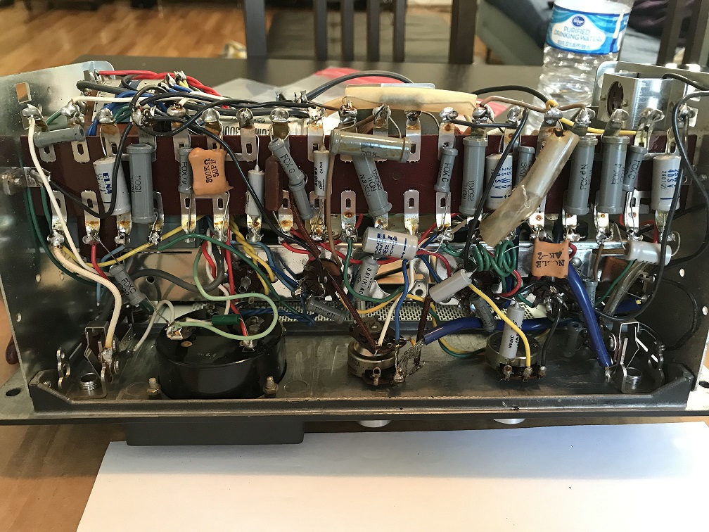

Okay, the last conversion to guitar amp project was a success so it's time for another one! :D I have on the way to me 1 Akai M8 Reel to Reel Amplifier, right side only (originally designed as mono with right only engaged or stereo when selected engaging a left side amp). I'm told it's working condition but we shall see how its doing once it arrives. In the mean time lets get planning for what needs to be done.
What we have for tubes:
1 x EF86 & 1 x 12AX7 in preamp,
1 x 6X4 rectifier,
1 x EL84 output
Transformer is putting out 250V
Speaker Out is 8 Ohms
Max output to speakers is 6 watts (probably less)
Schematic is attached with signal path traced out as best I can figure. There is a bit of a convoluted thing where the EF86 is driving the Volume pot and the 12AX7 drives the Tone pot/Speed selector knob. Or at least that's what I think is going on. I'll know for sure when the model arrives.

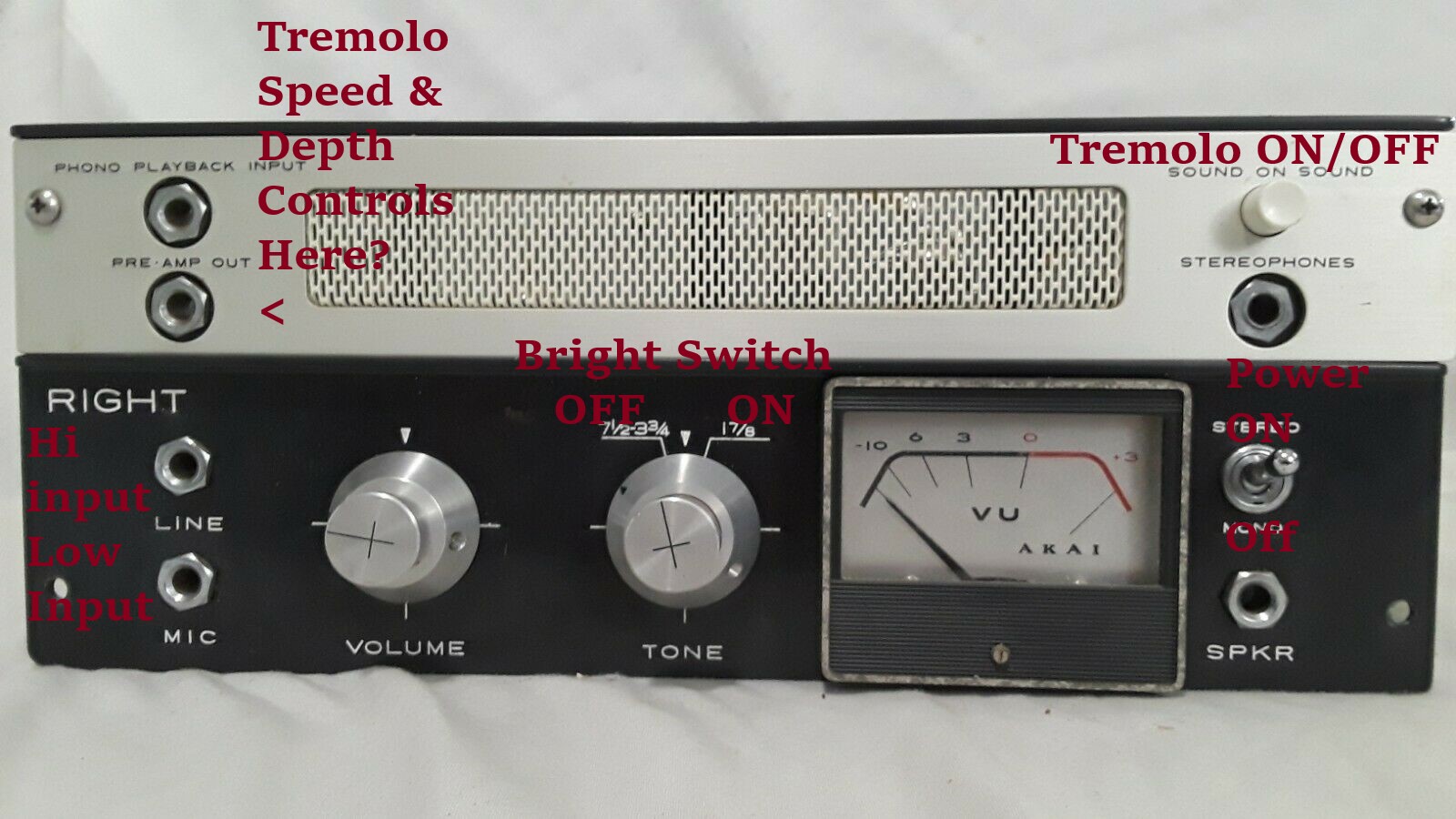

Okay, I spent some more time with the unit and realized some things:
1.) I definitely have room for speed and depth knobs to control the tremolo effect so I've added a depth pot to the schematic. I believe this is the correct way to do so. It's essentially the same tremolo circuit as the old Fender 5E8A Tremolux design. If someone more knowledgeable see's something different please let me know.
2.) The "SOUND ON SOUND" button in the upper right is an on/off switch so I'll wire that to control Tremolo ON/OFF
3.) The "STEREO/MONO" switch is basically the power on/off for this unit so I'll just re-label it to reflect this.
4.) The tone knob in place also has a speed selector that works as an on/off switch in the circuit. This is a handy place to wire in my bright switch so I'll take advantage of that :)
5.) The 2 inputs were already there so I went ahead and set one as a high input and the other as a low in the schematic.
Updated schematic attached and labeled photo of the face for reference to the switches and knobs mentioned above :D

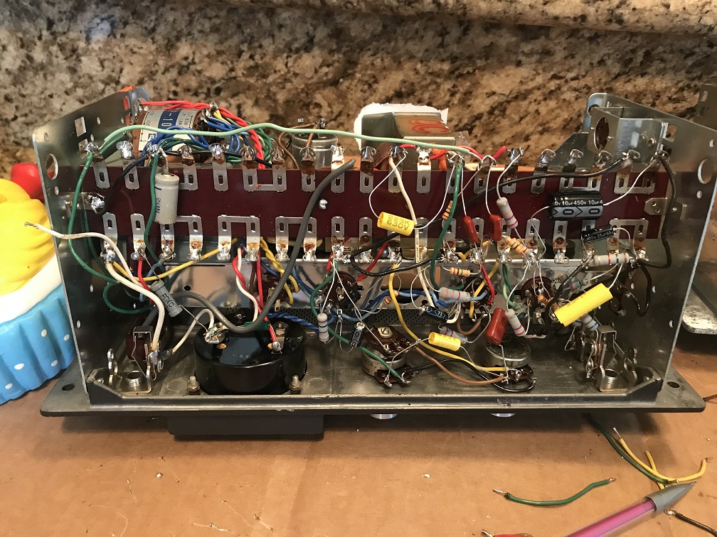

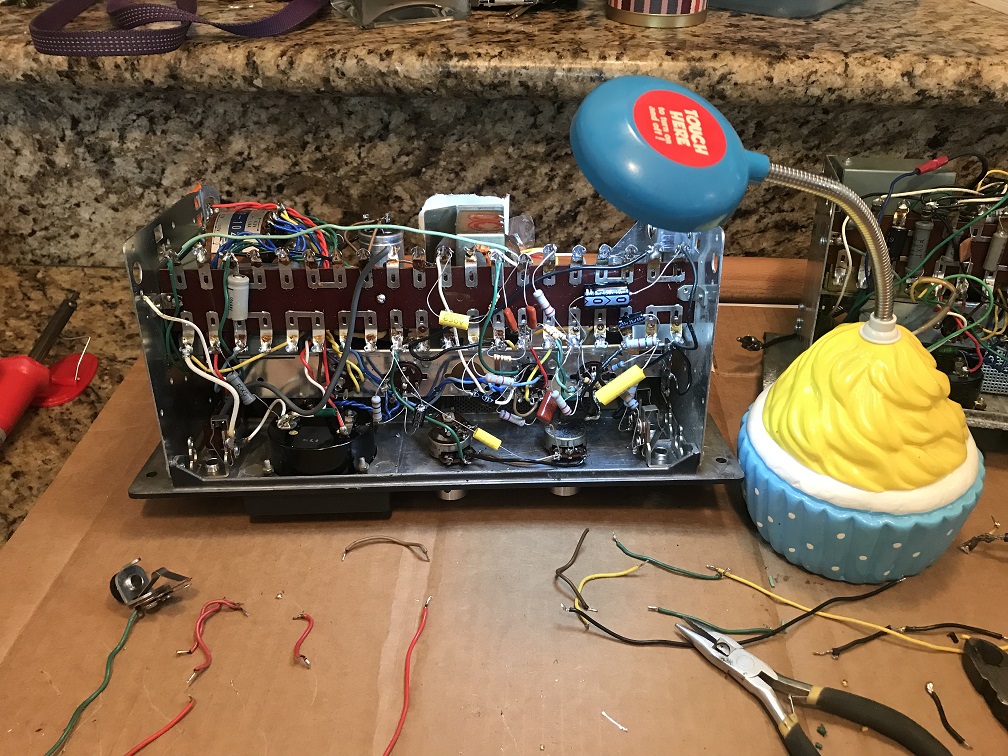

Finally got started on gutting the old circuit components the other night. Pics from right before I started removing things. When I'm done I'll have just the tubes/sockets, output and power transformers + the choke filter, and the input/output jacks I decide to keep. The 40 terminals on the fiber board should be more than enough for the simple capacitor and resistor network I'm putting in and there is ample room to work with my soldering iron :).
I'm thinking I'll keep all the B+ connections on top and the rest on the bottom terminals just for organizations sake. Also there is a large switching mechanism circled in blue) that is separating the EF86 & 12AX7 preamp channels as well as doing some power switching that is supposed to work in conjunction with the rest of the reel-to-reel units in the original design. That will be coming out for sure too. Right now I'm about 75% done removing old components, I'll post again once the gutting is complete and I start putting my new circuit in. :D

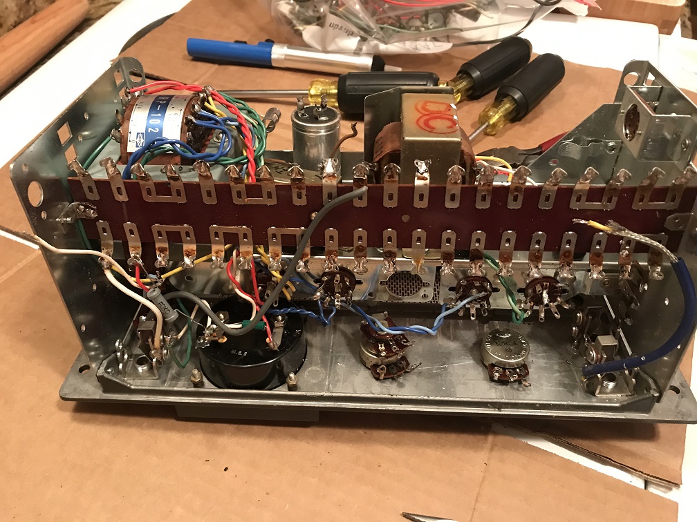

FINALLY finished removing all the old resistor and capacitor components last night. The leads were all wrapped at least 2 and occasionally 3 times around every post. I understand the importance of mechanical connection, but through the eyelet AND 3 times around the post is overkill lol :headbash:
Now I'm ready to start putting in the new caps and resistors and tiding up a few other connections and wire runs that could be done better. I hope to be done and have an update by the end of the week :xfingers:

...I understand the importance of mechanical connection, but through the eyelet AND 3 times around the post is overkill lol :headbash:
I agree, and incredibly frustrating if you're trying to rework a circuit.
Interestingly, when PCBs took over from turret boards and tag-strips, manufacturers stopped worrying about every soldered joint having to be twisted, looped, hooked, or otherwise mechanically connected, independently of the actual solder connection. With SMD devices, there is no longer even the option to make any sort of mechanical joint.
Looking at these examples all around me, even when I was a young boy, I stopped hooking, looping, and twisting component leads a very long time ago. I have never had any sort of failure as a result, and if I need to replace a component, life is much easier.
If you think about it, any mechanical force big enough to rip apart a good soldered joint is also, most likely big enough to damage the component itself. So if a good soldered joint comes apart, it's time to replace the component itself; knotting the wire leads in all the Boy Scout knots won't change this.
Items that are large and heavy (valves in valve sockets, non-miniature transformers, etc) certainly need to be solidly mechanically mounted - but not by the leads. Rather, by mounting screws, bolts, zip-ties, high-strength adhesive, et cetera. So, once again, hooking and looping the leads just wastes time and makes life unnecessarily difficult, with no compensating benefits IMO.

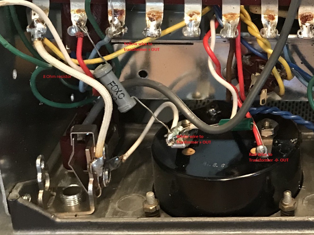

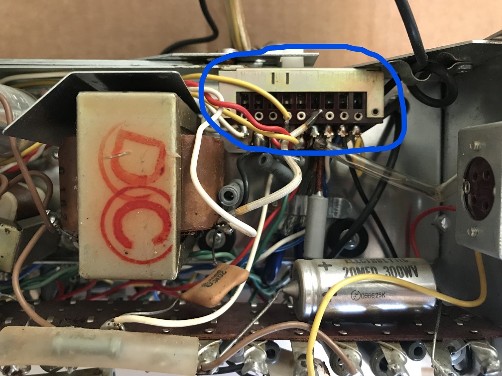

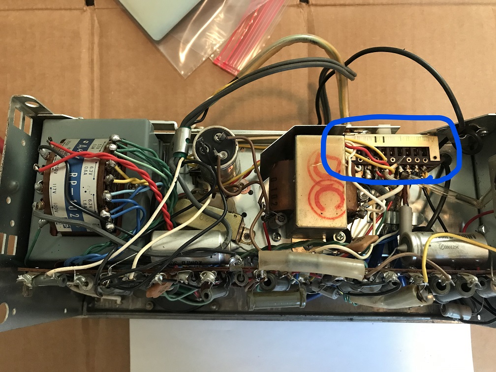

:boggled: I'm second guessing myself and need some help please to make sure I'm doing this right...
I hand drew a quick schematic for the connections needed to utilize the headphone out last night, but when I looked at my speaker out jack and realized I might be working too hard. Scan of the drawing and a pic of the speaker out jack attached:
The transformer needs an 8 Ohm load from either a speaker or a resistor if the speaker jack is not in use. The white braided lead is an 8 Ohm resistor still in place from the original circuit along with the yellow wire that runs up to the output transformer area. It looks like when there is no tip inserted into the speaker out that the tip and sleeves are connected and the the output transformer would see the 8 Ohms of resistance across both lines out just like a dummy load. The headphone out jack is just a standard stereo jack without the short when no tip is inserted.
My questions are:
1. Do I even need a switch at the transformer then or can the yellow line with 8 Ohm resistor and the normal line direct from transformer to the speaker out tip both be connected at all times? The signal would seek the path of least resistance and pass through the white line unimpeded without the yellow line causing too much extra resistance no? And when the speaker jack doesn't have a plug in, the jack shorts the tip and sleeve and the 8 Ohms of resistance is seen between them.
2. Is an additional 8 Ohms of resistance needed across the tip/ring and sleeve at the headphone out jack as well or am I okay just as the schematic is drawn here with an signal coming off the speaker out tip attenuated by a 100 Ohm resistor?
