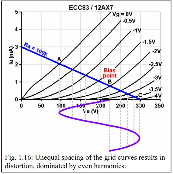

Well, whether we agree with Merlin or not, if you draw a loadline for a 100k Rp and 300 V B+ on a set of 12AX7 curves, there is no arguing the fact that the thing won't saturate below 100 volts - or that twiddling bias for maximum unclipped output headroom puts the anode voltage somewhere in the general vicinity of 200 - 225 volts (and not B+/2, which is 150 volts.)
The attached image is from Blencowe's book.

Using a 12AX7 that way might work for small signals.
But with quiescent plate at 225V:
225V - 90V = 135V
300V - 225V = 75V
135/75 = 1.8:1 almost a 2:1 difference
As the book says, that is Lots of even harmonics.
Probably good for a Guitar, but not for Hi Fi?
