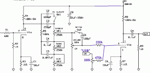

That link shows the 6BE6 as a mixer. The gains for the two inputs are about 3:1. Making it into a Concertina phase splitter in addition to being a mixer would limit its performance. You might get a gain of about 1 on one grid and about 1/3 on the other grid.
Instead, just use a dual triode. You could build a cathode coupled phase splitter with a current source in the cathodes. Then you apply one signal to one grid, and the other signal to the other grid. They will mix that way. They will be equal gain. You will get combined (mixed signals) with 2 different phases out. But the Relative phases of the original signals will have been switched. This might be a little hard to follow, but will work.

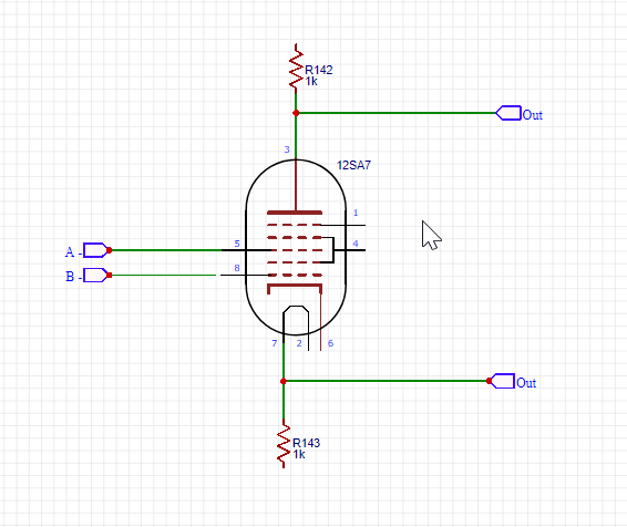

Mixer tubes, like the 6BE6, are designed so that the 2nd signal grid operates after a virtual cathode again, due to the positive shielding grids around it that absorb grid "reflected" electrons and prevent the 2nd signal grid's field effects reaching the cathode. Giving a product result. What is needed for an audio "mixer" is a sum result.

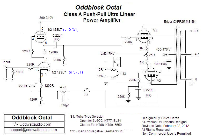

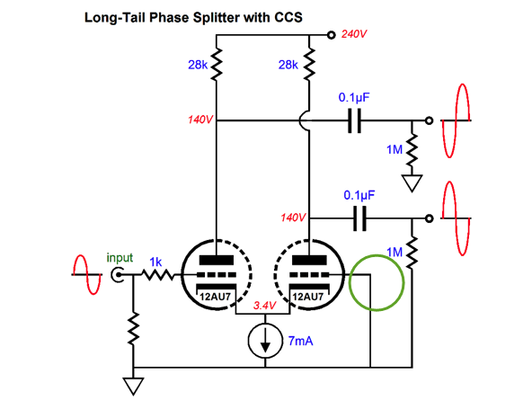

The plan is to build a small 25W practice bass amp with two inputs (One for a USB to play tunes to) so I would replace the 12SL7 shown in the KT88 with the Long Tail splitter and the second input would go where the green circle is. I realize this will require some modification, any advise would be appreciated I have a 12AX7 would that work well? I am also not sure what the CCS is doing for the circuit here.

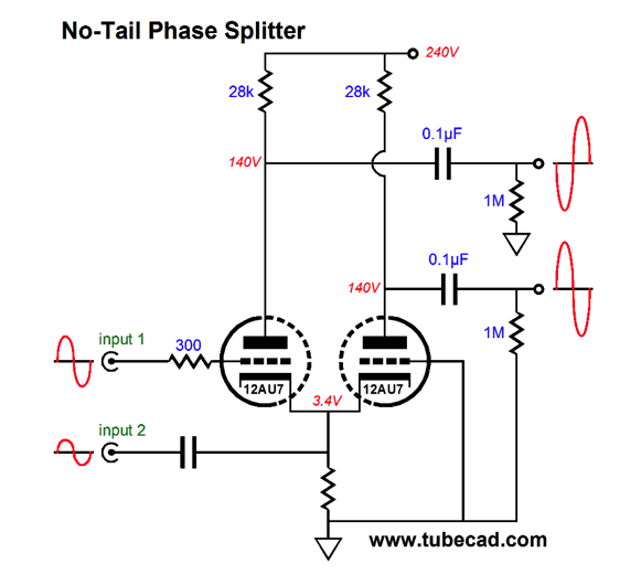

There is also a no tail splitter, it says "We could replace the constant-current source with a common cathode resistor and use a coupling capacitor to attach to another input signal, with the same phase, but half the amplitude." Which may actually be good because I expect the USB output circuit board (The unit I have comes with built in preamp) to be much stronger than the bass guitar input. In any case I will have to build a preamp at some point. Was looking at the Ambelic F-2B.

Then use two resistors, like 99.99% of audio mixers do.
Yes, that app-note does show an audio mixer. The boys in the lab must have been out of good ideas that day.
Yes, there's a whole field of Analog Computing to plagiarize from. But to get a "Sum" (what we call mix) they use two resistors. They may add an op-amp to reduce interactions and preserve precision gain; that's moot for two user-controlled inputs (diddle knobs until happy).
The Cathodyne depends on NO current escaping the Plate-Cathode path. The Hexode has very significant current in G2 G4.
The Cathodyne's heart is a Cathode Follower. The cathode follows the input. Now apply two inputs. This becomes like a worker with two bosses. Who to obey?? (I am working a crew on my house, and must keep my mouth shut, remember that the Boss who I hired has to give all the orders or the workers get conflicted.)
Design your amp around readily-available tubes. Not tubes you "have". Many lucky-dip tubes turn out to be bad. If good today, what when it finally fails? (True, the 6BE6 will probably be available for your lifetime.)
If you want to use the Oddblock amp, do not try modify it by taking out the 12SL7. The negative feedback goes to that tube. Now you have to refigure all that. Unless . . .
If you use a long tailed splitter, the point of a current source is that the 2 phases will have the same amplitude as long as the plate resistors are matched. Using a resistor in the cathodes requires you to use un-balanced plate load resistors, and you should tweek that for every tube you put in there, even if they are the same type.
The Oddblock has a current source in the output tubes. If you use a long tailed splitter to drive the output tubes, then you ought to use individual self bias resistors and individual bypass caps on the output tubes cathodes (eliminate that current source). Then the negative feedback should go to the grid of the right hand splitter tube, and the signal input to grid of the left hand splitter tube.

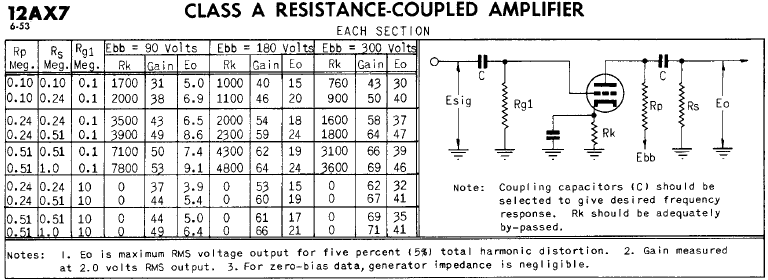

Well, let's look in the back of the book, as I agree Leo probably did. (See Attached.) His plan does not match the suggestions. Mis-copy? Cut-and-try? We will never know.
But these suggestions are NOT any *specific ratio*. They cover a 10:1 range of resistances.
