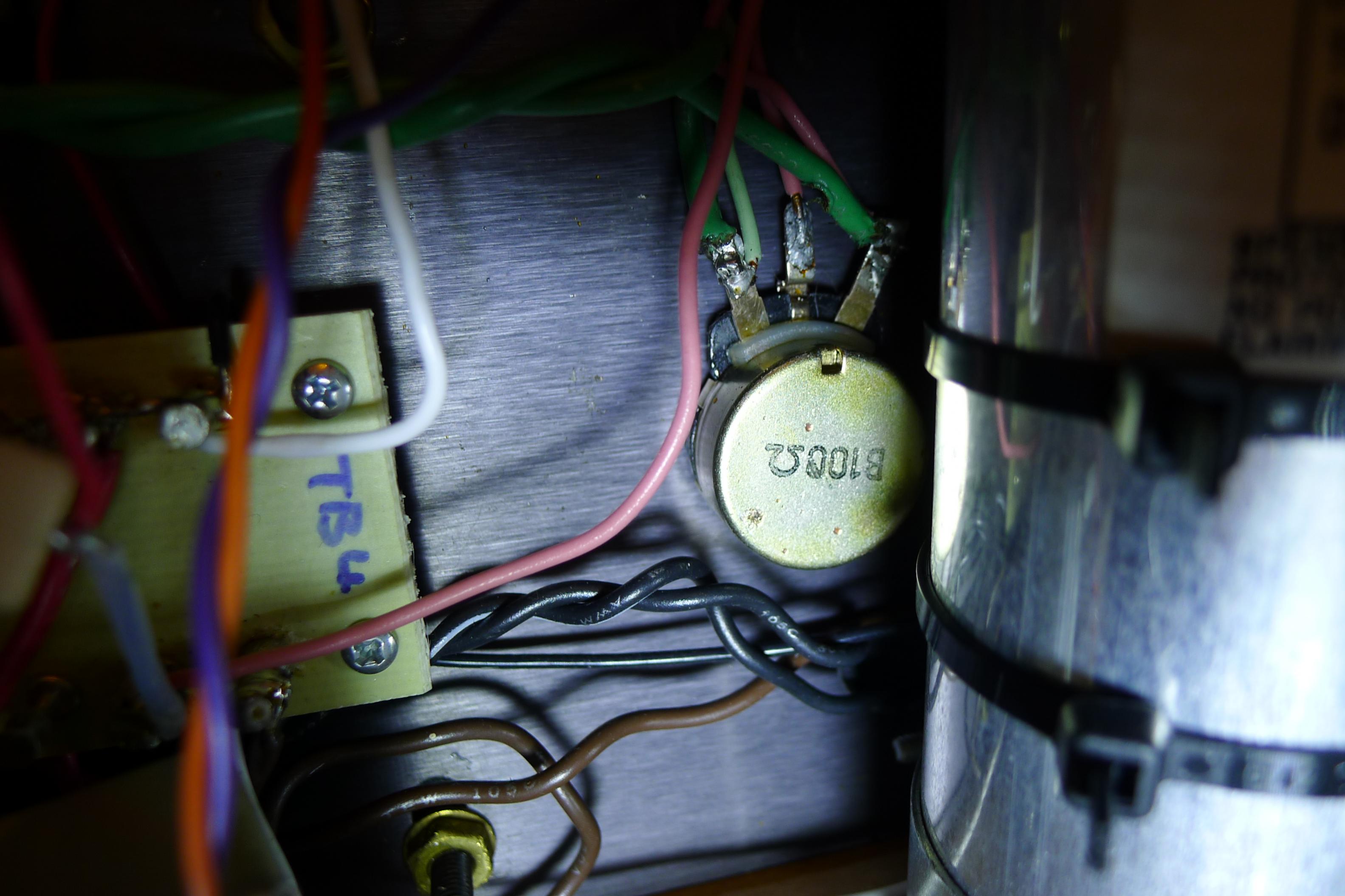

Excellent response thanks. The original now scratchy pots supplied by Ron Welbourne were 100R 5W according to the parts list. This seems massively overrated as most pots I have been looking at are 2W at best.
Whats you opinion on this?

The filament only has 2.5 volts across it for the 45... I would be happy with a 2W pot no problem.

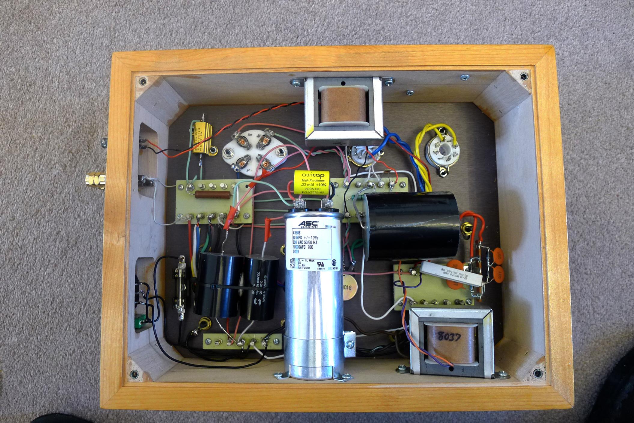

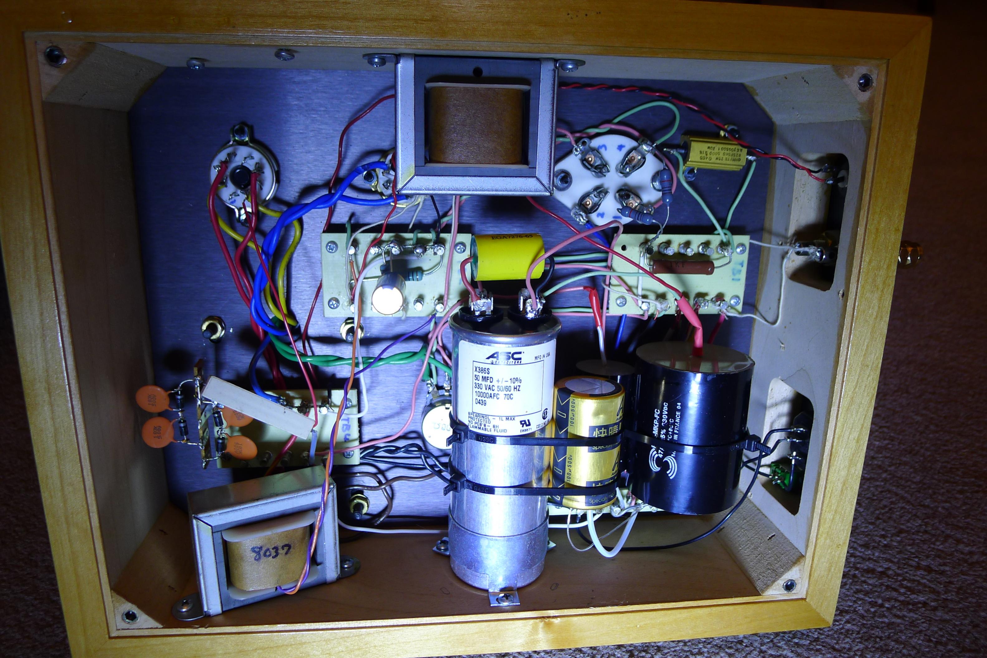

OK, here are the pictures of my amp as received and after Slawa of SW1X had worked on it.
When I got it, the solid state rectifier was in operation and it sounded mediocre at best. Slawa reinstated the valve rectification and added some other bits (capacitors?). He was pretty damming of the quality of many components particularly the bits in the SS rectifier.
Anyway now it sounds brilliant, aside from the scratchy hum pots.

That was a kit.
I'd genuinely like to see a schematic of the mods, it looks quite interesting! The DRD was always a funky design, not in the overall idea, but in the way it was implemented by Ron.
That was a kit.
Hi
The mods were carried out by Slawa at SW1X.
SW1X Audio Design Technology | SW1X Audio Design
Slawa's main problem was the use of an SS rectifier. All the parts for reinstating the valve rectification were present so he got it working with a "better" valve, a vintage 5U3C. He couldn't believe the cheap rubbish components in the SS rectifier and described it like having wings but staying on the ground. He also played with capacitors. Sorry, I don't understand much more than that.
Initially the amps hummed to the point of (my) distraction through the speakers. That is all but gone now after the mods, and its sounds absolutely magic with vintage 45 RCA valves through my open baffle speakers.

OK, have bought a pair of Alan Bradley 100 ohm pots (2.25W) to replace the scratchy ones in my amps. All good so far, but I would like to also do the mod by installing Alan Bradley 10 ohm resistors in parallel to the potentiometer tracks. Here is where my limited knowledge of electronics rapidly runs out.
