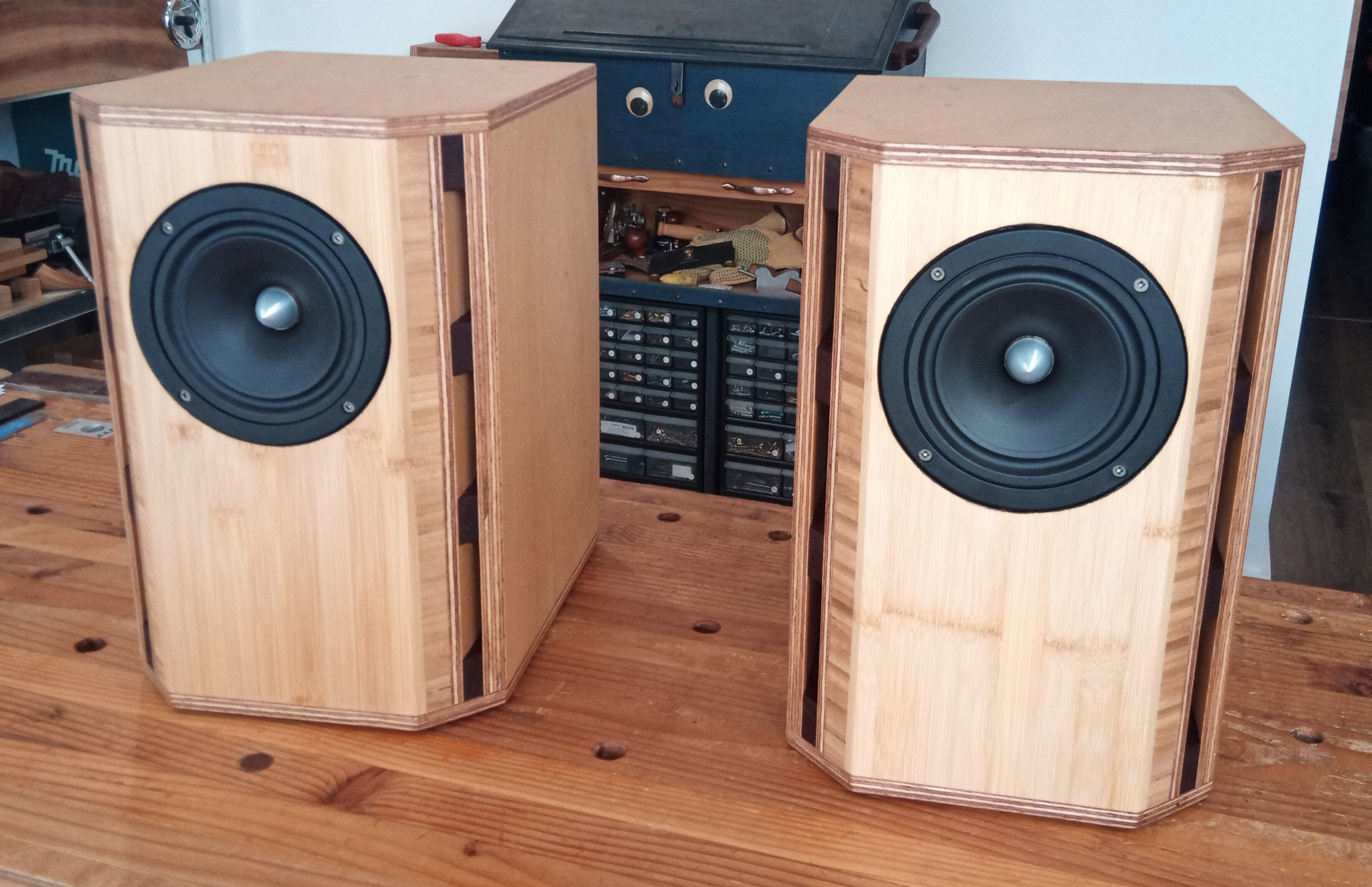

I ended up just going ahead and taking a punt at building a quasi aperiodic / MiniOnken type cabinet for the W5-1611SAF drivers after doing some more simulation and they have turned out fairly nice. After a bit of equalisation, there isn't really anything problematic with how they sound.
Ended up with about 19L internal volume, give or take, with six 8x1cm ports of approx 21cm length (ending about 5cm from the back of the inside of the enclosure and accounting for the length lost cutting the front chamfers). Front panels are IKEA bamboo 'butcher block' chopping boards (3cm thick) as I couldn't find decently priced bamboo ply in Australia, everything else is cheap 12mm 'hardwood' plywood (appears to be mostly pine with thin hardwood veneer). Decided to go down the BBC/Harbeth-style 'lossy' internal damping path instead of doing bracing like Dave recommends (primarily out of laziness) so a couple of layers of automotive butyl damping material on the sides/top/bottom, and a bunch of felt, foam, and melamine sponges on the front and back panels. The melamine worked really well in some Karlson-style enclosures I built recently - thanks to xrk971 for that idea!

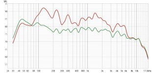

I've attached a couple of frequency response plots (from REW with 'psychoacoustic' smoothing) - the red line is the original response and the green is after I equalised it to approximately a Harman curve as a very coarse initial test. I believe a lot of the variability in the original response is room-related as they are in a very suboptimal location - near ceiling height on a floating shelf, not far from room corners, in a long and narrow kitchen full of irregular hard surfaces with one side almost entirely glass). I had plenty more SPL than I needed so sacrificed a fair few decibels to get a flatter response. The treble dropping off a cliff after 10k is something that I knew was coming given the drivers used and which surprisingly isn't all that audible to me when compared to other speakers I've built that don't roll off as quickly.
Anyway, hope this helps anyone who might want to try a similar thing with this driver in future. Can definitely recommend!
