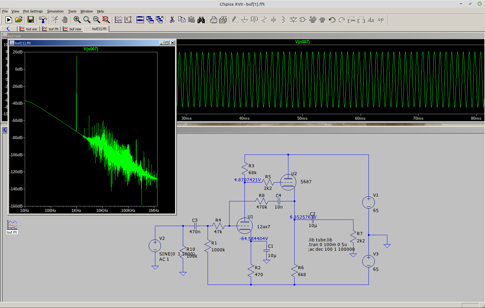

Having looked at the LTP again it has a problem in that only one output is connected to the FB, the other cathode follower is not included - so the distortion is higher - not very symmetrical and complicated. A simple mosfet would be better.
I think koifarm suggestion is much better and drive the module single ended.
The ECC99 is low gain and does not allow FB very much. I changed the first stage for a 12ax7 with distortion is .2% at +/9V input 2k2. The only thing is you would have two channels on one board.

Aren't we back where we started? FYI...
In post #14 I posted a single-ended (unbalanced) line stage using a single 6DJ8 per channel, about 3X gain, with low THD.
It would also be possible to use a single 12B4A triode per channel (unbalanced, single-ended) with no NFB and no output buffer.
In port #19 I posted a 6DJ8 differential stage with shunt NFB applied balanced (equal NFB to each side of the diff pair).
It would also be possible to make a diff pair using 12B4A triodes, which would give you about the right level of gain without NFB, and would not need output buffers.
Both are basic 'building block' topologies using triodes. I didn't invent them. I'm showing them for informational purposes, because it looks to me like they would work for you in this situation. There's certainly room for modification, refinement, improvement.

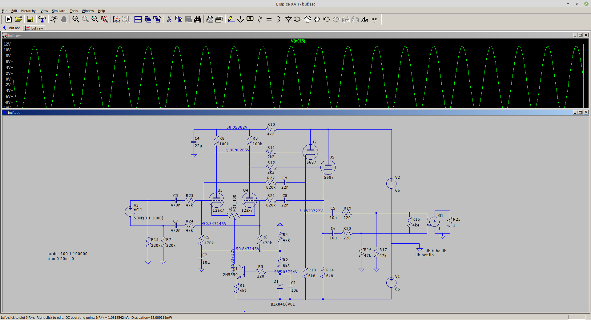

I do have fairly long cables between my preamp and power amps (about 8 meters), so I would like to keep balanced inputs and would also prefer to drive the Purifi module with balanced, but this is perhaps less important.
Would using a circuit like post #71 and making it fully symmetric (addling NFB from U2 cathode to U4 plate, and adding negative input signal to U3 plate) work ok?

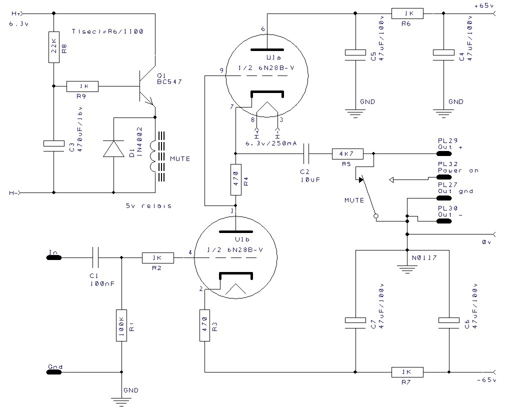

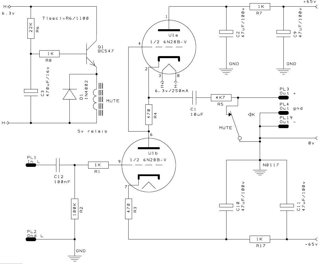

Schematic latest version with 6N28B-V tube in picture below.
For 6n6p/ECC99 tube change pinout and R3 and R4 is 1K.
C1 can also smaller 4,7uF.
For balanced use 2 times the schematic one for + signal and one for - signal.
You can use one mute delay with two contacts.

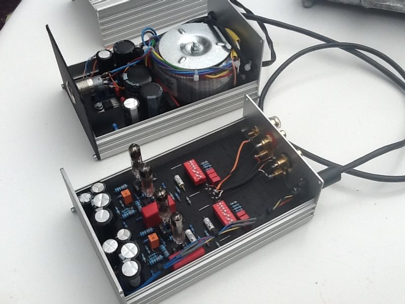

@Koifarm - thank you for posting the schematic.

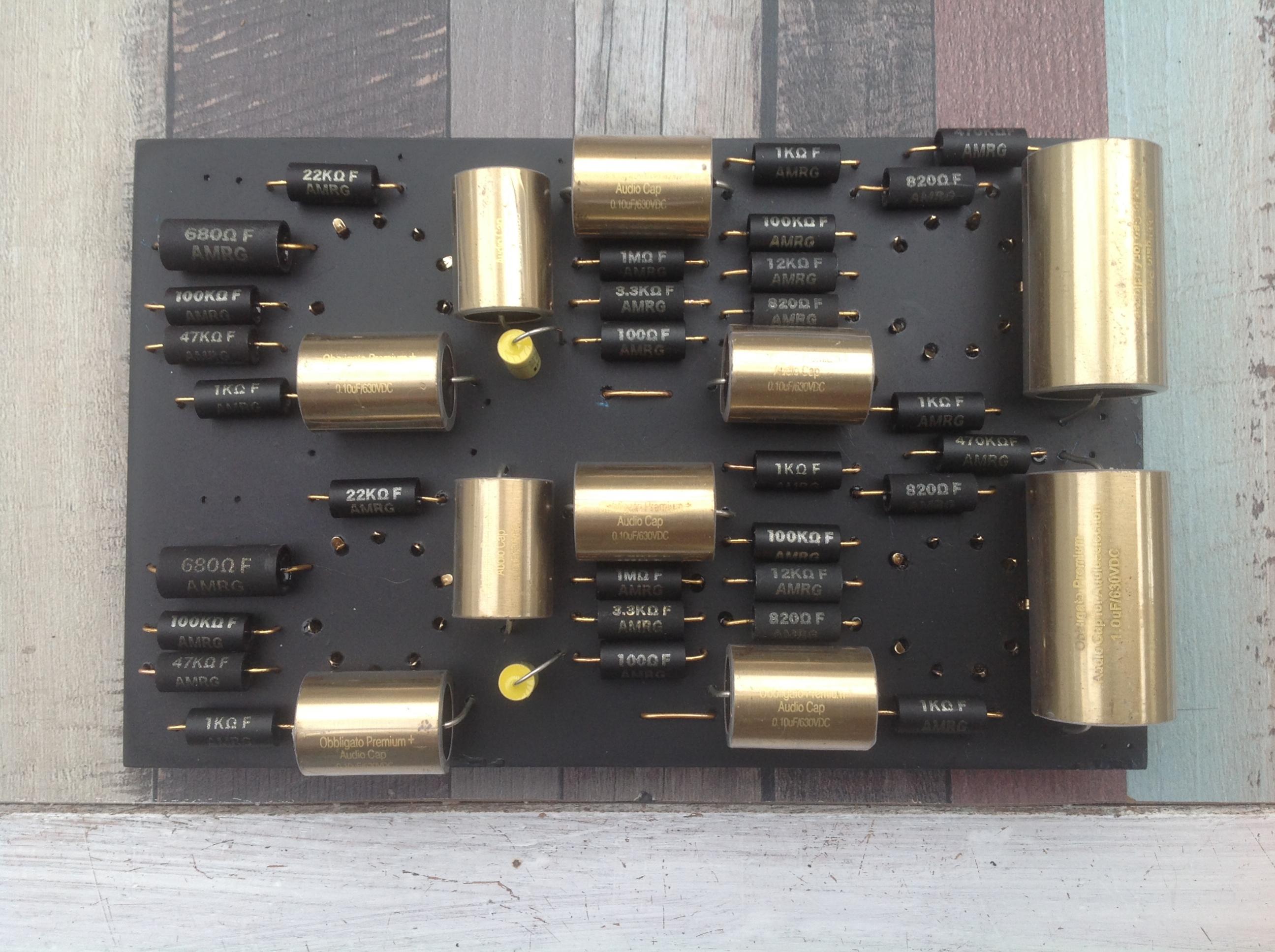

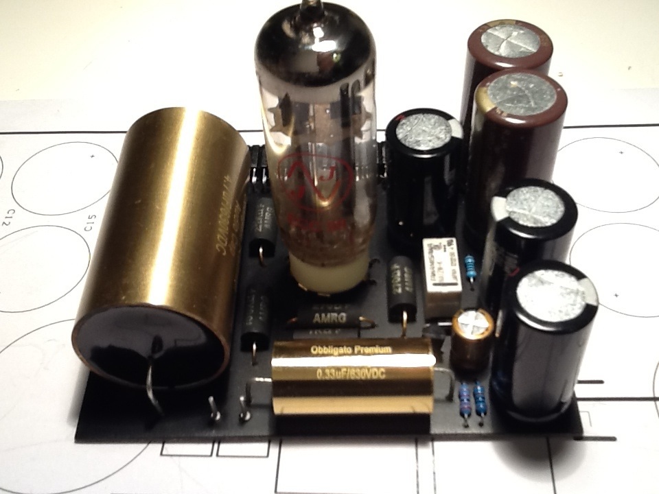

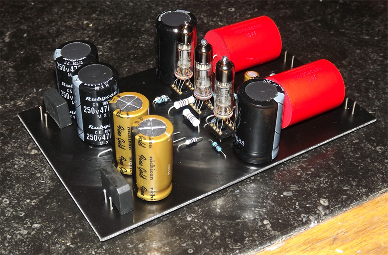

I noticed some nice looking capacitors in your board photo. What kind are those?
Obbligato capacitors and amtrans resistors.
You can solder them direcly to the pcb or solder them to a 8 dip socket and put them in another dip socket on the pcb. The tube last for at least 10.000 houres.
