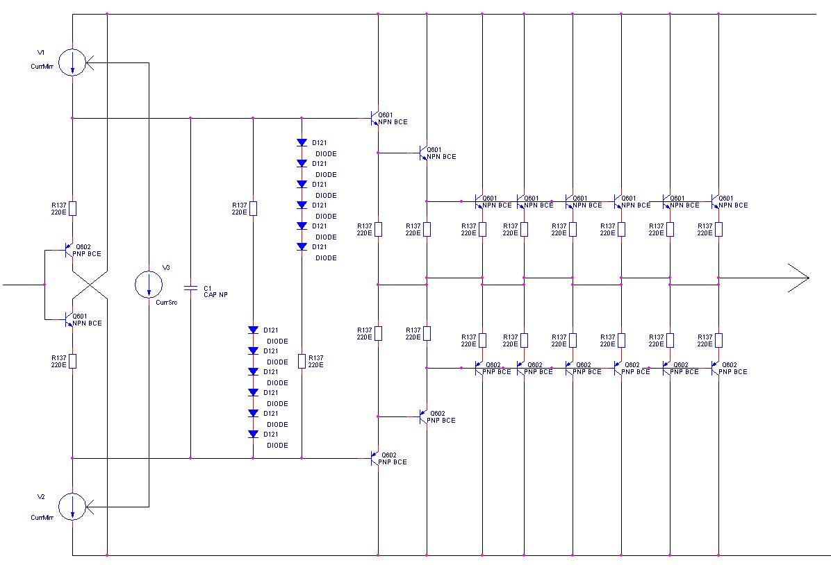

Help with transistor amplifier output stage?
Q7 "1041" is a mystery. I find no such part in web searches. Only a JFET, not a (enhancement mode) MOSFET will work in this position, except that no JFET is good for 130VDC. If you use a typical MOSFET here, it is biased completely off and no current will be conducted by Q8 and Q9, but we seem to have too much current so that's not the problem. Never the less the problem may be related to Q7.
I assume you realise this amp has no gain. It is simply 4 stages of Emitter follower. There are other dubious design features but at least you provided a schematic. Problems like this are usually caused by wiring mistakes and bad assumptions.

I've made a very rough and haphazard scetch to understand the (nonamplifying) endstage with the twisted and curled temp-diodes.
All boiles down to the very current source.
Indra is right, but serves better targetting.
What's available to Unimog considering low Id dep mosfet's to tackle the 'mystery 1041' ?

The amplifier now appears to be running well with Q7 temporarily replaced with a potentiometer. So the depletion mode mosfet seems to have been the problem. Now I am concerned about what else was changed before the amp made it to me, so I am looking through the operation of the rest of the circuit. It can be fully powered up now, which has improved test conditions a lot. I appreciate the recommendations for an appropriate fet and will set up a little test circuit for it. If I run into trouble with that circuit I will post again. Thank you all for your assistance!
