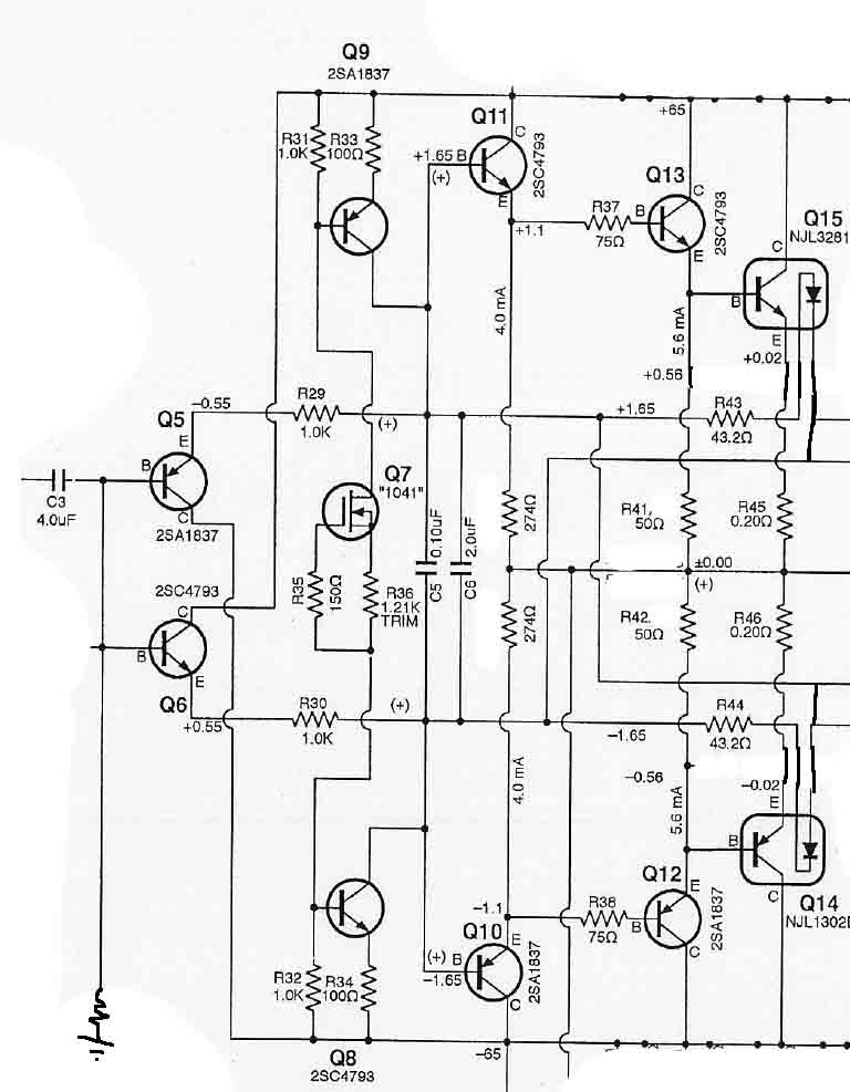

I'm having rather a lot of trouble getting the transistor output stage of a hybrid power amplifier I have working. I have included a snapshot of the output stage.
The output transistors are turned on to the point that even with very low rail voltages they conduct enough current to open the power supply protection. I can get up to about 5V (+2.5 / -2.5 VDC) on the rails and make some measurements in the circuit.
As rail voltage increases, the voltage on the output transistors' bases maintains a level at which the output transistors pass more and more current.
By using a resistor to bleed some voltage from one or the other rail onto the base of Q12, Q10, and to some extent Q8, the associated output transistors can be turned more on or more off. This leads me to think output transistors are good as well as Q12, Q10, and maybe Q8. I did replace Q5 and Q6 which had no effect.
At 5VDC between the rails, voltages are mirrored between halves of the circuit. Voltage measurements are below:
At Q14 base: -0.63V
At Q12 base: -1.28V
At Q10 base: -1.90V (the right side of R30)
At Q10 base: -1.26V
At Q6 emitter: -0.57 (stays there, to whatever voltage amp powered to; according to the schematic is should be the opposite sign with +0.55V)
I also replaced Q7, which was a DN2530 and did not appear to ever have been changed. The schematic doesn't seem to say what Q7 should be. Changing it had no effect.
What would you do next? Assistance is much appreciated. Please let me know if more information is needed. Thank you!
Schematic is mixed-up there. Both bases are the same and very near zero V. Then the upper emitter (Q5) has to be more-positive than zero V, and vice versa for the lower (Q6).
Q7 and R36 are *critical*. They should not need replacement. They should be checked for bad joints. While most bad joints will just shut-down the whole output, a floating gate (or different pin-out!) could drive it crazy.
I don't see how this was *ever* biased happy. We want something near six diode-drops between Q11 base and Q10 base. The plan as drawn (with obvious draw-overs) shows the one diode in each NJL3281 plus an unknown current in 43r, twice in parallel. Taking any reasonable guess for Q9 Q8 current we get <=1V bias *total*, where we want just over 3V, so "it should run cold". You say it burns-up.
You could TRY four 1N4007 diodes in series, pointed down, across C6. That would limit the bias to ~~2.4V and it should run cold, and "hoarse" at small output (crossover distortion). But that's at-best a check on what ELSE may be wrong.

Indeed, Q7 and R36 are a current source, mirrored through Q8-Q9 into the circuit. As said by PRR, very critical!R36 should set the bias, increase value to reduce output stage bias current.
My guess is a current of 1 mA through Q7-R31-R32 to start with, yielding in a load of 4 mA (max) for Q5-Q6. If something is wrong with Q7, you might have an increase of this biascurrent when increasing the rails, where a independend current was expected (what you experience).
Replace Q7-R35-R36 combo for a regular series pot and fixed resistor.
Voltage across this PR is 2*64=128V, current say 1mA.
Resistor 100k/1W and pot 47k/1W.
You should be able to increase rails to 'normal values' with the pot at max value. Be carefull with setting bias!

The bias circuit is not logical.
Current through Q5-Q6 is 1.1mA. Voltage over R43-diodeNJL is 3.3 in total according to drawing (should be ok for normal bias setting).
However, current through R43-diode calculates (3.3-0.7) / 43.2 = 60mA ???
Same value for R44-diodeNJL1302, summing to 120mA out from Q9 into Q8 ???
If R44 is a diode, it makes no sense at all.
No specs in datasheet about the diode in the NJL, single presumed.
Do you have a full circuit drawing available?

R44 and R43 are SB120 Schottky barrier rectifier diodes.
The datasheet for the NJL shows one diode.

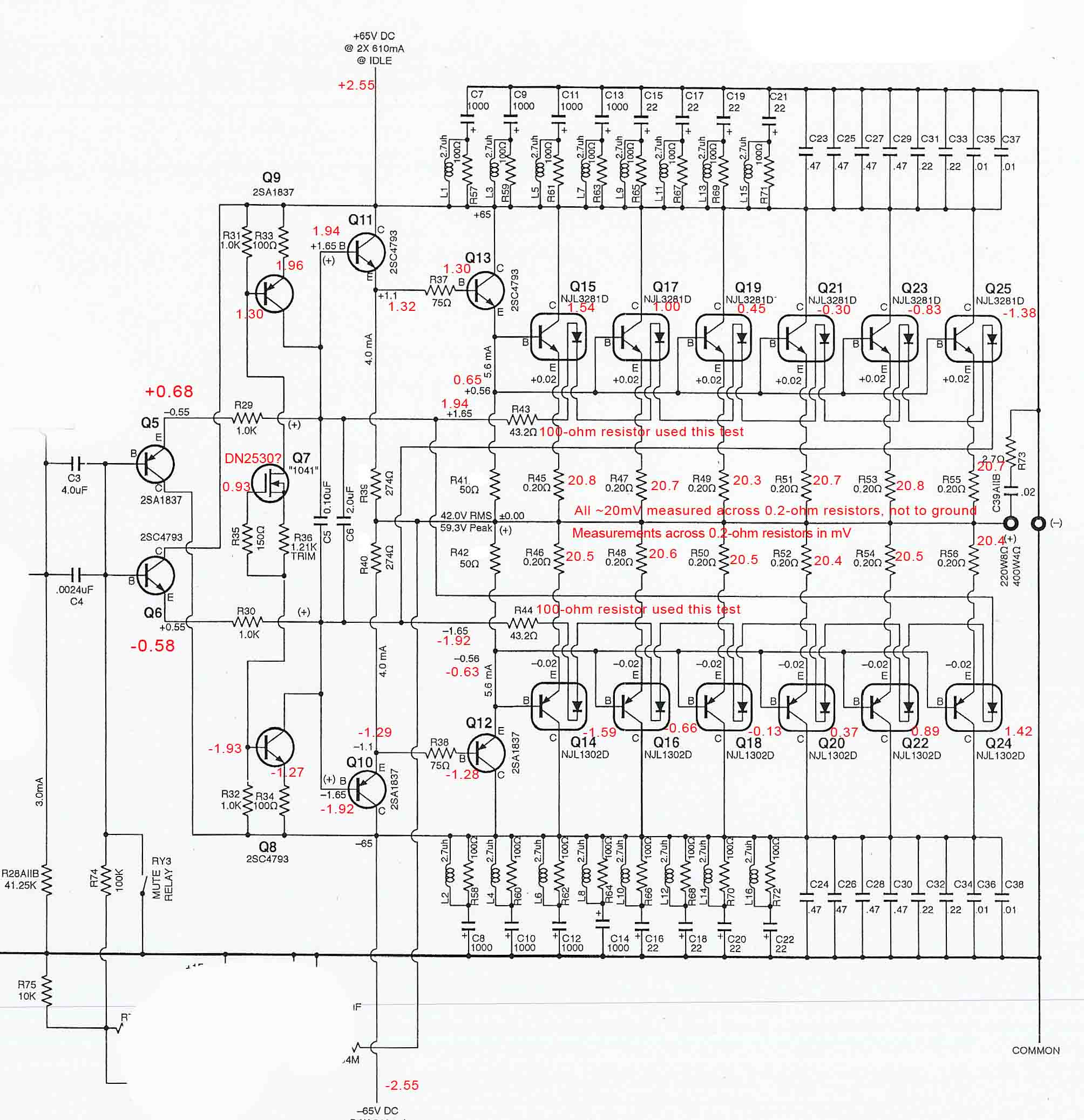

I have done some more work on this amplifier and have included some more information here. I have taken the below steps:
1. Replaced the diodes previously at R43/R44 with resistors. This had no affect on the problem.
2. Recorded the voltages around the circuit and attached them to this post. The behavior of all the output transistors appears normal to me. Am I missing something? Voltages at the integrated diodes in the output devices are included.
3. Measured voltage at the output transistor base with respect to ground and voltage across output transistor current sense resistors. Results are below:
Voltage at output transistor base with respect to ground / Voltage across 0.2-ohm resistor
0.548VDC / 0.001VDC
0.586 / 0.005
0.603 / 0.010
0.615 / 0.015
0.628 / 0.020
0.639 / 0.025
0.644 / 0.030
0.661 / 0.040
Overall, the circuit appears to me to not be successfully regulating the voltage at the output transistors' base as rail voltage is increased. The voltage at the output transistors' base increases as rail voltage increases and the current conducted by the output transistors appears to increase accordingly.
Any help given this information would be much appreciated. Please let me know if any additional information or testing would be helpful. Thank you all very much.
