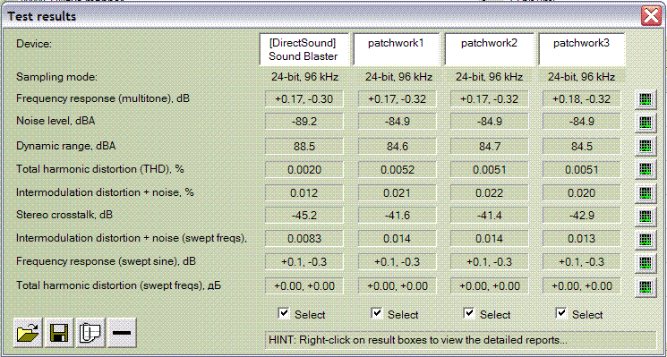

I just finished some high power tests with RMAA. I had to add another 1.5K is series with my voltage divider in order to get the voltage down enough for the sound card.
The input to the amp was 2.1 Vpp (.740Vrms). I had to use the dummy load for the testing. The speaker was way too loud and I don't think it could handle that much power (it's only rated 30 watts).
I measured the resistance of the dummy load when hot and it's 4.4 ohms. That gives ~108 watts into the load ( output= ~70Vpp).
Idle current was set to about 95mA and the heatsink was nicely warmed up.
Here are the results. The first test is the sound card. The next two are the amp at 95mA idle and the last test is with the idle turned down to ~75mA.

How should I interprete the results from RMAA? Should I take the sound cards measured distortion and subtract that figure from the measurements made through the amp?
I'll give it a try.
What are the possible fixes if it proves to be unstable with the capacitor?
AndrewT said:no.
use an analogue scope to look for oscillation in part of the output waveform or for excessive peaking of the leading edge of the squarewave.
Sorry, that was a different subject. I'm refering to the results from the RMAA tests that are posted above, not how to check for oscillation (I already know how to do that).

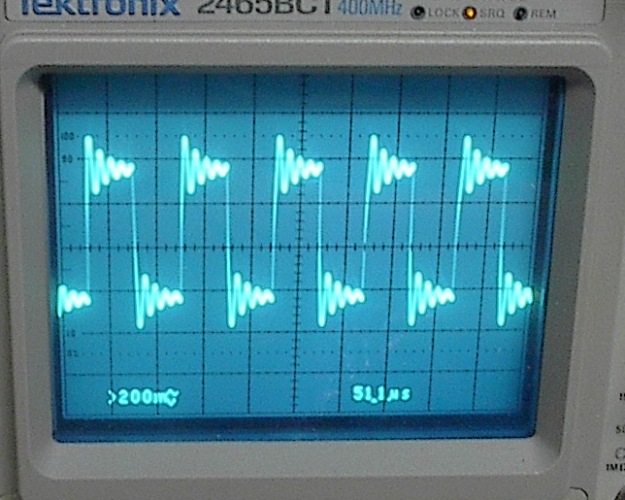

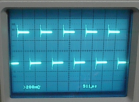

I ran the capacitive load test with the sine wave output from the RTA tone generator on the PC. The square wave output is not clean enough from either this program or the other tone generator I have there - one from NCT.
The sine wave output, once the capacitor was connected, showed no difference at all.
I just re-ran those tests using the clean squarewave output from the scopes calibrator. There is some ringing. This is as detailed above, with the 2.4uF in parallel with the 4.4 ohm load.
Here's how it looks at 1Khz:

John, my best estimate is that it is ringing at about 100Khz. I wonder if this an interaction with your output inductor and the capacitive load? It would be interesting to see if it sims the same way.

John, It would also be interesting to see how the amp operates without the output inductor circuit. Both in sim and reality.

that's where I get stumped. I can identify the ringing even when the test square goes through the input RF filter, but getting a reasonably shaped square is difficult without massively increasing the value of the Cdom cap and that kills the sound.
Yes, low impedance and parallel capacitance (=real speaker over narrow frequency range) is a demanding load.
How low does the C need to be for the ripple to disappear?
How low does the C need to be to eliminate the peaking of the squarewave?

Don S said:John, my best estimate is that it is ringing at about 100Khz. I wonder if this an interaction with your output inductor and the capacitive load? It would be interesting to see if it sims the same way.
Don S
The simulator is not really good for this kind of thing, but a slight ringing is evident. Removing the output inductor in the sim tamed this.
Is there a cause for concern though? This ringing is not full blown oscillation, and this is a very tough load to drive.

I removed the output inductor (and the resistor it's wrapped around) and replaced it with a short wire. This made a slight improvement to the ringing. No much though.
I added a 3.9pF cap (cheap disc ceramic) parallel to the feedback resistor (C14 in the old schematic). This made the ring much worse.
I reduced the capacitor to 1.2Uf by putting another in series with the first. The ringing was cut by more than half - it was barely noticeable at 1KHz and very much reduced in the 10K and 20K.
This ringing is obviously at 40K, as I have 2 ripples at 20K.
Using the .68F cap that I originally tried showed next to no ripple at any frequency.
