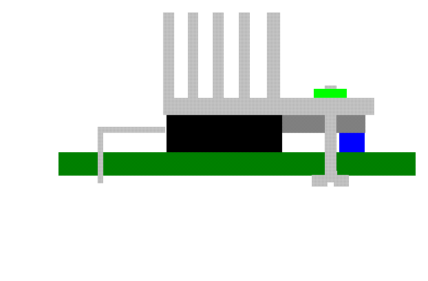

with that hole you have options.
You can bolt the To126/220 package to top side or bottom side.
On topside an insulating spacer and a small heatsink under the package for To220, or heatsink on top for a reversed To126.
In any case, a similar hole for every medium power device is very useful.
AndrewT said:Hi,
I have it for heatsink to sit on top, facing up. That way I don't need to change the pin routing and worry about side clearance for the sink.
I saw the space there, so might as well use it up.
EDIT: Andrew, do you think the 2 ounce copper on the top would provide enough cooling for this VAS without a heat sink?
I wouldn't use the PCB for cooling. It might short out.
What is your estimate for the PCB dissipation? 100C/W or 1kC/W?
But you like to run big currents and that probably needs a real sink. 20C/W does not take much space.
AndrewT said:I wouldn't use the PCB for cooling. It might short out.
The clip on types are between 22 and 20K/w and pretty small, you may even use a piece of 1.0 mm aluminium sheet, about 15 x 25 mm will do.

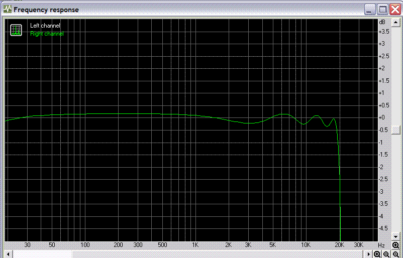

Don S said:John, nice distortion numbers. I saw frequency response but no frequency limits for the numbers. Also what was the amplifier load and power output at when you tested?
Don S
Load is a 4 ohm dummy. Power output was low. I will run more tests later at higher output power (a little nervous about burning up this new card).
Here's the frequency response graph for the 4th test. It matches the sound cards response almost perfectly.

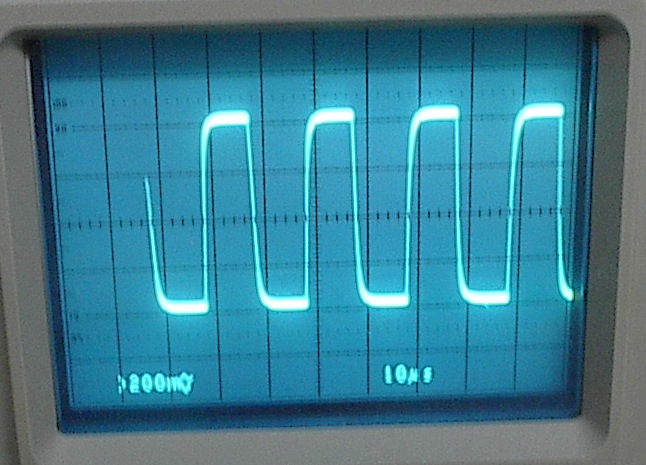

I did a very brief test at 40KHz back when I did the the 20KHz into athe dummy load. This was at the 200mVpp output from the calibrator.
Here it is:
MJL21193 said:
Hi Pete,
Here it is:
You have to drive it to a large signal level, say +/- 30-40 V peak, however, probably not a good thing to do in real hardware.
Small signal is not a true test.
Pete B.
