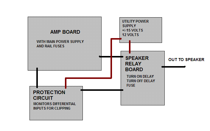

I have an idea for clipping and short circuit protection for this amp. I have studied Rod Elliot's SIM circuit and have adapted it to switch a normally closed relay that will interrupt power to the output relays.
Simulation of the circuit shows extreme sensitivity to clipping and short circuit. It monitors the differential pair for differences, and has no impact on the distortion level of the amp.
Is this going too far? His original circuit drives an LED to give a visual indication of clipping. This version would cut the output to the speakers.
Here's a sketch of what I have in mind:

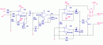

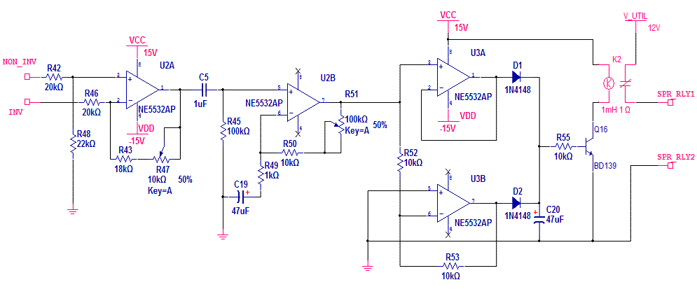

Here is the (slightly) modified circuit. I could use the NE5532's or a single quad. Rod advises that better performance results with a higher quality op-amp.
There is adjustment for sensitivity and will need to be calibrated. C20 could be changed to increase the amount of time the relay stays open.

try it, but I see 8A @ 250Vac on the case and datasheet shows 8A @ 125Vdc in the spec.
These only apply to resistive loadings.
I think your rail fuse/s will blow first if they are correctly rated.
Will the output devices survive that length of time.
Don't take the risk with your target performance with a speaker fuse.
This protection circuit for catastrophic failure prevention, not something that's going to trigger on a regular basis. The amp will deliver 170 watts into 8 ohms before clipping. This is well above the input sensitivity of the amp, so there is some leeway there.
It may be completely redundant, that the fuses will do their job and blow, but it's not a big deal to build and it can do what the fuses won't do - prevent clipping.
The output devices are pretty robust. Still, the protection has to react fast enough. Any ideas on making it detect an existing short before power up of the amp board?
If the protection circuit works as expected, I won't use a fuse on the output.

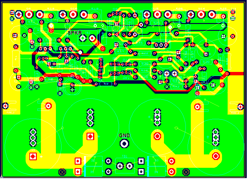

OK, another kick at the ground plane cat. This time I've cut out the two separate grounds. I've added terminal blocks for the AC input and the speaker output.
Am I getting closer or is this just as bad as the previous schemes.
