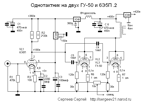

Hello
I like these amplifier a lot.
But because is posted in Russian website even if I translate with translator hard to understand everything.
It would be stupid to start a project and I do not understand all.
Îäíîòàêòíûé óñèëèòåëü íà ÃÓ-50
I would like to ask some help from Russian DIY-ers.
Even at the schematic some writing I do not understand.
Also there is some type of transistor, I don't know what type or part number.
Also I attache the schematic.

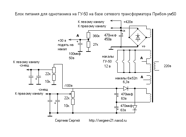

If I understand well the 420V goes to left chanel and right chanel
Also the bias goes to left chanel and right chanel BUT on the schematic each chanel has two bias- do I have to connect that two together??
There is 30V at the PS, I have no idea where it goes.
Any help it would be great , otherwise I have to look for other GU50 project.
These would be great with the 25W Edcor OP transformer.
Thank you very much

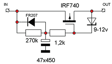

"Transistor" is Filter+delay turn on circuit.
See attach UZF
Yea, you are right.
Yes, you have to connect bias inside of each channel together. Also bias for channels separated.
+30V applayed to filaments for AC "Hum-m-m!" noise cancellation. Just solder together points "A" on PSU schematic.
I'm sorry, that PSU schematic for 1xGU50 per channel. 🙁
For 2 tubes in parallel needs (22 k pot + 10 k resistor + capacitors) for separate trim bias each tube in channel.

I have great respect for Russian DIY, but I see some issues with this schematic.
- Max G2 Voltage for GU60 is 250 V
- No grid stoppers anywhere, and especially no G2 stopper in the GU50's
- Surely is 6e5Π enough to drive 2X GU50 grid capacitance in triode?

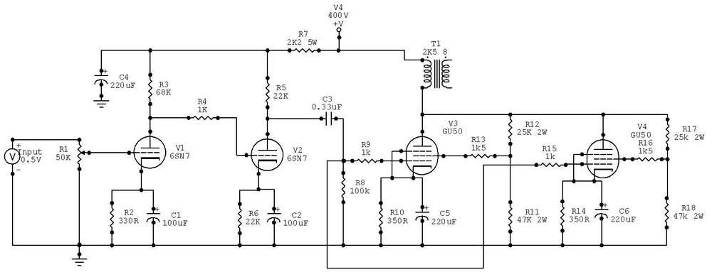

Anyway I tried with 6e5p driver into gu50'triode too. It works very well and sounded excellent on my foster high-eff horns. Unfortunately I needed extra power to feed my 89db kef speakers hence the switch to pentode.

Later I'll want build that amp (I have most of the parts) for that BUT to get back to tube world I want to start with a smaller amp. The last 10 years I built only SS amps. Before I did tubes to but 10 years a lot of time. To start with a GM70 1KV a bit dangerous.

yes, 2xGU-50 would be able to increase the power, but then I would need a different OPT (lower pri impedance), matched tubes, higher current requirements from my PT, a higher Miller capacitance for the output stages which will load the driver stages, a new and larger chassis to fit an extra tube....
Too much trouble.
Pentode is just a wire and a resistor and some zeners.
Too much trouble.
really? you can use the same output transformer, just use the 16 ohm tap to connect your 8 ohm speaker and you have a lower impedance primary....the power transformer may have enough capacity already...the chassis may need re-thinking....
matching tubes? using fixed biasing, this is not really needed....what with individual biasing pots.....
so you see, it is not really extra trouble if you have the parts on hand....
the only extra i can see are 2 GU50's and sockets....
>> Unfortunately the bias voltage unknown here. Can be -100V? He use 63V capacitors.
This scheme is "voltage doubler" - it's not bad for small load. Capacitors has to be 1/2 output voltage only, also 2x63 V good enough for 100V.
>> I found another (improved version) of he's schematic at his website. He use choke and 3 transistor in each chanel. I have some choke at hand 30H 50mA probably that would be enough because only goes to the driver tube.
Probably he designed these PS to that schematic that is why one bias per one chanel..
"Best is enemy of just good" - any modifications and improvings may be keep for future? When you'll have working good amp already.
>> The truth is I want to keep those choke to my GM70 tube amp.
O?! Yes, GM70 is beautiful tube, but it has a bit too high anode voltage.
:xfingers:
>> If I use the first (not the improved schematic) basically I need 4X the red box parts 22k trim pot, 10k resistor some electrolytic capacitor bypassed probably 1uF MKP capacitor.
That is correct?
Yes, it is.

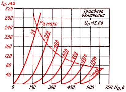

>> With the 22K set up the bias (he wrote each channel 100mA) That mean one GU50 run 50mA on plate or both 100mA on plate.
100 mA for each GU50 tube. Bias has to be something about -75 V (See in attach plate curves for GU50 in triode mode)

I also plan to build this project. I have a OT with the impedance 1200. Could be applied to such project? I already have GU50 and 6E5P. I also have 6C45P - could I use this tube instead of 6E5P?
For 2 GU50 in parallel , 1.2ΚΩ is correct! And it is a simple design, you can use any tube that can do 80 Volts drive signal with high current. 6C45P looks good, I haven't used it, but I think it's OK!

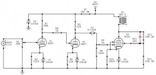

@Tony, if you read my post, I am using cathode bias. NOT fixed bias. I do not have another secondary on my transformer for bias voltage.
As for the OPT, it is limited a single 8 ohm tap.
As for the power trans, I could try to run it at max dissipation or exceed it slightly but at what possible risk?
So... before u decide to lampoon my reasons, please be polite and find out the real situation.
