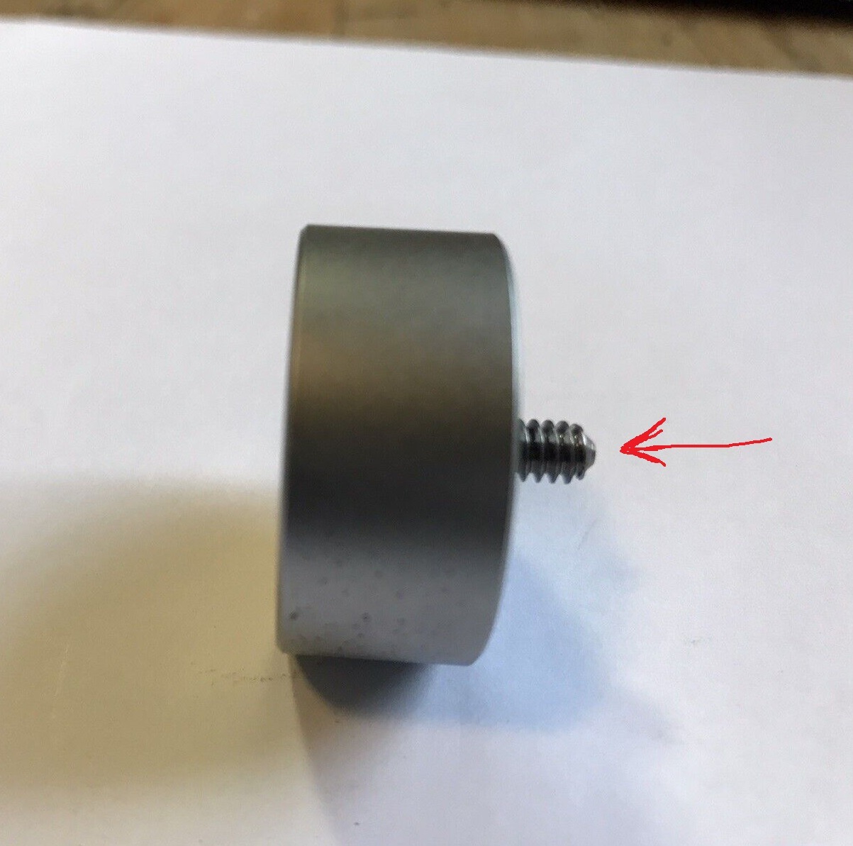

As per tittle need some help with this SME 3009 series 2 Improved counterweight
Yes I did search the forum and Google for hours and got even more confused
I have a project on stand by because I can't find any info about the screw thread size on this counterweight...
I am assuming that the tread is some sort of outdated British standard like Withworth or BA can someone help confirming this ?

Thanks rayma but the issue is getting a 3/16 BSW bolt to compare, I could check in my previous job facilities but I can only get there on Fridays so one week from today or I can buy one of ebay but $10 for 1 3/16 x 1" bolt is a bit bit on the high side...

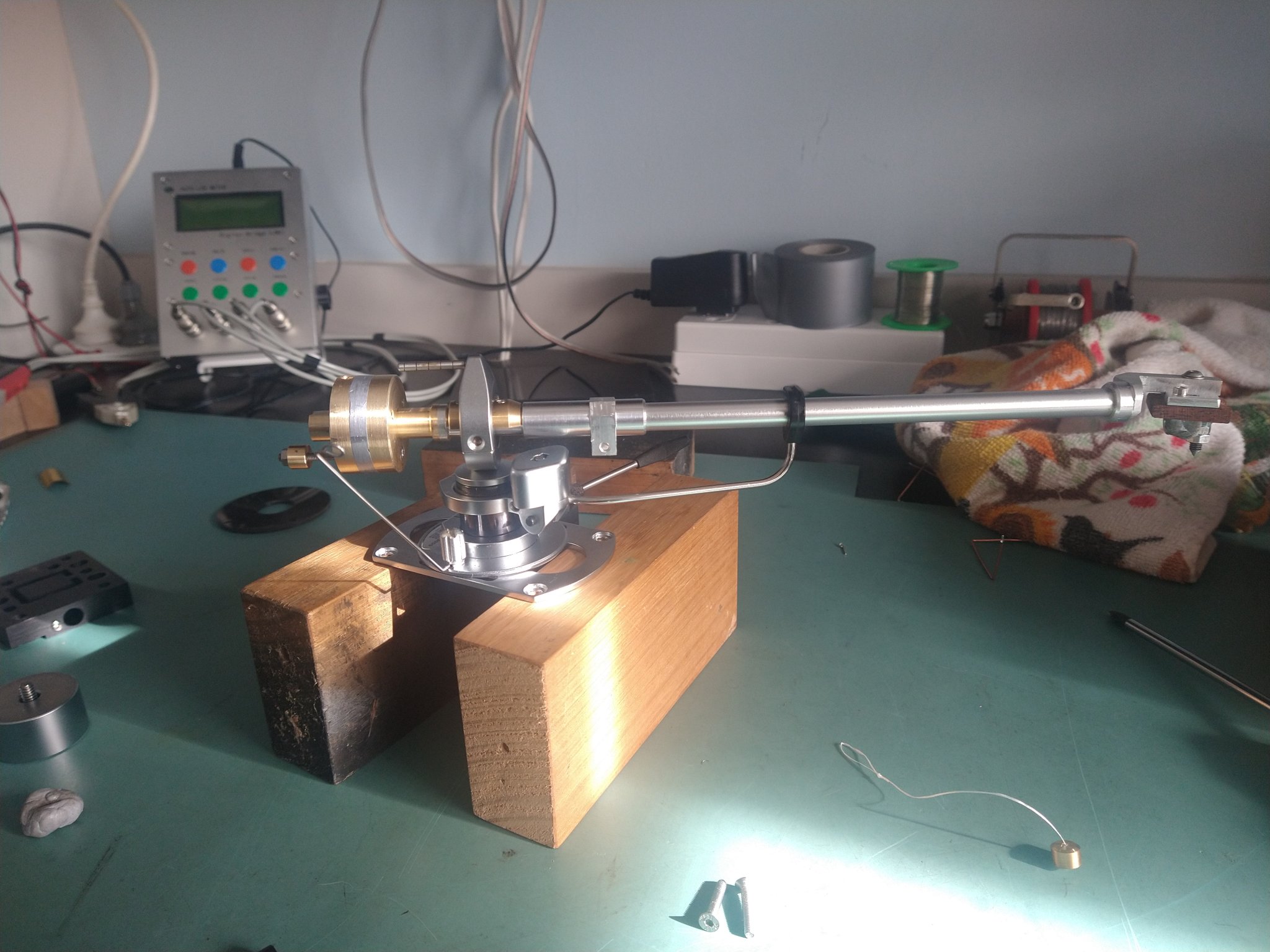

I repaired a similar damaged S2 improved but I removed the SME CW totally and made a new bearing yoke. The arm wand is an aluminium arrow shaft and the CW is brass and lead. The stylus tip is lined up coincident with the pivot so no outrigger CW is needed to maintain equal force on each knife edge.

Hello RS232,
Check your circle of friends and acquaintances, to see if there is a gun collector amongst them. If there is, find out if he owns a German WW1 Luger pistol. At the bottom of the grip there are two 3/16" Whitworth screws that hold the walnut grips in place. Borrow one of them and compare.
Sincerely,
Ralf
To warrjon; very nice job in that arm.
I'm keeping the CW spider because of the "decoupling" that it gives from the arm, also I replaced the plastic knife bearing with an updated steel one (had to lap it to fit the carbon tube).
Have to do a few more things to make it presentable for a picture but promise to update.

That modded 3009 used a brass knife edge, but steel would do the same job.

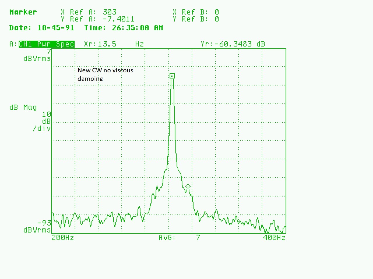

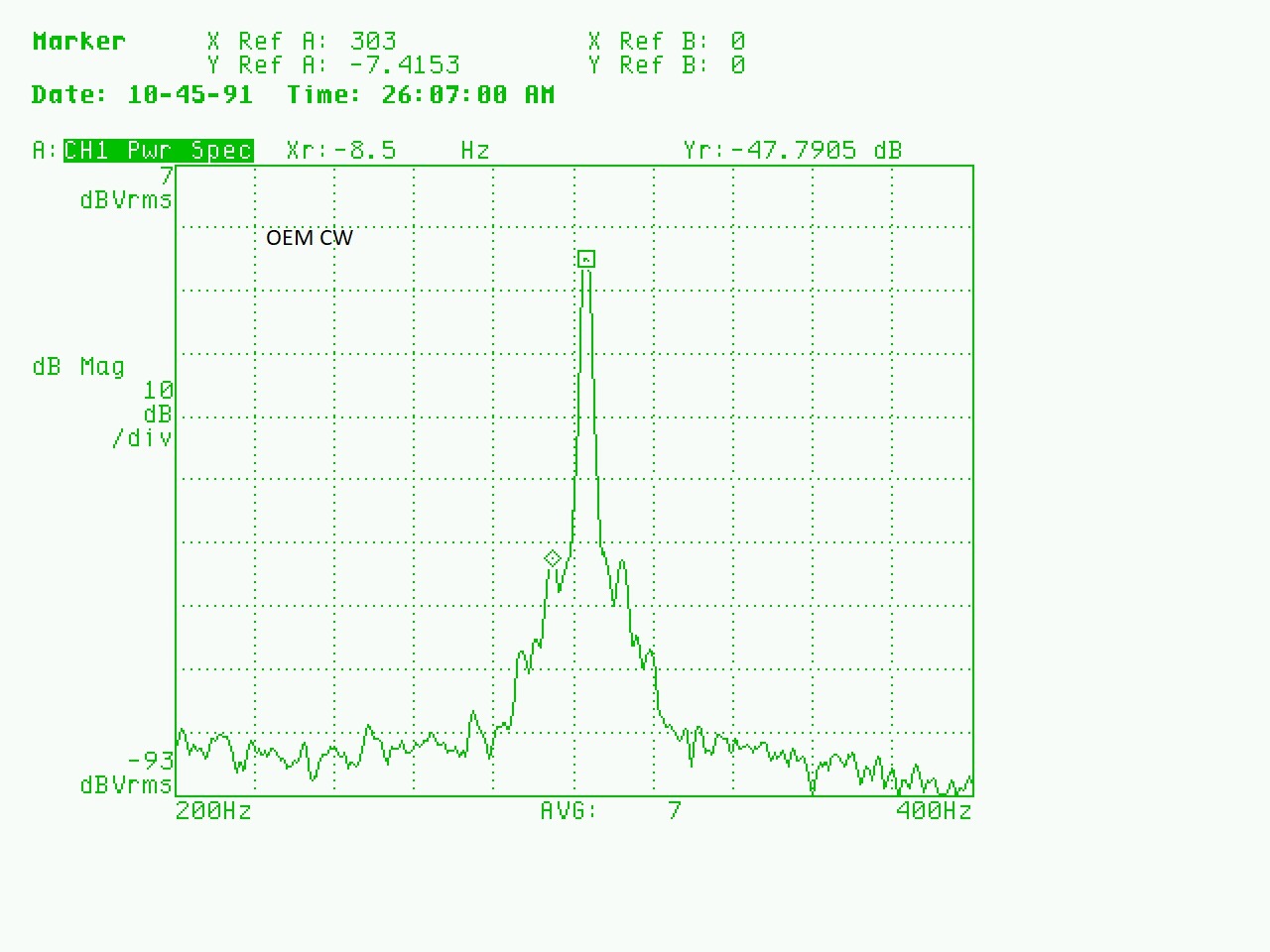

Another thing to consider if you are making a straight arm wand is to place the stylus tip coincident with the horizontal pivot like the Graham Phanton. Doing this will negate the need for the outrigger weight. The outrigger weight is there to counter balance the knife edge if you remove the counterbalance weight on a stock 3009 the arm will rock and have very little pressure on the RH knife.
If I were you I would remove the decoupled CW. These only work at ONE frequency and cause issues at other frequencies as they form a spring mass damper.
Here are measurements of my Technics EPA-100 with the OEM dynamically damped CW and a rigidly mounted CW and new stub I made.
These plots clearly show that with the new CW and stub the sidebands at 8.5Hz are almost gone. Yes this is audible, clarity improves.
