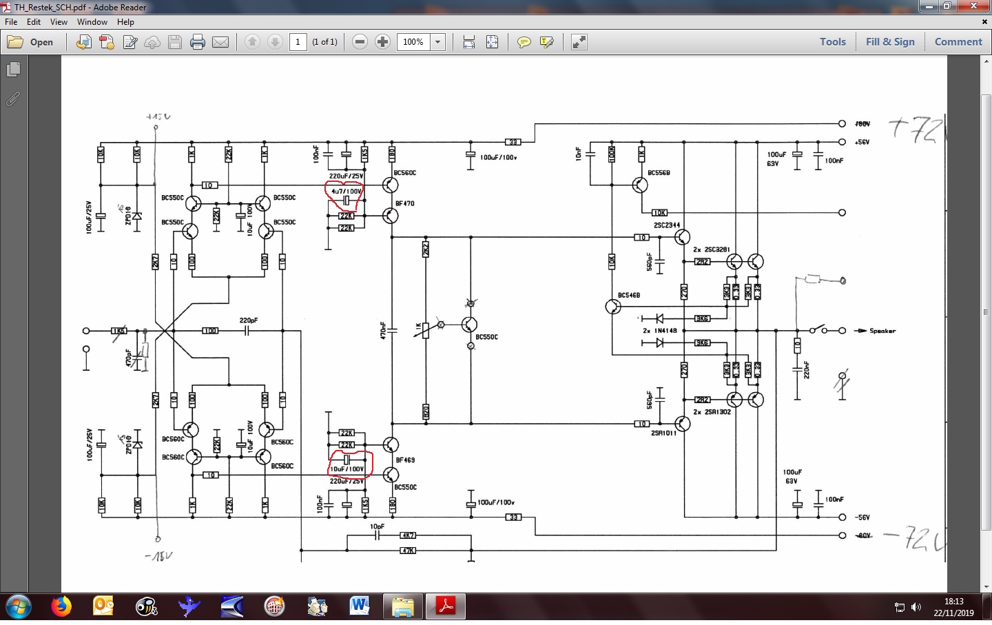

Hi guys I have a little problem: could one of you please have a look at the schematic hopefully visible here) and tell me if the elcaps circled in red should be the same or different?
I have a slight problem in that I recapped the amp and replaced like for like, with better grade caps (Panasonic NHG 105 degree instead of the original 85 degree Phillips). Both sides were 4.7uF 100V.
The new cap on the positive side (one in each channel, both channels) start bulging and lose capacitance immedicately.
The amp works fine and I can adjust the bias pot to 60mV (measured between positive and negative emitter) as suggested, but when measuring the trim pot there is 400ohms on one side and 600ohms on the other (bulging) side.
So my other question: Is the trimpot there to adjust the balance between the positive and negative side of the channel or does it adjust the bias current for both sides equally?
Basically, someone please explain this schematic to me...
Many thanks

Do you have any explanation other than reverse polarity? The resistors in-line with the trim-pot are different on each side.
But surely the caps are just decoupling caps to ground?
The trim pot sets the output bias current, and the voltage across all 4 of the 0.33R should be the same.
Caps are the right polarity. Are you mistaking the positive cap for the negative cap, and vice versa,
in their locations on the pcb?
ubergeek, I think you have solved my problem, I just looked at the position of the elcaps on the negative channels and they are both the opposite way, so naughty manufacturer/pcb etcher!
Rama, many thanks: which caps are right, both at 4.7uF or as shown in the schematic? Me thinks they should be the same?
The value isn't critical, its decoupling for the cascode transistors. If 10uF fits in both positions upgrade the 4u7 to a 10u for better decoupling that side.
Its an odd arrangement, the rail decoupling and cascode decoupling are linked. A better scheme would decouple the rails straight to ground, and decouple the cascode bases to the rails (not to ground), since the point of a cascode is to take voltage swing away from the amplifying transitor's collector, and in these VAS circuits the rail is the reference point for the incoming signal, not ground.
Two possibilities ... backwards or overvoltage.
Take a close look at the schematic ... notice they are shown in opposite directions... on the + rail the cap + ties to the transistor... on the negative rail it's the other way around - to the transistor. In that moment it's real easy to get one of them backward, even if it looks right to you. Also note they are specified as two different values .. 4.7u on the + rail and 10u on the negative.

I tend to agree about losing the 4u7 and 10uF caps - they are only fighting the caps to the rails and maybe reducing the amp performance. The cascode bases should be decoupled to the rails only.
And yes the bias circuit is not symmetrical. However it has a big flaw - if the trimmer fails open circuit the entire amp self-destructs. The base of the Vbe spreader transistor should connect to the wiper and also the upper end of the trimmer. Then any failure of the trimmer will turn the BC550C on hard and _reduce_ the bias voltage, not increase it. Currently if the wiper goes open circuit the transistor turns off, the bias increases and the output devices cook.
