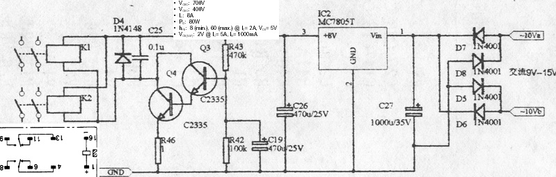

I've assembled a PCB for a "Marantz-like" 7c preamp. I can't get the thing to work. My feeling is that the power supply replacement transistors I've used are not the right ones... I am trying to troubleshoot it but my limited knowledge of electronics is not allowing me to fully understand the nature of the problem... Taking it a step at a time, I am now trying to fix a problem with the couple of relays that mute the output. They don't change state ever so the signal is shorted to ground always. I've attached a picture of the relay circuit showing the relays I am using. The relays are OMRON DPDT rated for 5vdc. It also shows the transistors I am using. Can anyone tell me what I am doing wrong? Please?

Circuit as shown will not work with silicon transistors. (Is it old enough to be Germanum?)
C19 charges slowly, which keeps Q3 Q4 Off until the C19 voltage rises enough to turn-on Q3 Q4.
C19 rises toward 5V*(100K/100K+470K), or 0.88 Volts. Silicon transistors need 0.6V to turn-on; in this Darlington affair you need 1.1V to 1.3V at the Base of Q3 to turn-on Q3 Q4 and turn-on the relay.
Either the schematic is wrong or they used odd transistors.
Quick-Fix: change R43 470K to 220K. Now C19 will charge toward 1.56 Volts, enough to make any silicon Darlington pass enough current for a reed-relay. After turn-on, the maximum possible Base current is 5V/220K= 0.022mA (and probably much less), which will not harm any transistor.

mwmkravchenko: I don't know if they are NO or NC. The pin configuration fits the PCB and it's rated for 5vdc so I didn't check anything else... I think they work. I replaced them with new ones a couple of times and had the some problem...
JOE DIRT: If they are not relays what are they??? :scratch:
ACD: The 5 volts are there and the pin configuration for the transistors is the same

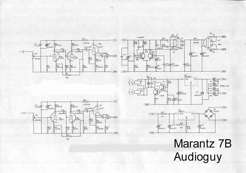

Here's the schematic that this is part of. The relay's (or whatever they are) connect to the outputs.

Do you have a part number on those relays? Some relays are polarized.
Try to measure voltage across D4 when powering up the amp. You should see 5 volts if so the relays are either of the wrong type or malfunctioning. If not the transistors is not doing it’s job. Part number of transistor?
I did mean NO (normally open) relays
replace D4 and C25....a signal diode is the worst thing to use as a clamp for a relay it is used to prevent back EMF....replace it with a 1N4002....the capacitor should remain as a ceramic type what this does is avoids chatter of the relay....a 50 volt NPO will work fine

Yes. 4.98V. I just checked. Can I just remove the relay altogether?

If you remove the relays you will loose the mutting function..and you must turn on the preamp before the power amp....have you checked the relays disconected from the circuit ans connected to 5 volt suplly...and see if they opened???

Don’t give up just jet, the relay’s appears to be polarized, e.g. pin 1 has to be connected high and pin 16 low. Check that this conforms to your pcb.
