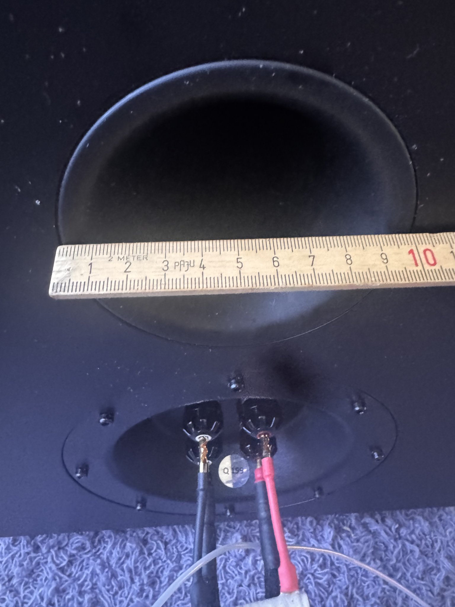

The widest diameter at the backend/inside is ca. 8 cm, the smallest diameter at the inside is ca. 7 cm. The outside diameter is ca. 10 cm.
The length of the pipe is ca. 12 cm
