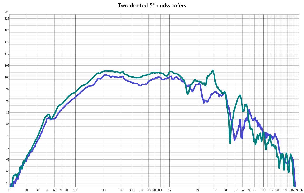

Instead of any solvent, I'd use a sharp blade like an Exacto knife or a half razor blade to carefully separate the dust cap from the diaphragm. Patience is the key.
I have found a replacement paper dust cup that perfectly fits over the old one. Could you please recommend me what glue to use. The cone is made of cellulose/synthetic foam sandwich

I've measured midwoofers of similar size with severely dented/crumpled dust cap. There is no impact up to 1 kHz.
Olympica woofer is crossed over at 250 Hz, so there is nothing to worry about as long as the cone is not torn. Add any dustcup you like or don't bother at all.

Any polyurethane or polychlorophrene glue, the ones with solvent smell. Don't use water-based glue like PVA, they are next to impossible to remove from paper cone.Could you please recommend me what glue to use

Most glues used for dust caps melt when heated up, while the other glues used around the voice coil are 2-component heat resistent. I removed paper dust caps with a hot air gun. As this is an aluminum cap, it should be even simpler to heat it up, only at the center.
You should remove the driver from the cabinet for simpler handling. If it has a hole in the magnet, you can push it from behind while heating from the front. If no hole exists, you can take a vacuuom cleaner with a round nozzle to pull it of once hot or a non magnetic tool to pry on the edge of the cap. Do not forget: Anti magnetic! Try on the magnet first!
Once you got it off, you can take a rounded tool and rub out the dent from the back while the cap lies on something flat and even. Look into your kitchen drawer for something with a smooth, rounded end. If this works (it does, but depends on your skills and patience) , spray paint the cap and glue it back on to the chassis.
Vacuuom cleaners are a a great tool to fix dents in speakers. I usually fix some hose or tube to the end, using tape. So you can match the size to the problem. If paper cones get soft after reshaping, a clear coat hardens them again. Nail polish works well.
Anyway, the dent in your speaker does not change anything in sound! Best for the speaker to leave it allone.

I can confirm that the trick with the vacuum cleaner works perfectly, provided the material is able to get back to its normal form (no sharp dent, smooth material fibre etc). Did it on the paper dustcone of a 15”er.

Yeah it only affects the BW above the DC's diameter, so for 1" = ~13543/pi = > ~4311 HzI've measured midwoofers of similar size with severely dented/crumpled dust cap. There is no impact up to 1 kHz.
