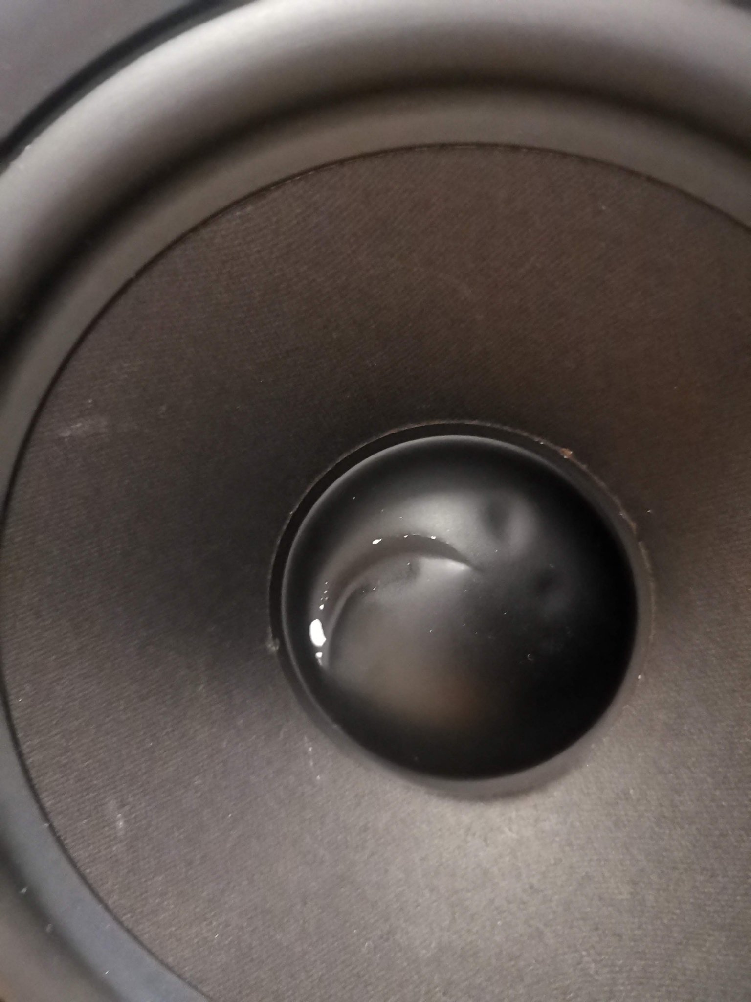

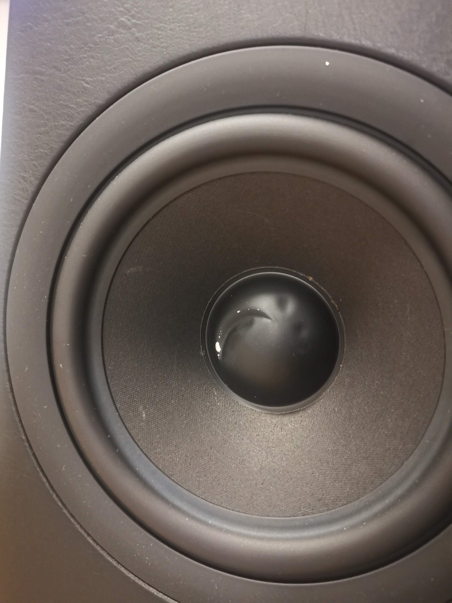

This may work on some aluminum dust cap, don't try it on one made from paper! Also, you have to know how strong/ fast you can pull or you may bend the voice coil. A typical case of looks easy on the internet, but...
double sided foam tape
I have used similar to fix FF165k dustcap.
