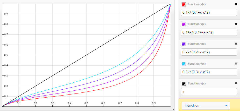

Is there an easy (temporary) fix such as adding a resistor to GND that would make the pot act like a 10k?

Add a resistor from each wiper to ground. The taper will change and you'll have to turn up
the knob higher. Start with around 10k and see how well it works. Use less than 10k if possible.

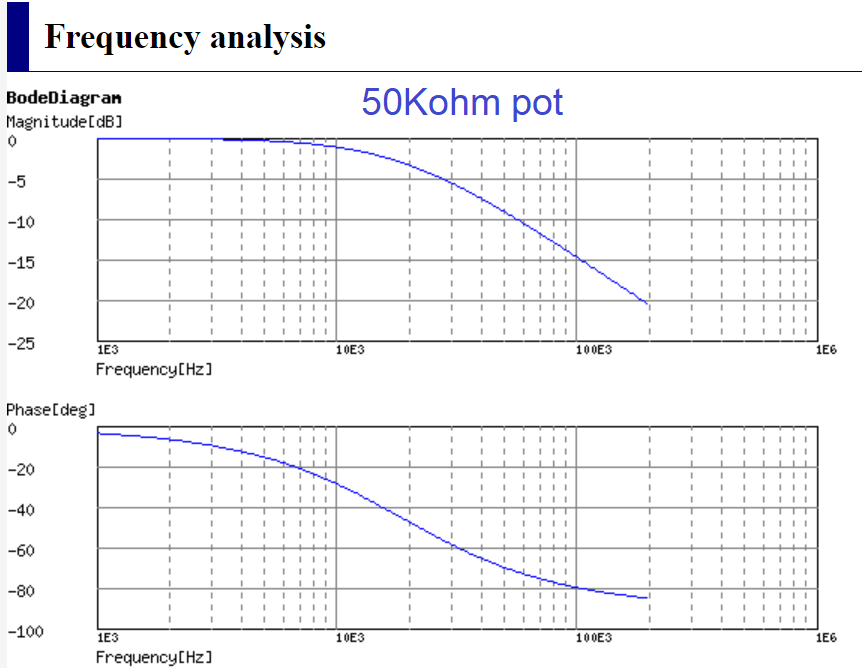

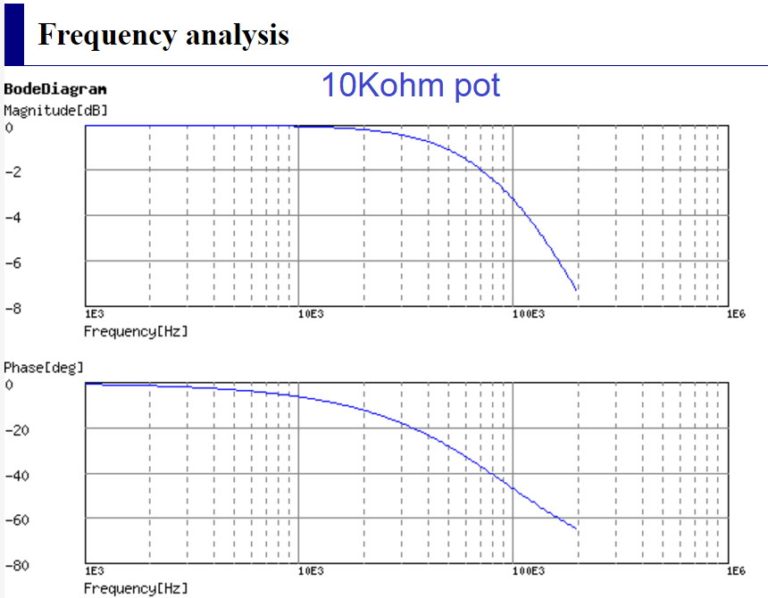

Your power amp has a 680pF input capacitor, forming a low pass filter with the source resistance, in worst case 1/4 the pot value modified by, not exactly accurate but closely enough, the 34Kohm amp input resistance.
A passive volume control design should take that LPF into consideration in deciding the value of the pot, so that the LPF response would not significantly alter the overall audio band frequency response. A 10K pot would put a cutoff frequency at about 100kHz (again worst case scenario), resulting in less than 0.2db attenuation at 20kHz. In comparison a 50Kohm pot will put 3dB attenuation at 20kHz.
I would not go with anything greater than 10Kohm in your case. I would not go with anything lower than 4.7Kohm either, to avoid heavily loading upstream line level device, CD player, DAC...
As far as the type of pot goes, I prefer linear, or B type, taper pot to audio taper ones. B type pots generally are better in tracking between the gangs, especially in lower volume range which usually is used most of the time. Linear taper can be easily modified to mimic audio taper by attaching a shunting resistor at its wiper. This resistor can be in the range 20% - 30% the resistance value of the pot. For a 10Kohm pot, use a 2.2K or 2.7K resistor. Note this shunt resistor pushes the LPF cutoff towards the higher frequency while increases the loading by roughly 100% to the upstream device, it can be a good alternative to use a 20Kohm B type pot and a 4.7Kohm shunt resistor if loading the upstream is a concern.
This piece by Keen talks about the taper mod.
I plotted taper mods with the shunt resistor in 10% -- 30% range.

Yes it does (with a series 1k resistor), so a 10k pot is definitely the best choiceYour power amp has a 680pF input capacitor, forming a low pass filter with the source resistance, in worst case 1/4 the pot value modified by, not exactly accurate but closely enough, the 34Kohm amp input resistance.

A 50k pot pushing 3db @ 20khz is similar to attenuating a crossover and would fit with what I heard.
0.2db I'm sure would be virtually inaudible for my aged hearing.
