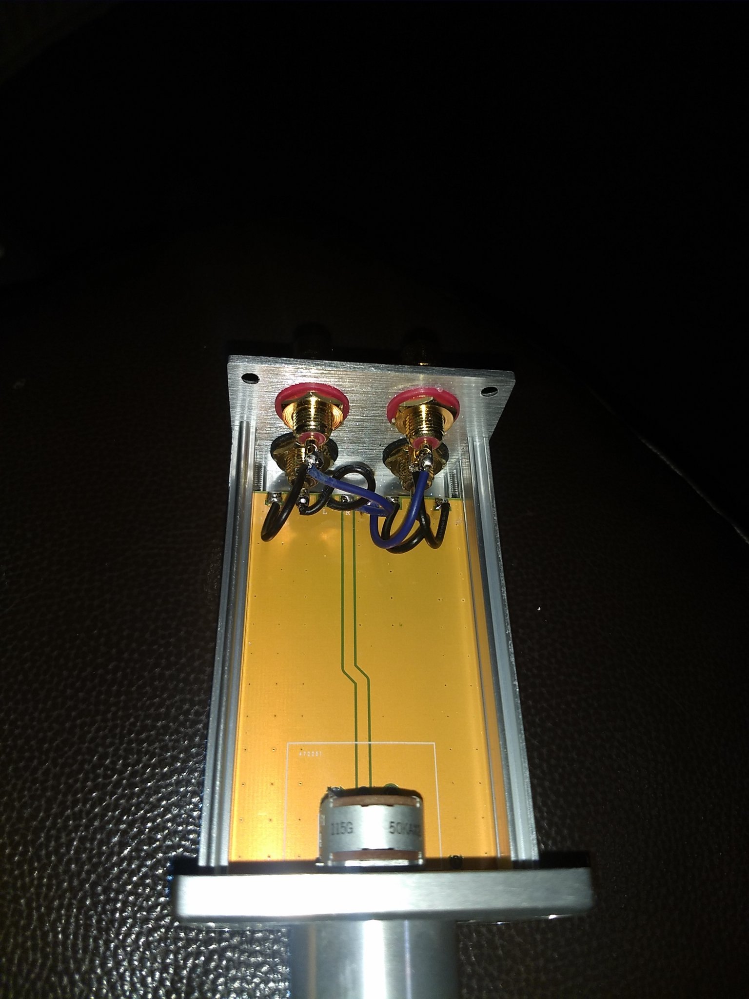

Last night I swapped out the pots.
It was too late to try it but tonight I've had a chance to have a quick listen.
First impressions are the 10k pot has no HF roll off in fact the passive offers more detail.
The mid range is definitely cleaner and bass seems tighter than the active pre.
There seems to be more depth of field it does however seem to sound a bit clinical?
My curiosity now is levelled at the dc output caps in the dacmagic.
I haven't opened the unit but from reading other threads it seems they could be unbranded or Hova branded 470uf
Does anyone have an opinion on whether swapping them out for better caps and beefing up power supply caps could help?
