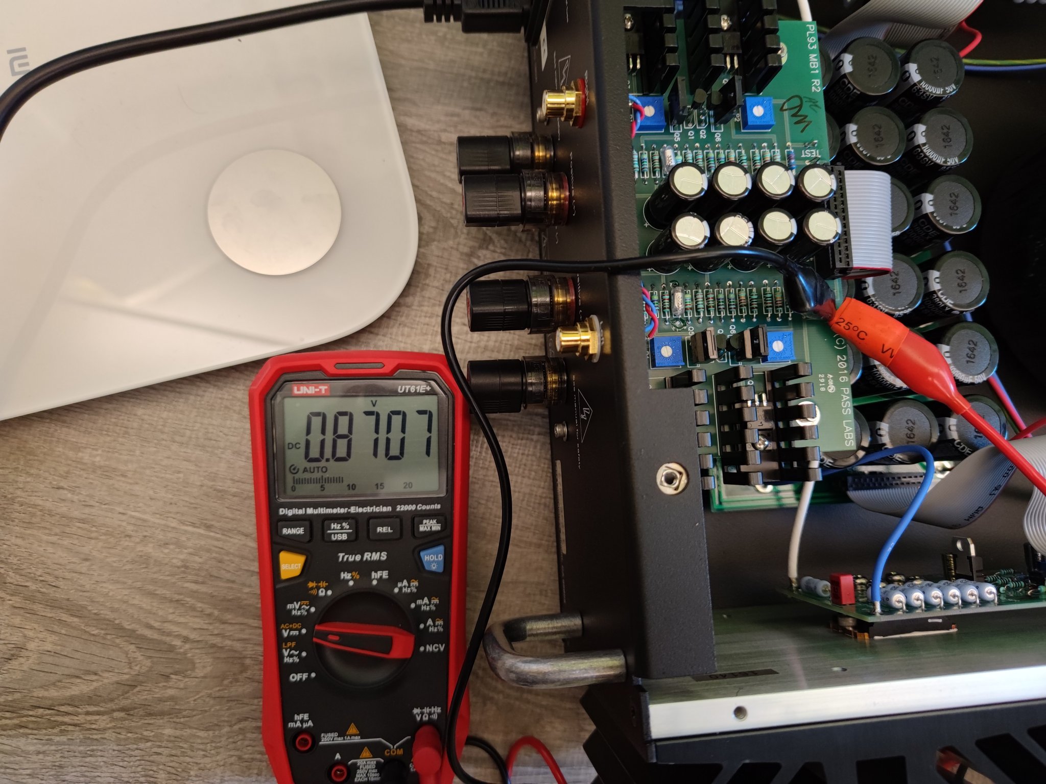

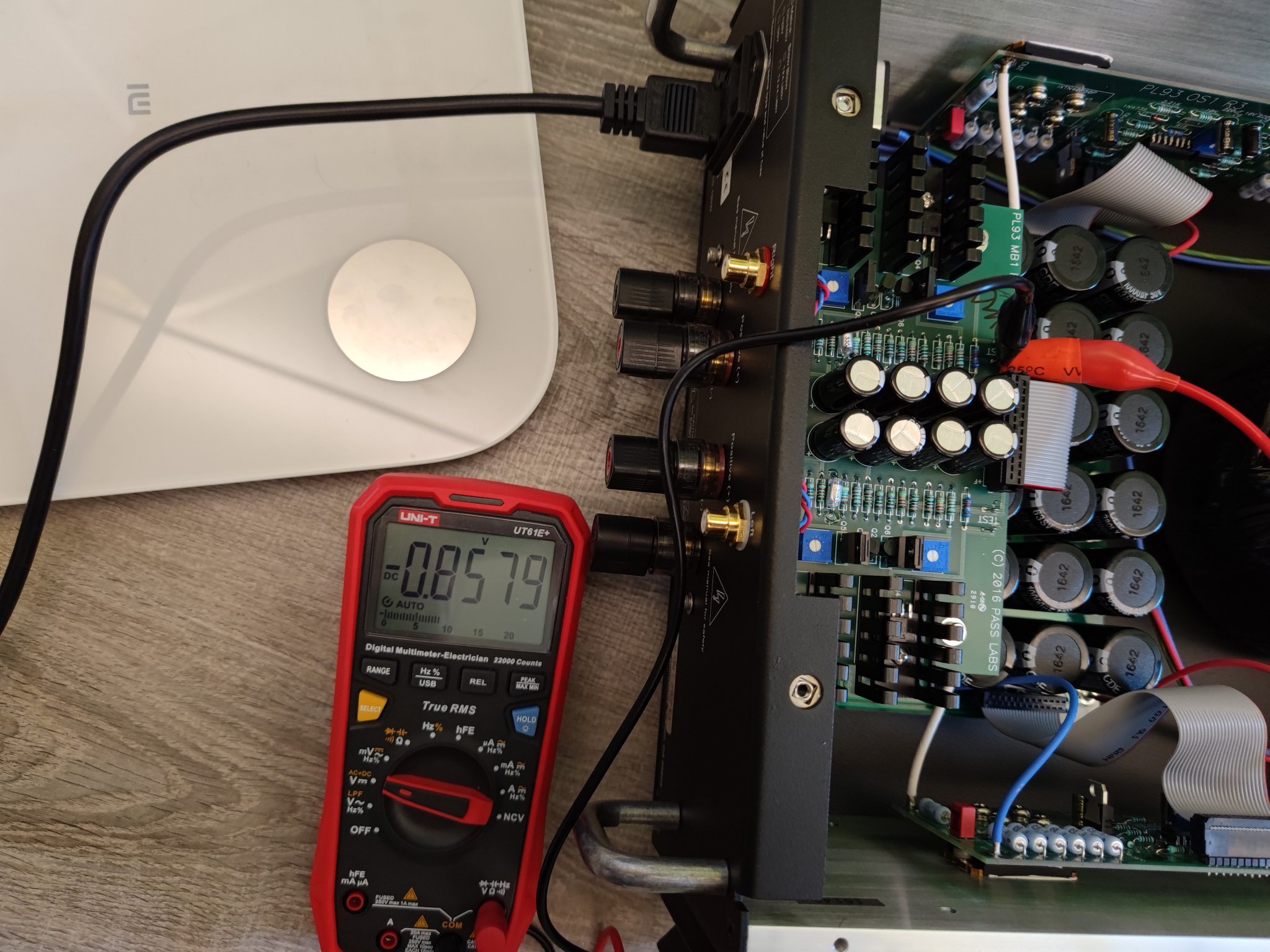

I purchased this amp a few days ago to compare it to my old ATI 1807 amp which I'm currently using and quite liking but wanted to upgrade to something better.
However, I wanted to check what it outputs because I will connect it directly to my drivers (using DSP for a crossover).
!!! I've measured ~0,4v (405mV) constant DC voltage on the Left channel and about 0,08-0,12v (120mV) DC on the right channel !!! Clearly cannot connect it to a tweeter!
Is the unit defective? It has a break-in runtime of around 3 days before the test and was warming up for 4 hours but the voltage is similar when cold.
My old ATI amp is outputting between 0,0015v (1,5mV) to 0,0045v (4,5mV) between all 7 channels which I think is acceptable!
P.S. I've checked the test points on the Input stage and saw a difference of around 12-15mV between L and R channels.
P.S.2 If I like the amp I'm ready to explore the way of using three amps for my 3-way speakers but if it outputs so much DC I won't be able to do this...

Adjustment is done by setting drive stage bias. I takes a bit of time cover on cover off.
I will see what it should be.
Thanks! I can see one potentiometer in the output stage and 2 per channel in the input stage.

There are two trimpots on the FE board for one channel, a small turn on one of them in the right direction should better the situation , look at the DMM at the output of the channel.
Of course this will change a bit the bias of the FE, but I think not so much to get grey hairs.
I do not know how experienced you are for such a trial, for a Pass DIYer who did the F5 normally no problem.....!
I'd try with two multimeters; one connected to the speaker binding post, the other across any of those 5W resistors.
Write down the reading across the 5W resistor - this is your target quiescent current. NOTE: write down this reading with the amp sitting at its nominal operating temperature.
Turn the pots a bit and see which one controls the drift, and which the Iq.
Adjust the drift for 0 (or as close as possible), and then correct the quiescent current. Back and forth a few times to reach 0 drift and the target quiescent current.
Close the amp, and let it warm up to full furnace temp 🙂
Repeat adjustments. Done.
Check both readings when the amp is cold... just for your reference.... you may find that the drift is bigger (and the Iq higher) when the amp is cold.
One DMM on the output terminals, one DMM at the test points of the FE.
DMM at the output terminals near zero and DMM at the test point of the FE to around 880mV giving around 40mA for the SK2013/J313 combo.
As Wayne said the 3W Panasonic output resistors are part of the output stage and their current, this section is not important for your problem.
So if I reduce the voltage in the FE, I will reduce the bias?
What is the optimal one for sound quality, can I increase it slightly more than stock in favor for SQ?
P.S. Currently I have managed calibrate the DC output to around 5-10mv in idle and high temperature, and to 0,861v for the test points.
