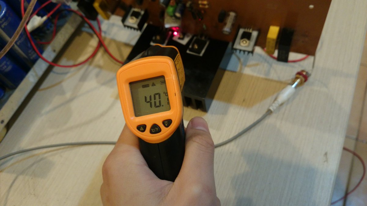

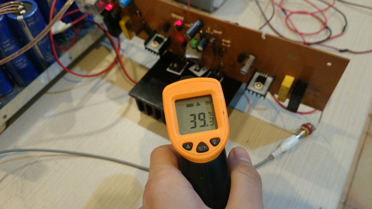

So, the whole machine gets biased up once I increace the current, It seems like as if all transitors are using equal biasing, including drivers, however it is just the single Q6 that seems to be slightly hotter than q8, as I can measure with a temp gun approximatly 1-2c diffrence in temps, but some how same temps once I fired it up for a long time and operated slightly pass the class a region 11 watts biasing.

If the temperature measurements are of the air rather than the body of the transistor in question the convention of air around Q6 might not be as good as for Q8. Are you happy with your amplifier now or do you have other unresolved concerns.

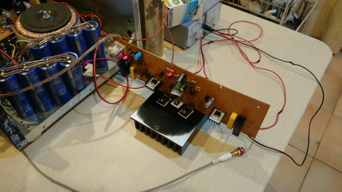

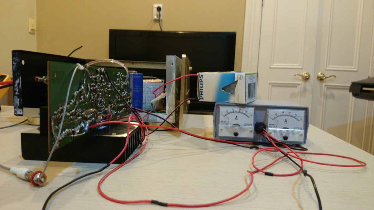

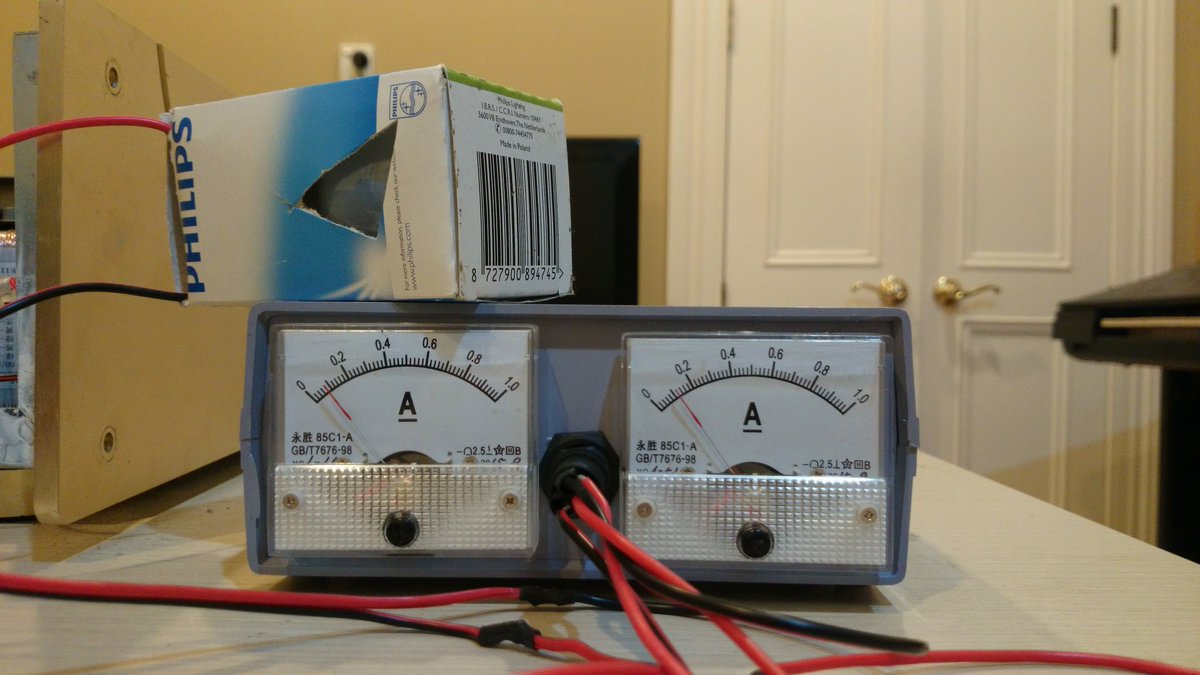

Here are some pictures of my amp, running in semi class a 😀 I uploaded these pictures to twitter so I can share with my friends, I am a bit lazy to upload the original pictures, so I just coppeied these off twitter. If you want to see some better quality pictures or more photos post a comment 😉
The picture seems like one side has 40ma more, but its actually 20ma, depends on which side you look at it
Thanks for all the help guys 😀
Are those meters measuring total supply current rather than just the output stage device current ? If so then that would explain any imbalance. The current draw from each rail is never equal and would not be expected to be so.
Yeah, its the total, At first I was thinking the same too, but one pnp decvice is slightly hoter at the out puts(probally my temp meter isn't that accurate or it actually is using more), but nevermind, I decided to leave the current here and its working great. Further more the amp meter it self isn't that accurate
Temperature isn't a reliable guide. You can't guarantee the thermal coupling is the same between the two devices and you can't guarantee that the heatsink dissipates it heat equally per unit of surface area due to external factors.

You would normally measure the voltage drop across the power transistors emitter resistors and apply Ohms law to deduce the current.
The question here is whether or not you have fitted any. Otherwise fit 100R resistors in the power transistor collectors and measure the voltage drop across these.

1r0 passing 20mA will drop 20mV
You can easily measure 20.0mVdc on the 199.9mVdc scale of a cheap DMM.
1r0 passing 20mA will dissipate 400µW (=0.0004W)
Use any 1/8th W, or higher, resistor.
1r0 passing 300mAdc, or 300mAac, will dissipate 90mW, just within the capability of a 1/8th W resistor.
