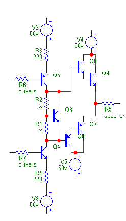

Help With My Class AB Biasing, Unbalanced npn, pnp current
..............The voltage required is referred to as bias voltage.
That bias voltage needs to match the two voltage drops across the output darlingtons.
Your Darlingtons do not have any output resistors (emitter resistors). This can make the output current unstable, so much so that the output Darlingtons could blow up !
I am not using darlingtons, Its a tip41c connected to a tip3055. So if I use some emitter resistors you reckon I could balance out the voltage? Any other ways? I don't really like putting my emitter resitors in there
you have drawn Darlingtons.
draw a proper driver + output pair for your output stage.
And put in emitter resistors before you blow up your amplifier.
EDIT: You really don't have any Q6-9 emitter resistors?! How are you even measuring bias level then? (Don't say with a multimeter in current mode. Then the current shunt is your emitter resistor.) Plus, isn't bias terribly unstable like that?
Not having any emitter resistor between Q6/8 is a pretty big no-no.
Listen and implement.
Yeah, why even bother the others with your "non-plorbem".
Because I spent allot of time tyring to get this happen and I thought others might have an idea on this. And I found out at the end that it works fine with extra current
It works fine wihout emitter resitor for tip41c and had ran for 2 years no plorbem, class ab mode, and juiced for 11watts idle still allright, So I'll look to see if the plorbem disaperas once I add the emitter resitor back in
Also my bias is stable, it dosen't go up when temp goes up
Q5 and Q4 are buffers passing constant current of a considerable amount. What I see happening is Q8 and Q6 being turned hard on and getting hot as the result.
Seemingly Q6 is drawing so much current as to starve the emitter of Q3 which has compromised its' operation. The energy source in a transistor is the emitter.
There may be a problem with Q6 and or Q7 - one of these may not have blown but become leaky due to overheating or too low an impedance load. If so it would be a problem you would want to prevent for the future.
I suggest stopper resistors in the bases of these transistors would mitigate the problems with Q3 not working and overheating your drivers. For trial purposes I suggest a value of 100R.
You do need emitter resistors for the power devices - the emitter diode thermal resistance changes with temperature increase and you need to develop a voltage across the emitter resistors sufficient to mitigate against that. If you run your amplifier in Class A the emitter resistor values will have to be higher in value that for Class B due to higher operating temperature of the devices.
