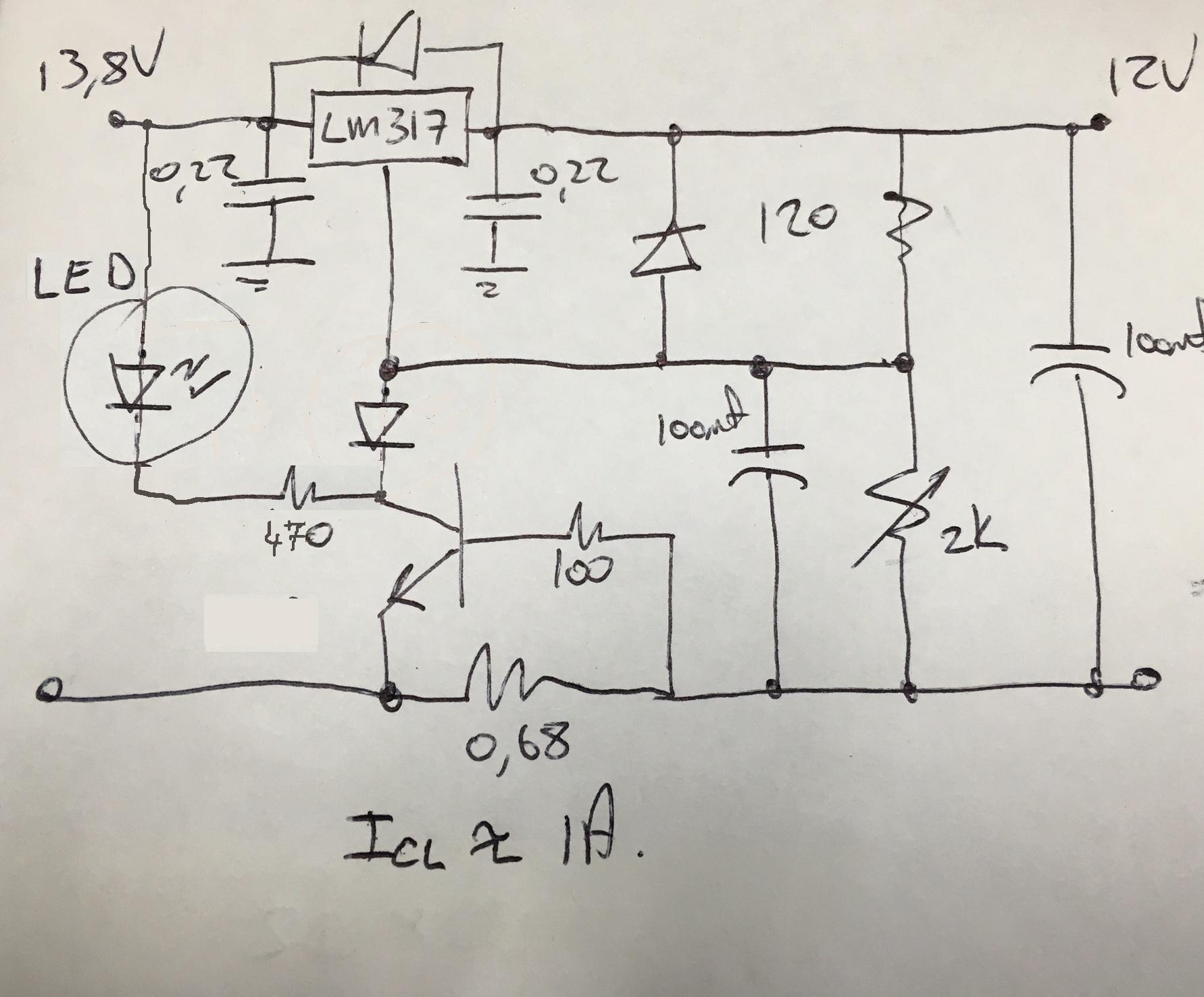

Hi Guys.
I build the attached circuit. Instead os the LM317 I used a LDO LM1086 regulator. It has the same pinouts, and works a treat.

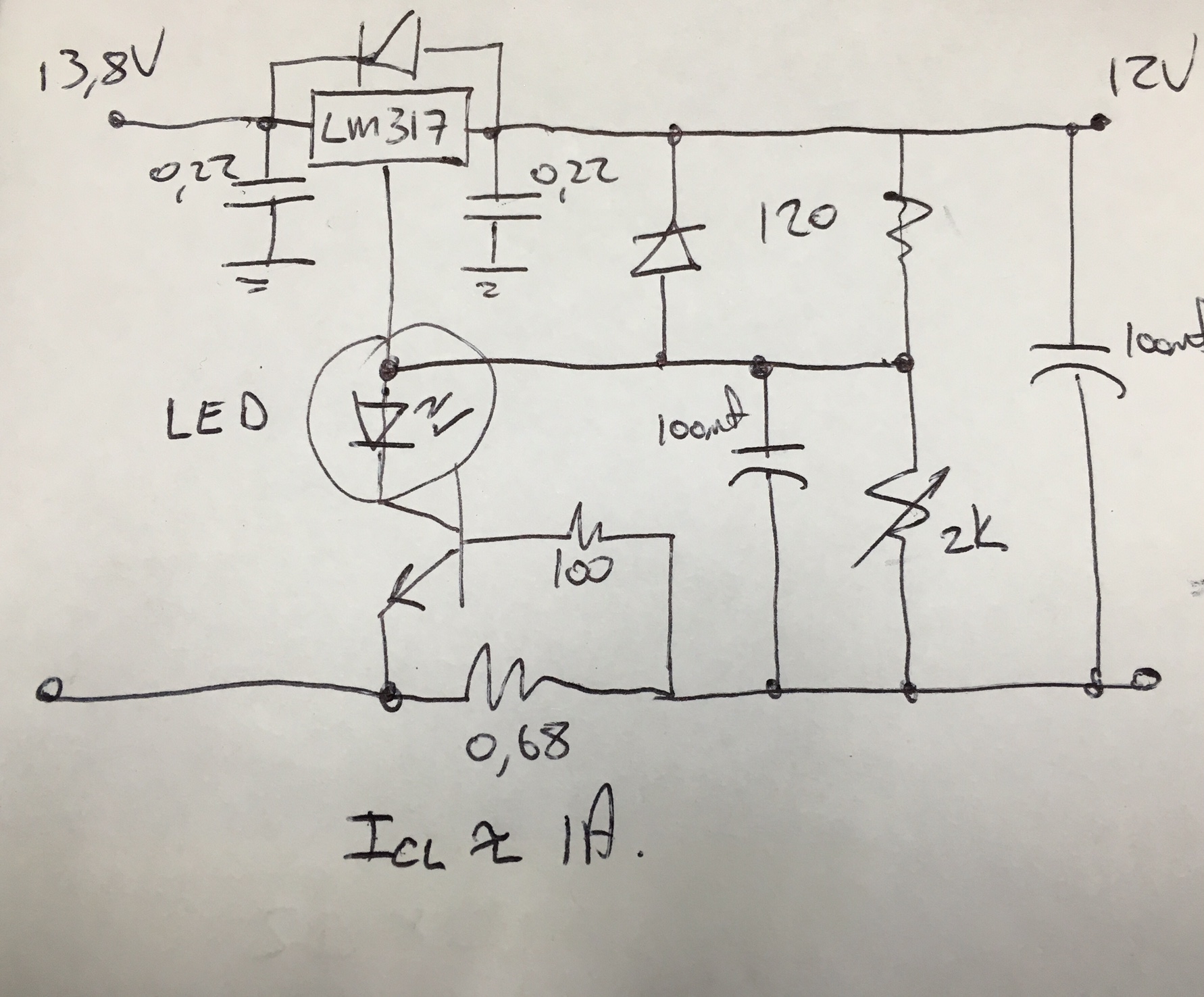

My question relates to the LED in my circuit. I added it from memory from an old school power supply I built which added an LED in the collector of the transistor to indicate a "current limit" state.
Problem is, that the LED changes the limiting current slightly, and the rate of current limit drastically. The LED also lights up very early, long before the calculated limit value.
Is there a better arrangement that I can use here. I know that the datasheets don't show the LED, but would be awesome to have some form of indication.
The idea is good but the problem is that the LED current doesn't turn on hard when limiting. There's always some current through the LED. What you need is an extra 'thing' that turns it on hard when limiting.
Find a point in the circuit that jumps when current limiting, connect that to a transistor 'switch' with the LED in the collector, something like that.
Jan

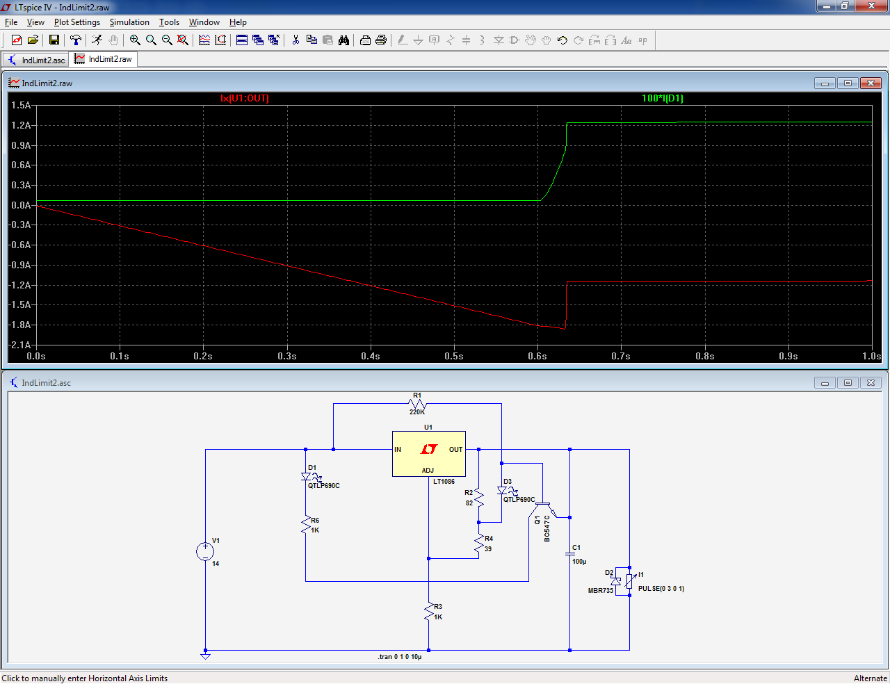

This circuit is a bit more complex, but it will precisely indicate the current limit condition (and it won't create any I*R losses).
A small trimmer may be inserted at the junction of R4 R5 to make sure the threshold is perfectly accurate
The circuit works by comparing the reference voltage of the LT1086 to that of U2 (1.2 V reference). The circuit takes advantage of the fact that the reference voltage of the regulator will collapse once the regulator current limits. This, in turn, trips the comparator, turning on the LED. The circuit doesn't actually measure the output current.
The only thing you'd get from adjusting the R4/R5 ratio is a bit more noise immunity on the over-current indicator - or an LED that's stuck on if you tweak in the wrong direction.
I'd probably increase R1 to a value that allows just the minimum required current to flow in U2 under normal operating conditions. With the current values, I bet the current through U2 wreaks havoc on the line rejection of the regulator.

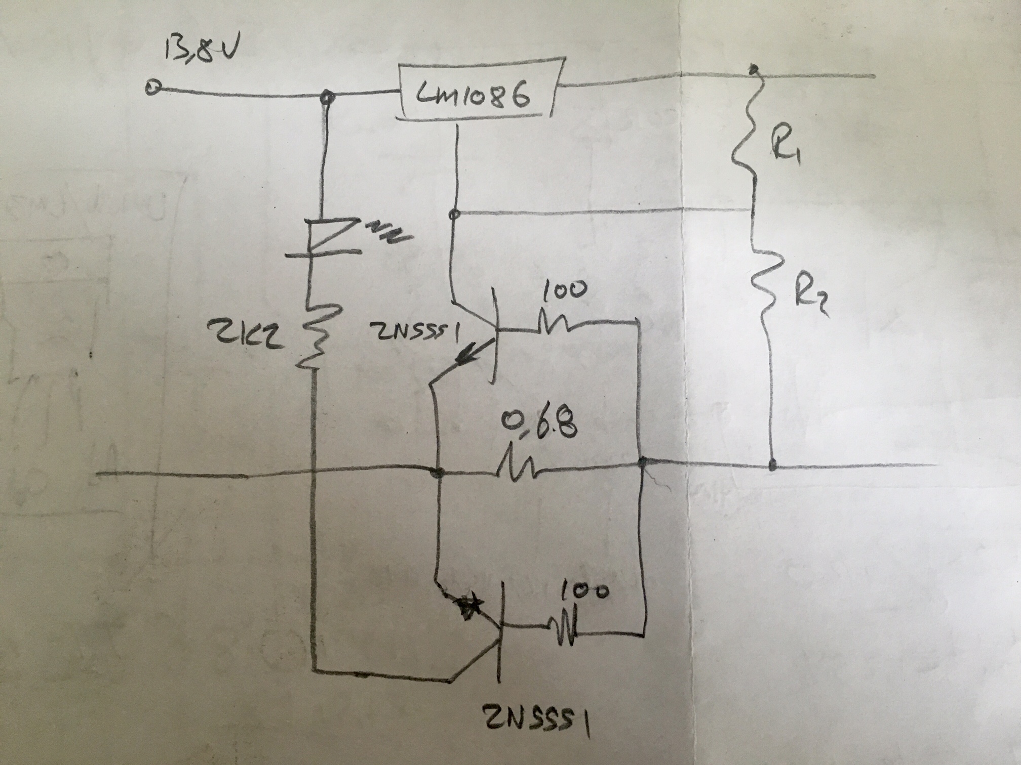

I found a solution!!
Except you haven't actually solved anything. 🙂 You may want to re-read Post #2. Or just go implement Elvee's circuit from a few posts back. You may not need fancy references or comparators. I bet a couple of diodes could serve as U2 and a differential pair with a couple of transistors as the comparator. Watch out for temperature effects if you choose to use diodes for the reference voltage.

Here is a simpler (but less deterministic) version.
R1's value is a tradeoff, and here will cause ~10E-3 error in the divider current.
The LED should compensate the transistor's Vbe to the first order.
Indication won't be as accurate and clearcut as the first version

This is debatable: I interpreted it the other way round, because the OP wanted a circuit that let him know when "the regulator starts limiting", and also because his circuit showed no means of adjustability of the threshold, and the theoretical threshold was very close to the published limit of the circuit, but I could be wrong.
Perhaps could diy didi lift the ambiguity?
A side-note: the circuit I have provided will react to any type of loss of regulation, not only current limit: an input brown-out for example.
It could be useful though, if the power transformer is under-dimensioned compared to the regulator for example, which could easily happen since semi's manufacturers sometimes take hefty safety margins over the published limits
