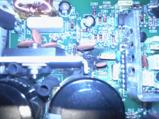

Well well Mbates seems your the man to go to regarding blown power supplies. Id you dont mind id like to bother you a tad regarding a LP755 power supply, ASTEC AA20440. Projector was faulty when i bought it, so i opened up the power supply and found a few components which have exploded. Is it just a matter of replacing these blown components or are there others that i'd need to replace too?
Pics attached below
Thanks for any help in advance
