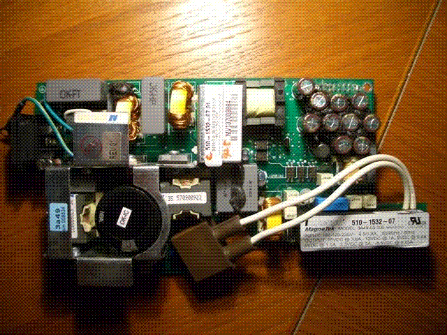

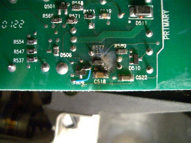

Infocus LP530
Hi! iI got a lamp from ywh it worked great the first day i testet it (bright and with good colours).But sadly the next day the projector broke down just after 30 minutes.After checking the powerboard the first thing i noticed was that the resistor R577 is burned (and open) and the condensator C518 is shorted.After some reading in this great forum I guess that the viper100a and one or two photocouplers SFH617A-2 is gone too and C13
(el.condensator 100mikroF. 25V).And the 3 pinned component on the left of C518 marked ?508 (i can´t read the first letter ).
I guess schematics for this powerboard is impossible to find.If i gonna try to repair this i need to know the values of the following:
R577 ??? ohms (can´t read the numbers because its burnt think it begins with a 5 and ends with a 0)
C518 ?? (got no markings)
?508 don´t know what this is transistor or diod ?? (it´s marked n5 JE)

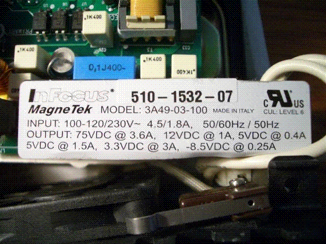

Projector: Infocus LP530
Ballast: MagneTek Model: 3A49-03-100 (Output:75VDC @ 3.6A)Original lamp is: 270w SHP now lamp is 270w JYS/DC from ywh
Can you mbates14 or anybody here help me with this, or where i can find a new powerboard?
Any help would be great! Thanks a lot!
