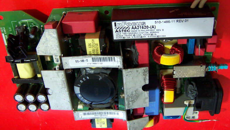

I'm sure this isn't the right forum, but I need some help with an InFocus LP340. Seems the power supply cooked (it's an ASTEC AA21620) and a few parts exploded on the board. I am looking for a schematic for this unit. Ideas?

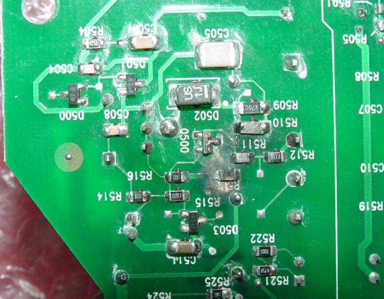

the viper will fail, and will take out the opto isolator, the SMD regulator transistor, a startup resistor, the viper itself, 3 IN4148 SMD diodes, 100uf 25v capacitor, and a diode in the secondary of the power supply. this is all caused by the regulator opto failing, running the viper past its specs.
good luck getting that silicone **** off the viper heatsink to remove it. fun fun.
also there is a 0.1uf 400v starting capacitor that goes bad and will blow the main MOSFET and a series of chips and other parts. this is due to starting the wrong lamp type in the wrong power supply. thats why infocus issued a Rev01 update.

give me some pics of your power supply
guys. sheesh. lol, your not getting a schematic. ive tried, hunted and learned. ive worked on over 50 of these power supplies and i know how they work by the back of my hand now, without a schematic.
Q500 is a PNP small-signal transistor.
you will need to replace the 2 diode packs which ar enothing more than 3 1N4148s, the viper, the opto-isolator, a secondary diode in the power supply, that transistor, and possibly the 2K startup resistor, along wiht the 100uf 35V cap.
