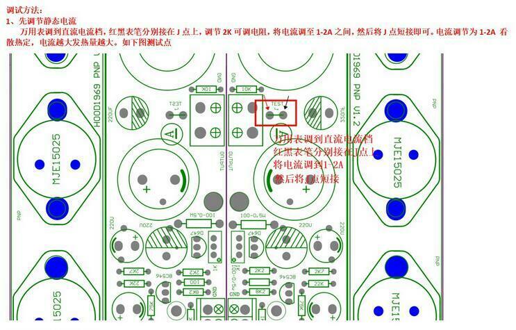

I didn't get a circuit diagram but apparently the circuit is adjusted before shipping. Here is what I have:
Is this the current variable resistor? I am unsure if I can adjust it without having to adjust the other variable resistor too and I'm not too keen on that - but if needs must to lower the temperature I guess it's an option...
In the circuit shown above the points to measure are the midpoint between the collector of Tr1 and the positive connection of C2 with respect to ground. This should be close to half the rail positive rail voltage. This is shown on the circuit diagram as TP+ Step two is to measure the voltage on the emitter of Tr2 to earth - shown as TP.
The difference between these two point is the voltage drop across R9 and since the resistance of this known you can work out the standing current in the output stage from Ohms law i.e. I=V/R
Following the instructions in Chinese, there is a range of 1-2A that would be adjusted by the 1k trimpot R9.

@Zoea - I'm not sure, but the red square you have indicated suggests to me that these are two test pins. I can't identify a trim pot from the layout diagram. A photograph of your board (if you can provide a reasonably good one) would help.
We need to relate the circuit diagram OldDIY has posted to the points on the layout you have shown.

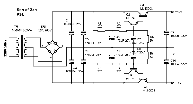

Scheme from another PCB PNP 🙁
This PCB is called HOOD1969 PNP v1.2. Three transistors on the heatsink.
One capacity multiplier.
Yes, the circuit you posted might not be the one Zoea has but it might serve as a guide.
Top section probably does not exist in Zoea's (I'm guessing) but as you say will have a cap multiplier.

PCB #29 has two trimmers. One on the short side of 1/2 U. The other on the long side regulates the current.
