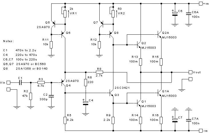

Best read all the articles on the Class A amplifier site:
The Class-A Amplifier Site
See if you can work out which schematic the Chinese have actually followed!

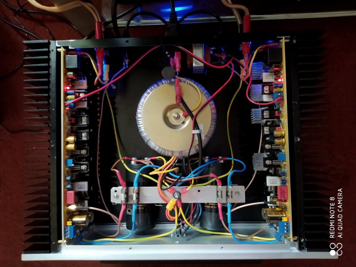

On my Krell clone I am glueing a finned heatsink to each transistor as you can see in the photo - still some to do.
I checked the temp with a multimeter thermocouple and found the heatsinks dropped the temp from 70C to around 63C. The heatsink temp was around 50C, so 20C difference from TO3 can to HS fins. (each transistor is passing about 0.7 amp at 36v (per rail)
