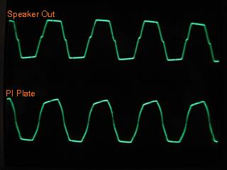

Power amp will smooth things up with asymmetric soft clipping if driven hard enough.
Whoops. Sorry, my bad here. I meant to say symmetric instead of asymmetric.
Because Marshall amps, when we use that term as generic referral, tend to have push-pull output stages.
Generally you can expect push-pull -type amps to clips quite symmetrically whereas single-ended stages tend to have much more asymmetric clipping characteristics.
For example, here's a scope capture of a push-pull tube power amp driven to clipping:
As you may notice, not quite soft, and the grid conduction of the power tubes, and resulting bias shift also generate plenty of crossover distortion. The behaviour is archetypical for many push-pull guitar power amp circuits. Looks bad, right? But this is scope capture of highly praised Trainwreck amps, which heavily rely on power amp clipping to produce distorted tone that actually sounds marvellous.
I bet it doesn't comply with most of the stuff you see written about tubes, softness of clipping, harmonics of clipping, etc. But this is the real deal.
Next in line, scope capture of a single-ended triode power amp clipping:
Again, not very soft but the real deal. You can notice how the asymmetric characteristics of tube's different types of clipping behaviours (cutoff and saturation) manifest themselves. Signal swings towards the other halfwave tend to be higher, and due to different kind of clipping process the damping factor also varies greatly accentuating rising signal edges. Transients and even oscillatory ringing is common. You could expect similar performance from other single-ended power amps, like one in Fender Champ, for example.
Again we all know that they don't sound bad when they clip, but they don't sound like clipping push-pull amps either....and despite of abundance of those supposedly "musical" even order harmonics in the signal it probably just sounds like it distorts.
Of course, note that these were just generic examples. Sort of generic behaviour you may expect, sometimes to find that the circuit you are examining tends to be designed a bit differently and behaves a bit differently. But these are the sort of outputs I generally expect to see in overdriven push-pull or single-ended guitar power amps that often recycle the same designs.
The nicely soft clipped sine waves... no I don't see them often. Sometimes, yes. Usually with very mildly overdriven push-pull -type amps, running to resistive loads, without much negative feedback and with tubes that tend to have soft clipping characteristics (not all have). And usually it takes just a bit more overdrive from that point and its almost like square waves again. The "headroom" of that soft clipping region is actually very, very narrow. Here's a scope capture of that same SE amp at milder overdrive, just where it barely begins to distort:
Doesn't take a lot of input signal increase from that point for the clipping to turn very hard.
