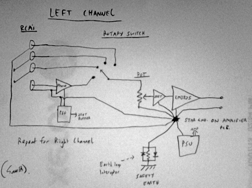

You might get more help here if you could post a diagram. I've drawn up what I think you have built and I've included an earth-loop interruptor between your signal ground and the safety ground of the chassis - you likely need one if you don't have one already.
You could also try the JFET bugger with an independent power supply outside the chasis and before the signal reaches the RCA inputs - to see if it generates hum by itself without changing anything inside your integrated amp.
