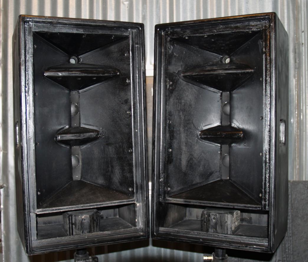

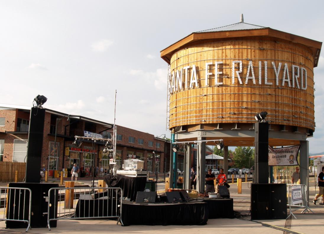

For a PA the size of what you are considering, I'd go with a pair of cabinets per side along the lines of this 2x6" with tweeter. Eminence Alpha 6" and APT drivers, 26.5 x 15 x 11.25 inches deep.
A pair can do around 130 dB at one meter, I certainly would not want to be in front of them if they were not above my head.
The PA picture below shows a pair per side (horn to horn) ratchet strapped on a 45" tall sub with a cord case of the same size for elevation.
Small dowel pins at the front edge are inserted between each cabinet, and shims at the back for a slight down angle.
