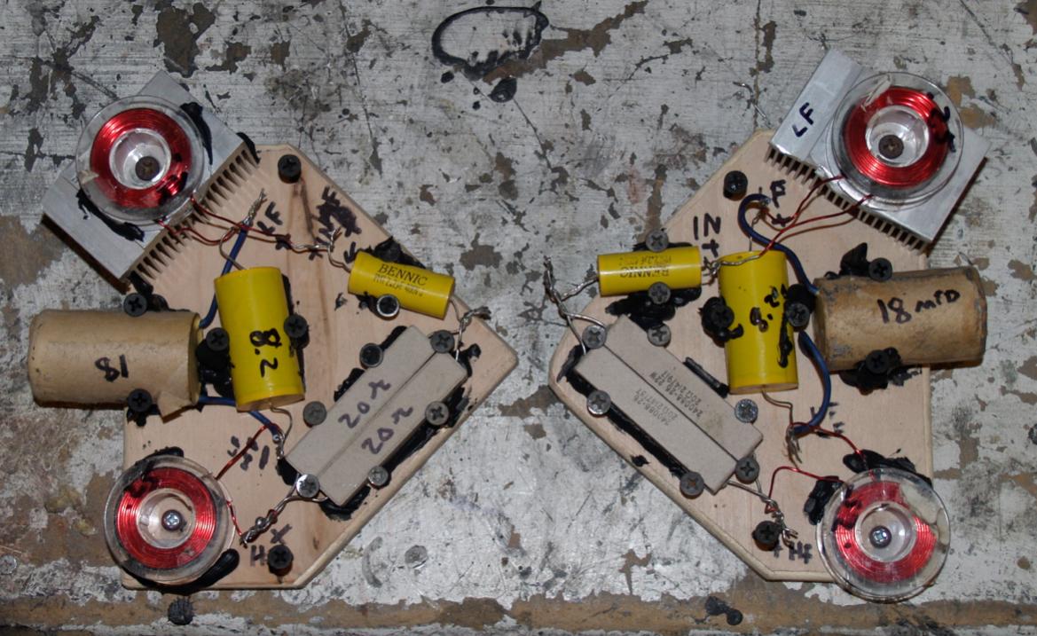

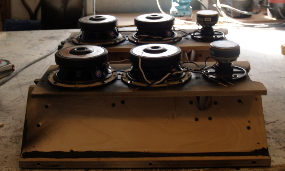

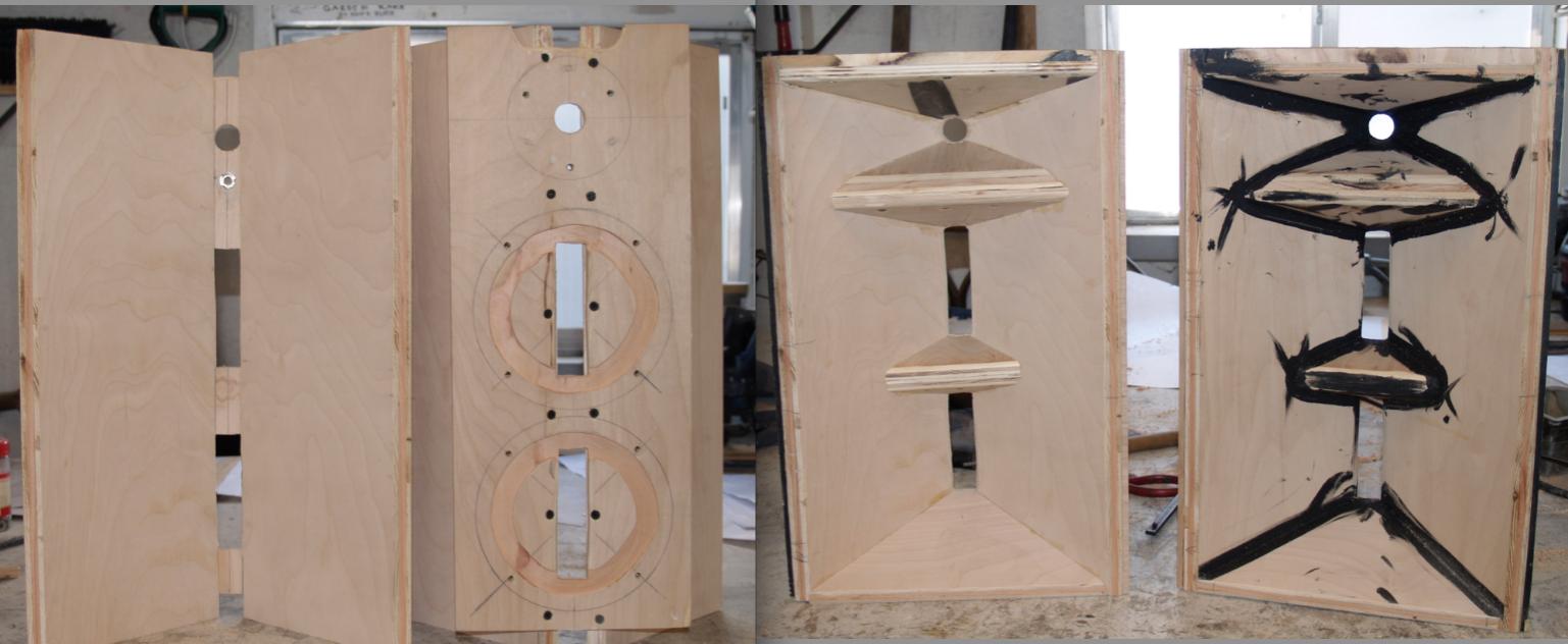

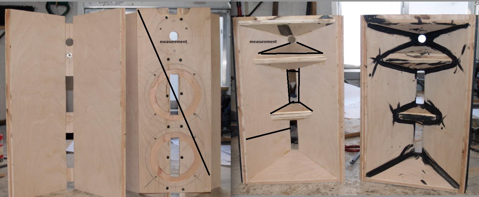

I never formally made up plans, the exterior dimensions and view of the porting are given in post #14 (exterior is 3/4", horn walls are 1/2") and the pictures below show construction details.
The 3/4" x 3/4" grill frame sides are angled at 45 degree to continue the horn angle. Cabinet is 3/4 rounded to reduce diffraction and road rash.
Duratex paint rolled over a latex primer.
Felt lining is used behind the drivers on the back panel.
Finished weight is 40 pounds using Aruco plywood.
The raw cabinet response is not flat, but the midrange efficiency the small conical horn provides makes it a seriously good sounding little cabinet once compensating EQ is applied.

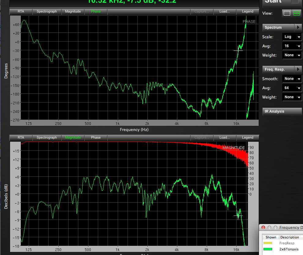

How does jbell top compares to your top.
I don't know which "jbell top" you would like to compare, I don't recall seeing measurements for his top cabinets.
The frequency and phase response of my 2x6T measured in free space are pictured below.
At 160 Hz, sensitivity is around 95 dB one watt one meter, upper response is around 104 dB.
