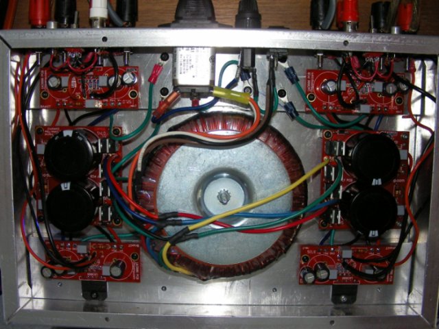

I've got everything put together now and my chipamp is making music. However there is a problem. With no input connected the speakers are dead silent. When I plug in the cable to the pre-outs of my receiver a loud hum comes from the speakers. It seems to play just fine, just over top of a heavy hum. What might be the cause of the hum? Do I need a cap at the input?
I'm using the chipamp kits. I put everything in the case and connected all 4 (I made a 4-channel amp) chassis grounds from the amplifier PCBs to 1 point. I also connected the AC line ground to that point. The only potential ground loop is that the IEC filter module I used has a metal case in contact with the chassis. The common ground point is a couple inches away from this. The chassis is made from aluminum plate so I doubt any voltage drop is possible.
When I connect a portable source (ipod) there is very little hum. The hum that is present is probably just the noise from the source being amplified. Can anyone help?
drproton said:
I put everything in the case and connected all 4 (I made a 4-channel amp) chassis grounds from the amplifier PCBs to 1 point. I also connected the AC line ground to that point. The only potential ground loop is ............
the loops from the 4 interconnect shields entering the amp and the possible connection to Safety Earth of the various sources and your power amp.
When you say AC line ground, do you mean Safety Earth?
Yes, I do mean the safety earth. Would it work if I let the low voltage stuff float, i.e. disconnect the grounds from the amp PCBs?
With only the ground connected from the interconnects there is no buzz. With one channel connected only that channel will buzz.
I rearranged the grounding some now the hum is down to an acceptable level, about the same as my other amps.
Instead of 1 start point I connected the grounds to 1 heatsink bar. This bar is a 12" x 2" x 1/2" piece of solid Al. The grounds are connected within about 3" of each other. Not sure why this made such a big difference, but all is well now. Maybe I had the ground wires is exactly the wrong spot and was getting induction.
The amps sounds pretty sweet, clear throughout the entire range with nice tight bass. I think it sounds better than the power section on my NAD751 receiver, I'm feeding the amp from the pre-outs of the receiver.
[EDIT:] I just saw that you have already greatly-reduced the hum level. I'll post this anyway. Maybe you can get the hum down to 'inaudible', if you keep trying for just a little longer.
Also, can you give any more details about exactly what you did, that reduced the hum so significantly? i.e. Do you have several 'heatsink bars'? And did you connect ALL of the grounds to just one of them? Are all of the heatsinks connected to the chassis? Are all of the chips well-insulated from their heatsinks? Is it possible that there's a bad ground connection related to the amp that uses the heatsink to which you connected all of the grounds. i.e. Do you get the same result if you connect all of the grounds to any one of the other heatsinks?
I guess I'm wondering if your solution is actually just 'masking' the original problem. I'm not quite sure how to tell, at this point. Someone else should have a much better idea.
But, for now, with a foggy brain today for some reason that I will not admit to, except to say that it was not illegal, all I can think of is to maybe try 'shotgunning' it; maybe something like the following: Use an ohmmeter (with all power disconnected) and measure heatsink-to-chassis resistance (and heatsink to star ground), for each heatsink (possibly looking for only a small difference; I'm not really sure if it might be noticeable or not, in that case.). And maybe try similarly measuring the resistance from each PCB's ground(s) (especially where the signal input grounds connect, and maybe then also at the chipamps' inputs' ground points) to the star ground, and to the chassis. I'm guessing that at least some of those measurements should also be done with all or some of the grounds disconnected from the star ground point/heatsink, e.g. the 'to chassis' ones. Maybe alternatively, if you have an oscilloscope, you could use a low-attenuation vertical setting and probably mainly probe the signal ground connections on the PCBS (and maybe also the chipamps' feedback dividers' ground points), while connecting the probe ground to various points, such as the star ground, and the signal ground entry points (or maybe even their source ends). It might be possible to do something similar with an AC voltmeter, if it could reliably show differences between low-level AC measurements.
On another note: Since you mentioned that you also re-positioned some wires, can you still get a comparable hum level by rearranging any wiring? If so, that might eliminate the need for trying to find another fault (e.g. per my babbling, above).

Where do you connect the "grounds" of the signal input cables?
I think that the signal input grounds' conductors should connect only to the audio grounds, i.e. only on the(ir) amplifier PCBs, and, actually, only directly to the point that serves as the chipamp input pin's voltage reference, i.e. where the input-to-ground resistor and the feedback-divider-to-ground resistor are first connected to each other.
The signal input "grounds" should not even be considered to be grounds. They are just the reference voltages for the inputs with which they are paired.
You will need to make sure that any signal input connectors are insulated from the case, so that their "grounds" are not inadvertently connected to a case or chassis or whatever, where they enter.
Isn't there more than one ground return conductor from each amplifier PCB?? (It seems like there should at least be separate power and signal grounds.)
Have you tried using 'disconnect networks', between the amplifier PCBs' grounds and the safety/earth/chassis ground? They usually consist of a small resistor (say 10 Ohms or more) in parallel with either two hefty inverse-parallel diodes or a hefty rectifier bridge, usually in parallel with a small capacitor of maybe 0.1 uF (I'm not sure if it needs to be the AC-mains-safety-rated type; couldn't hurt if it was, I guess. Maybe AndrewT will enlighten us, on that.)
P.S. ALL conductors develop SOME non-zero voltage drop, for any non-zero current.
P.P.S. (Just because I like this quote: ) Current does not follow the path of least resistance. It follows ALL paths, in inverse proportion to their resistances.
Rather than try to describe my layout, heres a picture. Before I had every ground under the same screw as the AC input. The way it is now seems to be fine.
