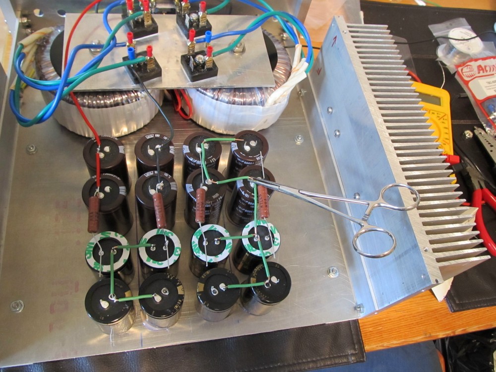

The electrolytics with the 3M tape are Mundorf'$.
Not sure if star grounding will make any difference - but I will be using this technique for the supply.
I was going to use C-L-C but couldn't fit the chokes in the case.
BTW: The surgical clamp was used to make sure there was good metal to metal contact, before soldering.

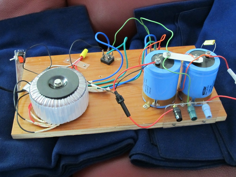

Jumo,
Interesting - I got different results.
Here is a picture of my prototype supply - using computer grade electrolytics.
Note the fuses on the +/- outputs of the prototype supply.
Looking on a scope - it soon became clear the quality of the supply is key for a good F5.
Thanks for confirming star grounding is important in this case.
The ground focus point will be on the Mundorf electrolytics shown in the picture above.
Actually - I'll run a ground wire straight from the power diodes to the Mundorf's.
The amp will get its ground from that point.

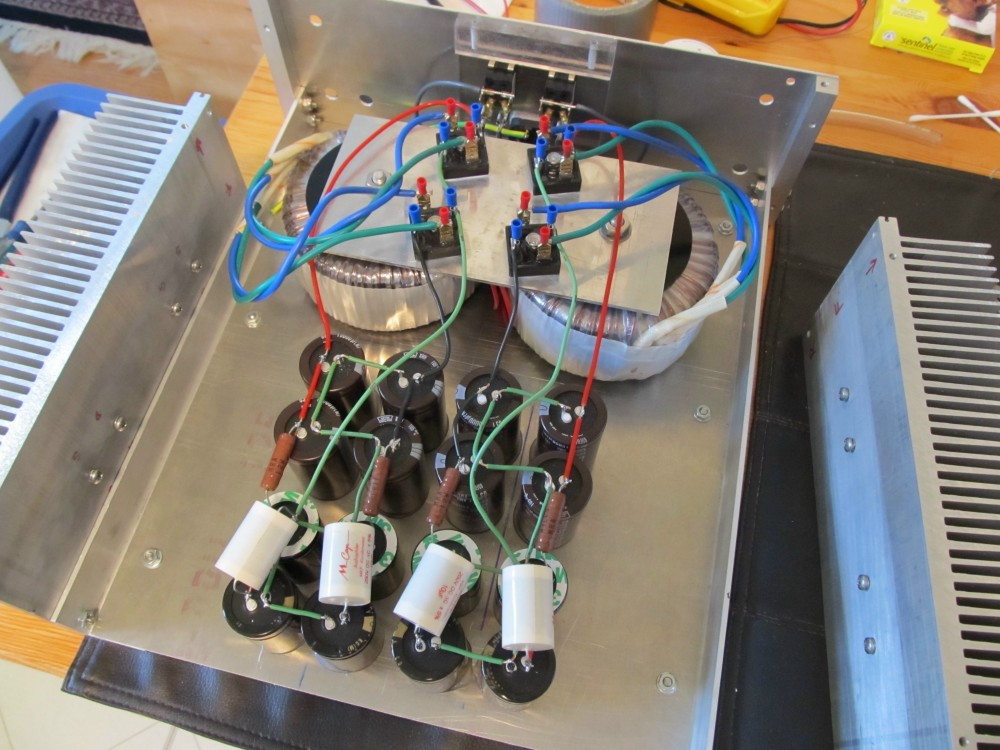

I'm really not a wire aficionado but that's clearly a sub-optimal setup - search for some successful build's pictures and you'll get it, good wiring techniques are explained and shown many times on this forum...
Do I spot a shorted turn between the transformers and the aluminum plate connecting them via the mounting bolts?

I stole the idea of gluing the electrolytics down with a hot glue gun and using P to P wiring from the Blue Circle BC 1022 amplifier.
P1010474 | Flickr - Photo Sharing!
However, if I were to do it again, probably would have used an FR-4 board with a focused ground area.
But hind site is wonderful.
Also, I would have BOUGHT A PRE MADE CASE !!! instead of making it.
However, mounting the 2 toroids in the back of the amp worked out well - resulting in running short AC lines inside the amp.
I was a bit concerned about in rush current when the amp was switched on
so dual power switches were installed.
The technique of mounting the bridges above the power toroids seems to be pretty common.
The green wires running from the diode bridges are connected to the ground focus point.
The Mundorf film caps focus in on that node too.
Lord NO !!!
There is a rubber washer - then the toroid's metal washer - and the aluminum plate sits above that.
So the aluminum plate sits at least an 1/8" above the windings.

if screw heads have connection with base plate , then also with Al plate on top - you have shorting turn through both donuts
I don't understand.
Both the case and the aluminum plate are at the same voltage potential.
The donuts are electrically insulated from the case by the large rubber washer on both the top and bottom, supplied by Antek.
Do you mean the donuts are talking to each other through the stainless steel mounting bolts ?
I thought the idea of the donut was that all the flux lines stayed inside the core ?
Can stainless steel be picked up by a magnet ?
Do they make 5/16" nylon bolts ?
That's the first thing Faraday asked himself too when he noticed the current flow through the conductor that was close to the moving magnet 😉
OK - I just checked.
A 1" diameter neodymium magnet has a just a hint of a pull on a bolt (machine screw ?) made from 304 stainless steel.
Do you you think the donuts are talking to each other by inducing a current in the stainless bolts ?
