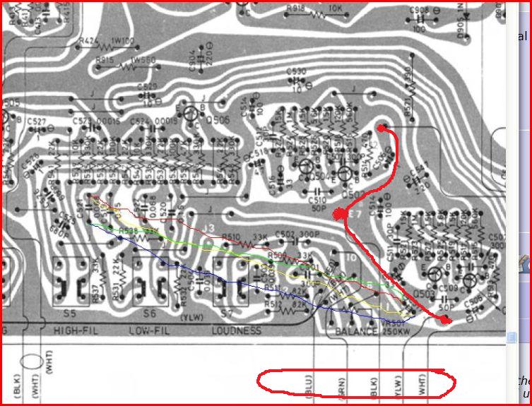

Remember the wiring and the way the pot looks is all familiar to you, it isn't to me so we do it one step at a time and test along the way. I am looking at the board layout in post #11 for this. You probably think that it is all wired like this anyway but lets do it from scratch and test.
Make sure you understand the logic in this before wiring it up 🙂 We will work on ONE channel at a time so first connect C505 (left hand leg on diagram) back to ground so as to keep this channel silent. Now we work on the other channel.
1. First unsolder all the wires to the pot and unsolder them all from the PCB (for both channels).
2. Now take one wire and solder it to the correct ground point on the PCB marked E7 on the board.
It is possible that the wiring routing and layout is important for all these connections. This procedure should help prove that.
3. Connect that wire to the two end ground pins on the pot.
4. Now connect a wire from the C506 terminal on the PCB (make sure C506 is soldered in properly now) and route it correctly to the pot.
At this stage we are going to test again and so now connect this wire temporarily to the pot ground pins instead of the middle pin.
5. Switch on and test. It should be silent when switch is operated as we are in exactly the same electrical configuration as when we tested earlier by isolating C506 and connecting it to ground at the PCB.
If it is silent switch OFF and transfer the wire over to the middle leg (wiper) on the pot. We will say to use the channel of the pot nearest the chassis.
Retest... it should be silent with the volume control on minimum.
If that is OK then we wire up the other channel exactly the same, reconnecting C505 correctly and running a wire from C505's terminal on the PCB to the middle leg of the other channel on the pot.
Retest... both channels should be silent.
Lets see where it fall down doing this... it may be picking up noise on the wires to the pot or the pot may in some way be coupling to the chassis. We could only eliminate that by swapping back to the original pot.
So lets see 🙂

Lets isolate the volume control completely as I mentioned yesterday. Remove all the wires from the PCB to the pot. Make sure all caps and resistors are connected as per original.
Look at the diagram. Remove the 5 wires marked and then solder two short wires from C505 and C506 to the exact ground point marked.
Is the switch noisy or quiet ?

Yes, its back to where it was with the popping and noisy control.
I will remove all the wires going to the pot from the pcb, but I would like to mention here that the wires you saw on the last picture I posted are factory ones, when the pot was changed soldering was done only on the pot side.
Only cap now not connected as per original is C506, I will return it to original.
I get your picture, you want me to connect C505 and C506 to the grounding point for volume pot.
Will try and get back.
Thats it... grounding to the correct point that the volume control uses but without any other wires connected.

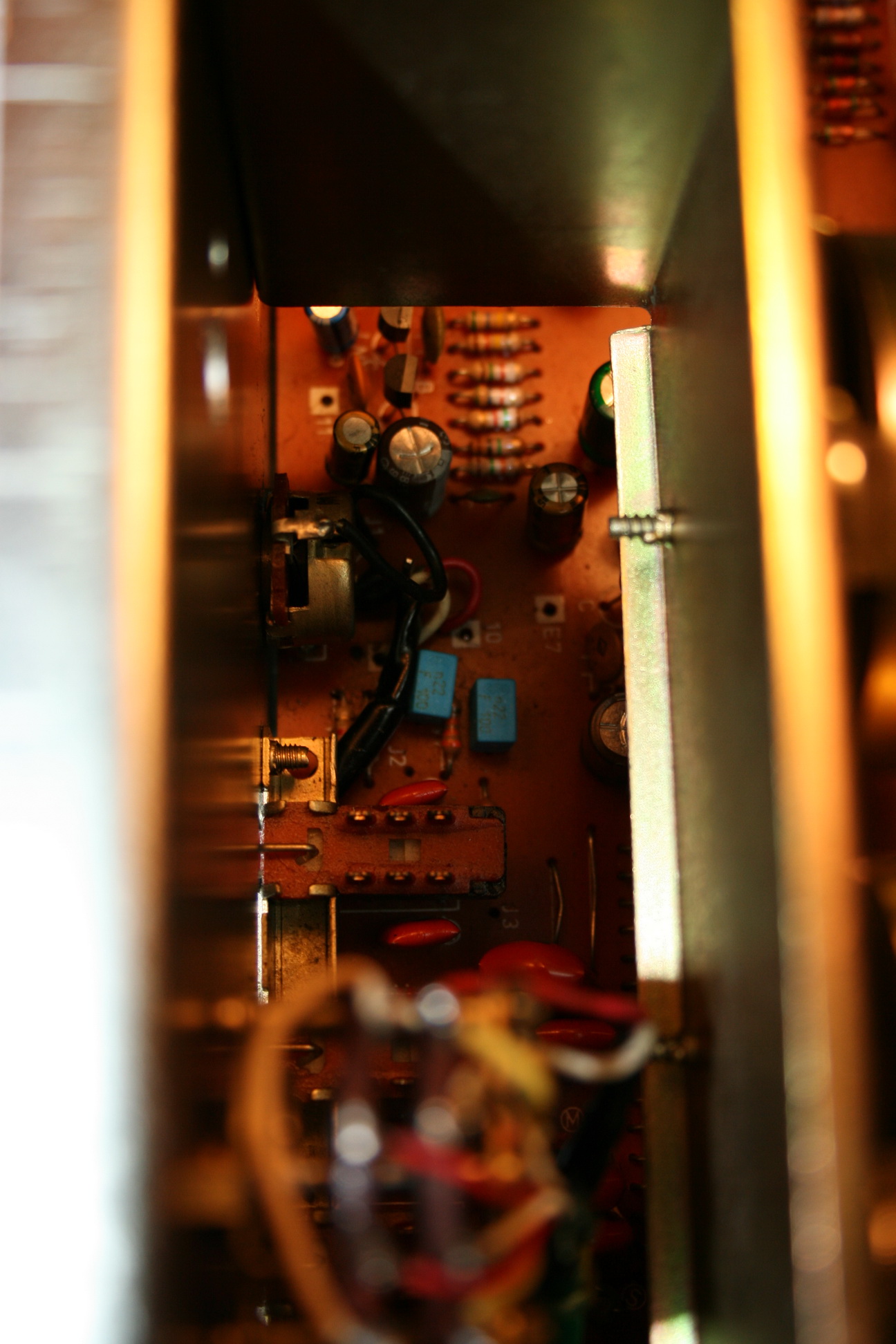

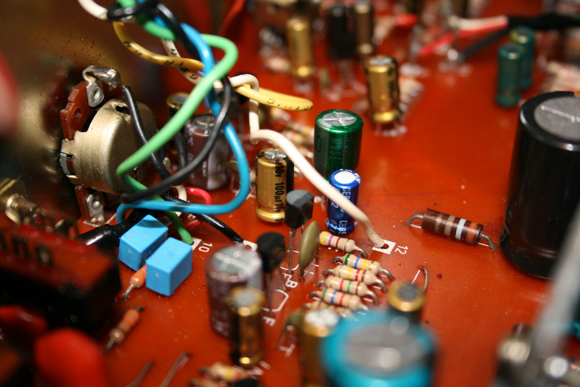

All caps connected as per original, wires from pcb to the pot removed. I took a picture of wireless and potless Rotel, so you don't think I skimped on that.🙂
C506 and C505 connected to E7 exactly as in your diagram.
Switch is noisy.
Is it noisy in one or both channels like this ?
Keep the wire links in place and now short out R530 and R529
Noise present or not ?
It is noisy just in the right channel as before.
