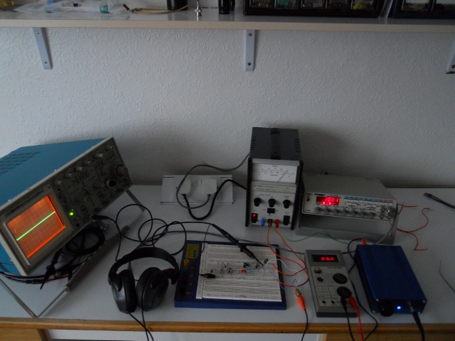

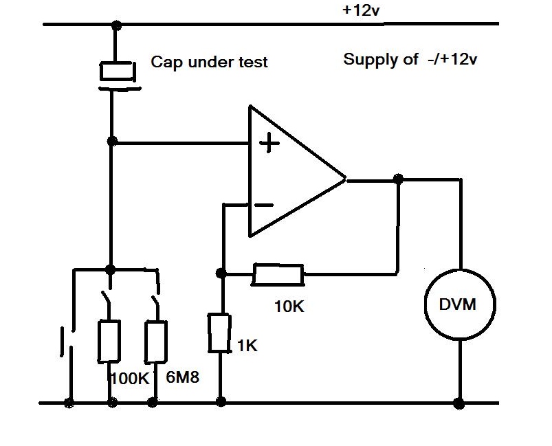

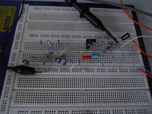

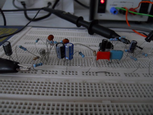

Another little test as it's good to go over theory and practice once in a while.
Yes, modern caps are pretty good. You can see here how all the electrolytics are actually quite leaky. Look also how the two similar Tantalums vary so much. The Panasonic and Dubilier were the best of the electroylitics here.
So to see just how leaky are caps, old, modern and of different types are I rigged up a TLO71 opamp as a DC amplifier as shown. By dividing the voltages at the opamp output by 11 we get the DC voltage across the resistor Rbias. Ohms law would give us the current. It's more of a graphic example showing the voltages though. The voltage across Rbias should be zero of course for a theoretically perfect cap.
Each cap was tested as follows. The test began with Rbias shorted for a few seconds to bring the cap up to charge. The short was removed leaving the 100K and 6.8M resistors in place. The reading was taken and I called that the 100K reading. The 100K was then removed leaving just the 6.8M and I waited 1 minute for the reading to stabilise (which it didn't always). That is the 6.8M reading.
Capacitor, Rbias and the actual Rbias Voltage

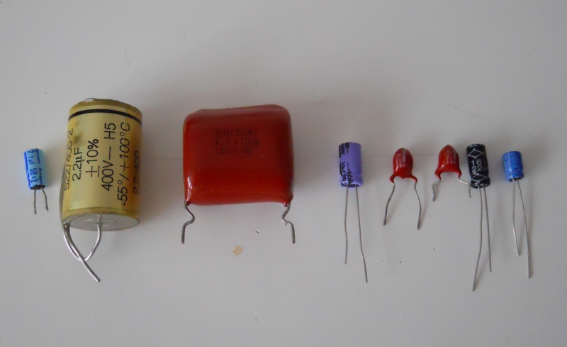

1. 2.2uF/16v ancient electroylitic. 6.8M 62mv
100K 1.36mv
2. 2.2uF/400v Mixed Dielectric. 6.8M 1.1mv
100K 0.1mv
3. 4.7uF/100v Film 6.8M 2.2mv
100K 0.136mv
4. 10uF/100v Dubilier Electroylitic 6.8M 0.11v
100K 3.2mv
5. 22uF/16v Tantalum (Tant 1) 6.8M 6.8mv
100K 0.36mv
6. 22uF/16v Tantalum (Tant 2) 6.8M 72mv
100K 3.6mv
7. 22uF/16v (Multicomp brand) 6.8M 0.33v (still climbing)
100K 18mv
8. 47uF/16V Panasonic Audio series cap 6.8M 0.145v (still climbing)
100K 12mv

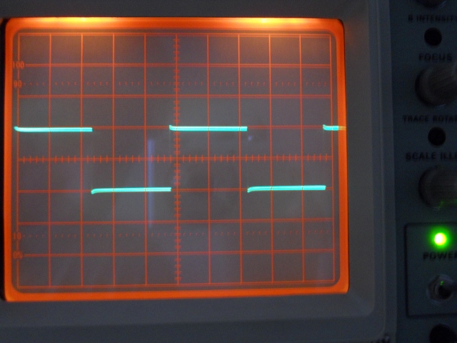

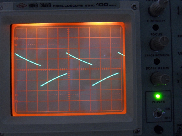

That doesn't read very well
Modern caps are better for reliability and ripple current ratings, temperature ratings and so on, but all the standard types I have are all quite leaky in practice.
I haven't got any specifically marked "low leakage" electroylitics.

I might have a little fun test that you can do on some caps with your DVM. I'll try it first though.
I must admit I have a fear of the results you're not the only one
You mention that changing C517 for another cap made that (the good) channel noisy too.
Yes, you can leave those parts isolated to test initially.
