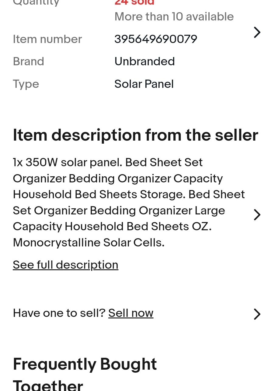

This is the panel listing
https://www.ebay.com.au/itm/395649690079
I ordered 4x of them for $71 each. Almost too good a price, so I am wary. Especially since this is my first solar outing. I don't really understand much of greater details yet apart from trying to attempt to match panel output to controller ratings and a suitably rated controller for my unlimited range @ slow cruise speeds target
Do they appear to be 350 watters?

Regarding testing the panels. I can use a multimeter to monitor a panel raw voltage over the period of a day. Would an array of 400w of light bulbs be a suitable load to monitor power output? I am a bit mixed up about what type of device should I use to measure the current through the blub array load
I'm sorry to disappoint you, but the size of the panel is approximately 1/4 of a 500-600W large modern high efficiency solar panel. I do count 33 cells, so at best they are 175W, my guess they are 150W. With 33 cells you can expect and MPP voltage of 18V, and open voltage of about 25V. take a single panel, short it with a current meter, and measure the current at full sunlight. Cover the panel before you disconnect the short to prevent arcing. A dc clampmeter is very convenient, that saves you fumbling with extra connectors. To calculate the panel power, just take the measured short current, take 8% off and multiply with the 18V mpp voltage.

Compared to a 100w flex panel from a reputable manufacturer I use, these panels would appear to be ~75W based on size alone.
I just looked at the AU$ and it looks like that cost about $50 US. That is ~ $0.66/W (US) which is a fantastic deal IF it proves out power productuon wise. I can't help but be skeptical based on pricing here but you are much closer to the manufacturer and I'm not at all familiar with AU import tariffs/taxes etc.
Isn't it a bit late to ask after you bought them?
The text of the panels says
Durable Anodized Aluminum Frame
Tempered Glass Surface
Both is not possible to bend. If it got tempered glass then it will fold the Aluminum after each row of cells if the cells are individually covered by the glass. If not, you can either bend it and there's no tempered glass for protection or you can't bend it.
The product description that came up when I followed the link didn't mention aluminum or glass... or solar panel.
