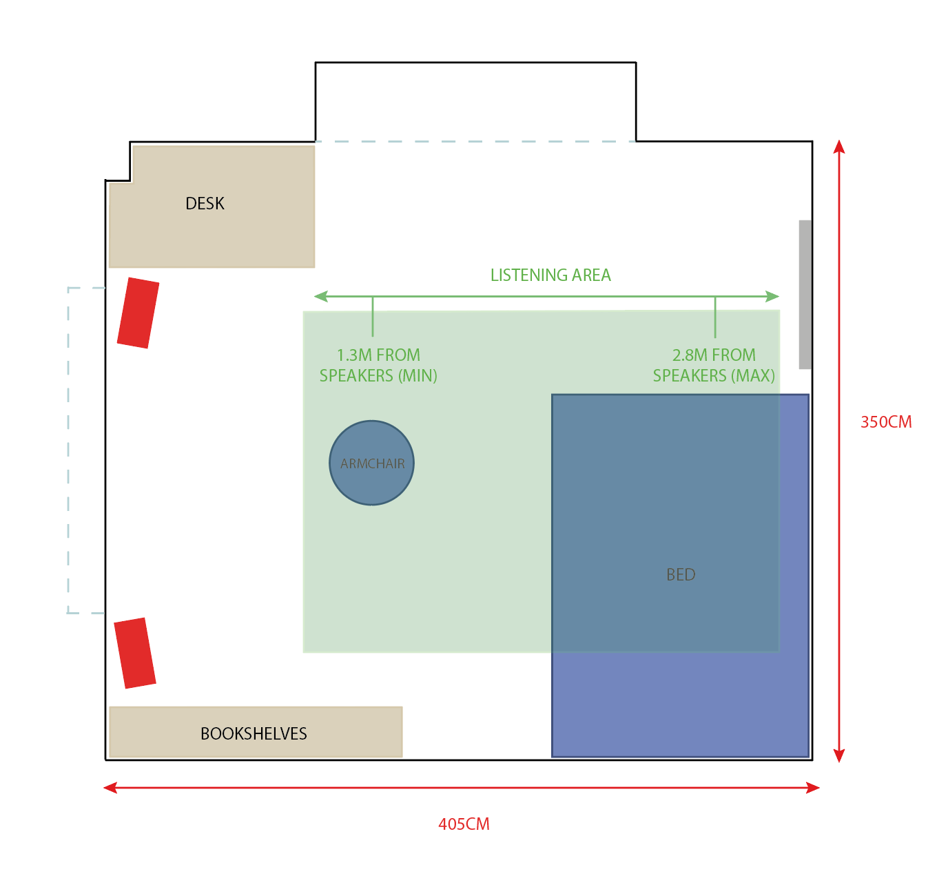

Here is a plan of my room with hypothetical speaker placement and listening area.
The (hypothetical) speaker placement is represented by the two, toed in red rectangles. As you can see, they would need to be placed fairly close to a wall, I guess that's something that should influence the design I end up picking.

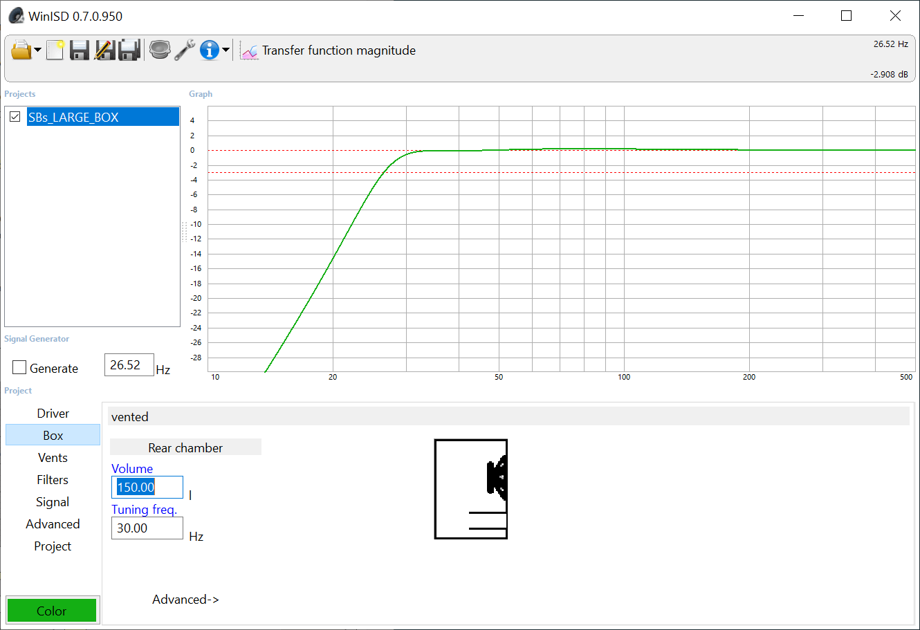

I've been playing around in WinISD, and this what I get with a 150L vented box tuned to 30Hz.
F3 at 26.5Hz which looks great on paper. Then again, I have absolutely zero idea what I'm doing and how this translates to an actual enclosure.

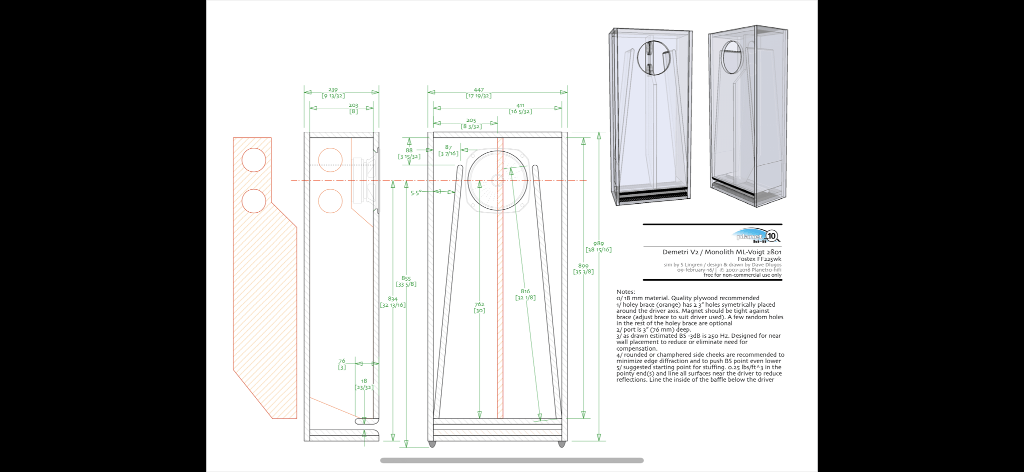

Thanks! As I said, I read this thread and other ones related to the driver several times, but it doesn't answer my questions...
1) Can I build an enclosure that is wider than it is deep? Kind of like the Altec shown above. (I don't like tall and deep towers at all)
2) Does the fact that the speakers will be close to a wall change anything about my design?
Can I do a MLTL in a wide box to maximize bass extension?

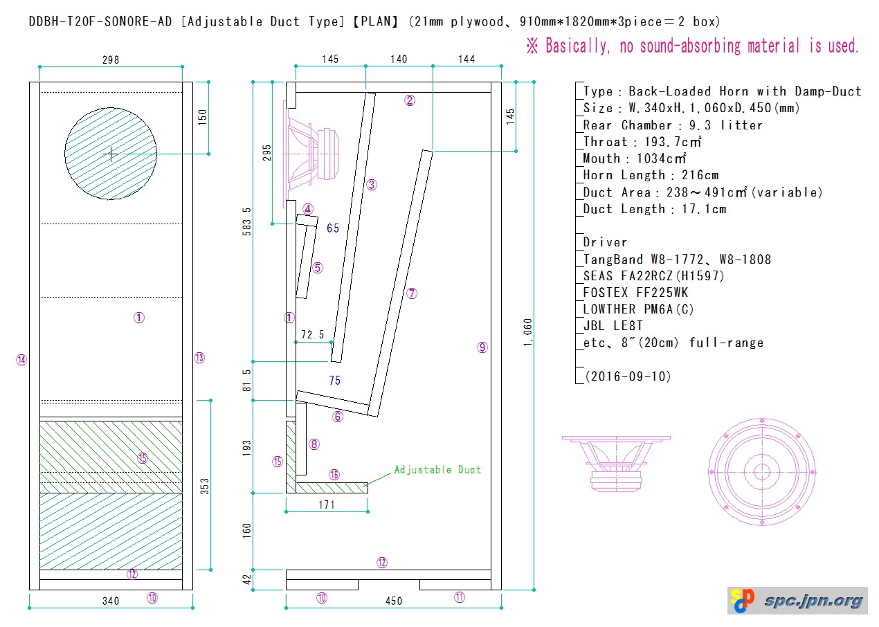

Something closer to looking like this:

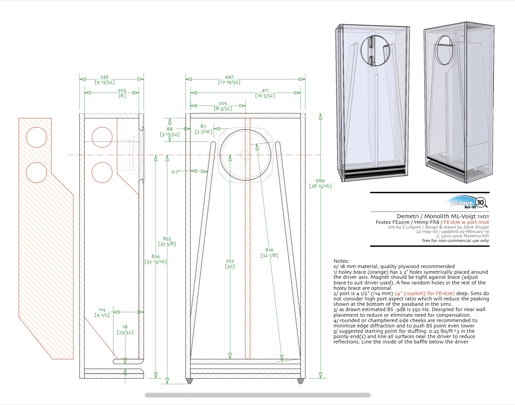

Sure
Poplar (in the growing Hardwood Series) is specifically designed for wall placement. Note: some have dimensions suitable for sloped sides to furtehr enhabce integration with the wall.
You do have to pay attention to the alignment. The one you have shown will have WAY too much gain placed against a wall — it likely even has issues just putting it a room. You will need a much “droopier” alignment.
dave
dave

By alignment, he means the shape of the bass response. In a 'droopier 'alignment, the response will 'droop' at the low end, so there will be less low bass.
I think a 150 litre ported box is probably too big, especially with near-wall placement. For ported, you might be better with something more like the 60 litres suggested above.

Here is the whole cover page. Designs done for Pluvia 11, Alpair 10.3 (and a Twin A10.3), P7HD and maybe A7ms in the pipe). A10 version supports angled sides. Email me of Scott about obtaining the paid planset.
http://wodendesign.com/planset/Poplar-A10x-MLTL-teaser.pdf
“Droppier" starts rolling off sooner, and slowly droops down to the lowest frequencies before final rolloff.
Even in the “normal” world F3 is a more or less meaningless number to the human ear/brain (ref Toole), one should be looking at F6 but here it should be F10 or if lots of room gain maybe even less. ie over damped alignment.
dave

The Woden design for the Pluvia 11, Alpair 10.3, etc... will NOT be a drop in for the SB20.
As long as CSA is kept the same, and the line length is also the same, it matters less the shape of the enclosure, being wider of narrower. Yes, the width of the baffle will affect the frequency response (baffle step), which may be ok or bad according to the driver's own response, but you say you will have EQ to tame the peaks, so it will be easy.
The lack of depth means the bounce back wave might interfere a bit, so either add some foam like the white magic eraser kitchen sponges or some internal diffuser.
for the SB20.
SB20 would require its own design, i posted these for inspiration. The broad strokes can be used, it will need its own height, cross-section, Zd and the details of the mass-loading.

Planet10's advice is worth heeding. I think you'd find a 150 L box tuned that low will also severely limit the driver's power handling ability. WBCD will show that.

The wide baffle will lower the baffle step an octave compared to modern designs. Perhaps something like Heco Direct Einklang in design would work?
With those room dimentions the lowest room modes are at 42 Hz so tuning way below that is wasteful.

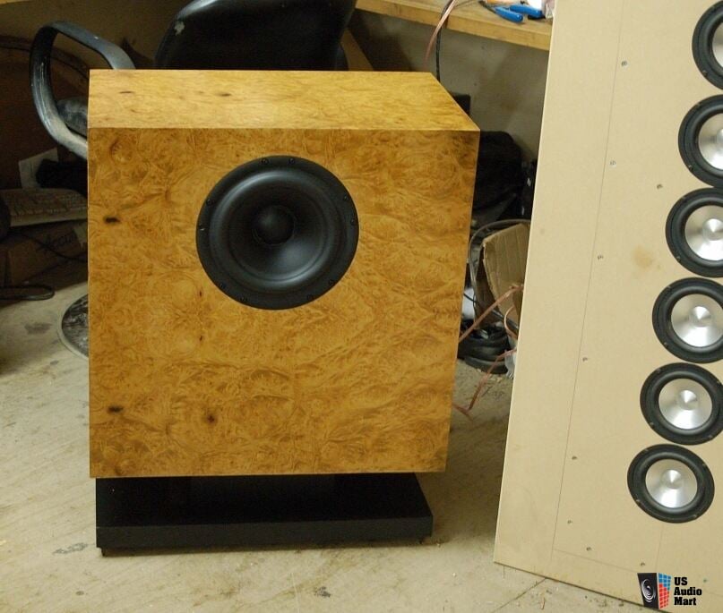

Thats cool looking cabinet at post #4, of course you can build it. Shallow and wide box placed against the wall basically gives infinite baffle (half space) radiation. There will be some bass boost by room boundaries and modes but in this case I think its ok taking into account your music taste and SB20FRPC30-8 rising HF response. So my recommendation is against "droopier” alignment.
prairieboy has a point about limited power handling, it wont be able to play very loud at lowest frequencies.
FYI/FWIW, an Altec/pioneer's 'classic' alignment is Vb = Vas/1.44, Fb = Fs, so a bit under damped with this driver, though the pioneer's solution was to 'critically' dampen the box internally and/or the vent if they felt the need to 'tone down' its midbass response once at the desired in room placement.1) Can I build an enclosure that is wider than it is deep? Kind of like the Altec shown above. (I don't like tall and deep towers at all)
